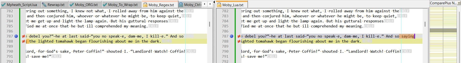

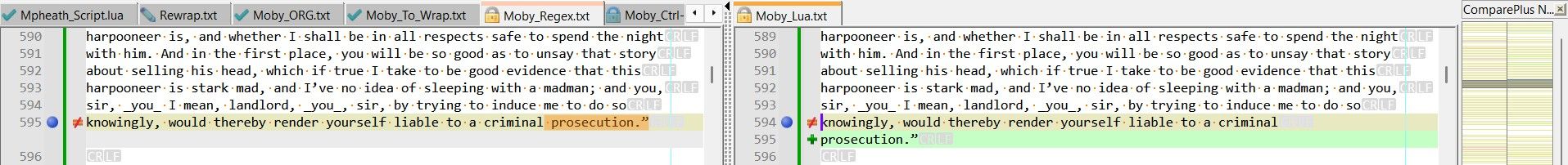

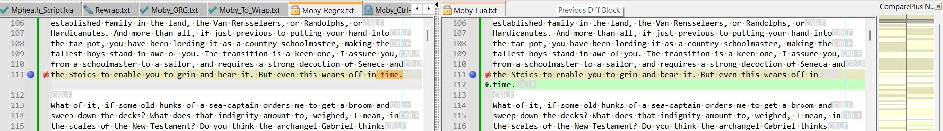

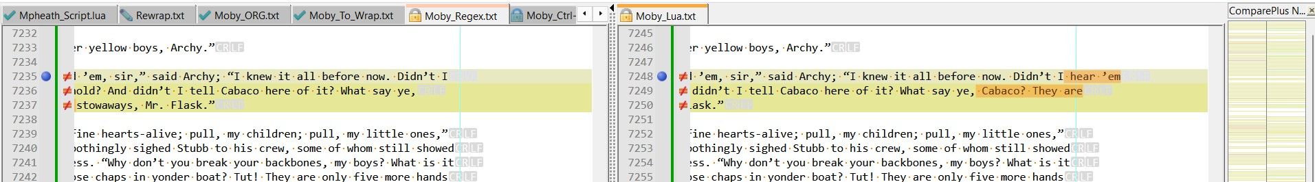

                  Regex process :
                  Lua process :
                  However, the comparisons between the regex process and the Lua process shows the same number of differences ( 3 for ANSI files and 5 for UTF-8 files )
                  • Between ANSI files :
                  • Between UTF-8 files
                  mpheathM 1 Reply Last reply Reply Quote 1

                      Upon comparison, it turns out that these three files are completely different ! Compared to the Moby_Regex.txt file , I noticed that your Moby_Lua.txt sometimes grasps :
                      More than it should, as, for example, in the lines :
                      “Who-e debel you?”—he at last said—“you no speak-e, dam-me, I kill-e.” And so saying with a wrapping after 84 chars
                      “Oh, I don’t mind ’em, sir,” said Archy; “I knew it all before now. Didn’t I hear ’em with a wrapping after 85 chars
                      Less than it should, as, for example, in lines :
                      • the Stoics to enable you to grin and bear it. But even this wears off in, with a wrapping after 72 chars
                      • knowingly, would thereby render yourself liable to a criminal, with a wrapping after 61 chars
