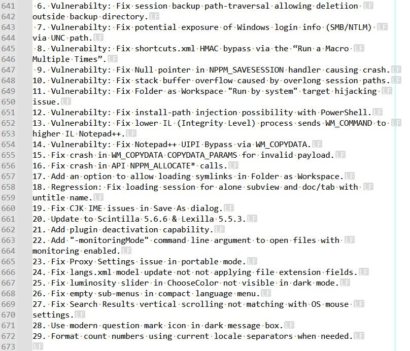

      So, I imagined this new regex replacement, below :
      SEARCH (?-s)^(.{1,C})(?:[\x20\r\n]*\z|\x20*\R|\x20+) ( with C = 78 in our case )
      REPLACE \1\r\n if Windows file   \1\n if Unix file   \1\r if Mac file
      Finally, run an Edit > Blank Operations > Trim Trailing Space operation ( or SEARCH \x20+$ and REPLACE with Nothing )

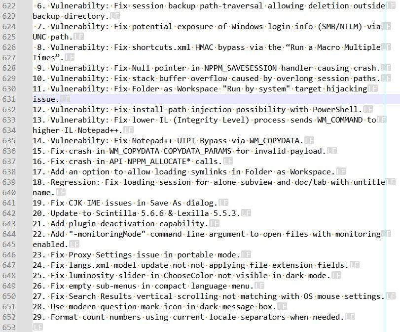

      And indeed, the New_LF_ANSI.txt file better respects the 78 limit than the Old_LF_ANSI.txt , as shown below :
      BEFORE :
      And
      AFTER :
      And
      I also created a New_CRLF_UTF-8.txt file, using the last (?-s)^(.{1,78})(?:[\x20\r\n]*\z|\x20*\R|\x20+) regex and the only differences with the New_LF_ANSI.txt file are :
      Because the two chars “ and ” are coded with one byte ( 93 and 94 ) in the ANSI text and coded with three bytes ( E2 80 9C and E2 80 9D ) in the UTF-8 text

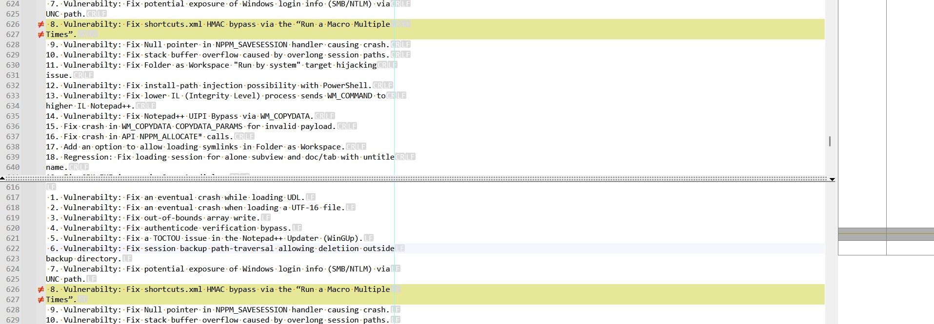

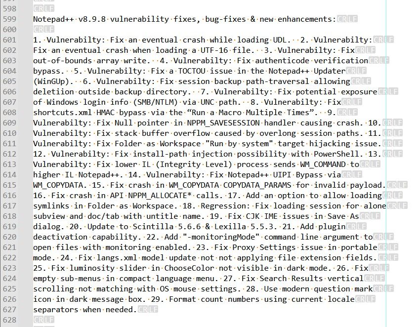

      Now, the wrapping process of both the TextFX plugin and the Python script are quite different : Here is, successively, a screenshot from the TextFX_ANSI.txt file and from the PythonCRLF_UTF-8.txt file :
      You can see, in the change.log section, that lines regarding, obviously, different points are badly concatened in a single line !

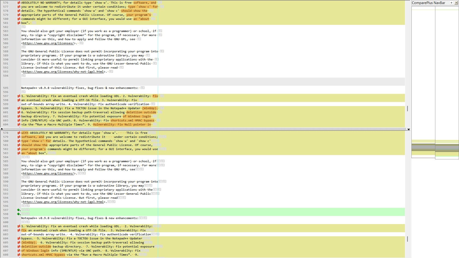

      Now, if I compare these two files, ignoring all spaces and line-endings, ComparePlus v3.00 returns the picture, below, with differences mostly at end of the license.txt section and in the change.log section !

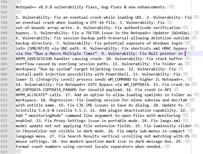

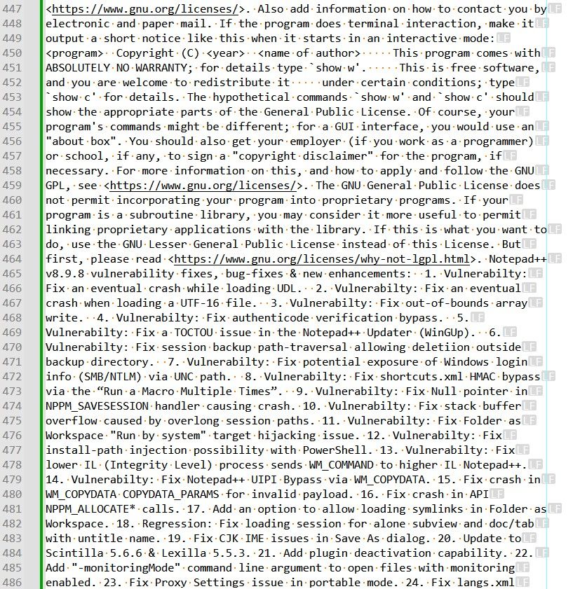

      Finally, I created the NEW_LF_ANSI_Strict.txt file :
      • I did, first, an Edit > Line Operations > Join Lines operation which changed all text in a very long line ( 37,410 chars )
      • Then, I applied the following regex replacement against this file
        • SEARCH (?-s)^(.{1,78})(?:[\x20\r\n]*\z|\x20*\R|\x20+)
        • REPLACE \1\n

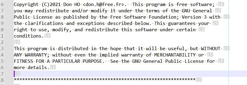

      Here is a screenshot of the resulting file, showing the end of the license.txt section and the beginning of the change.log section
      As you can verify, the reading of this text is rather painful :-((

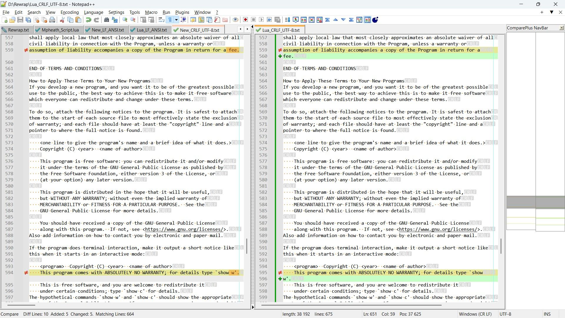

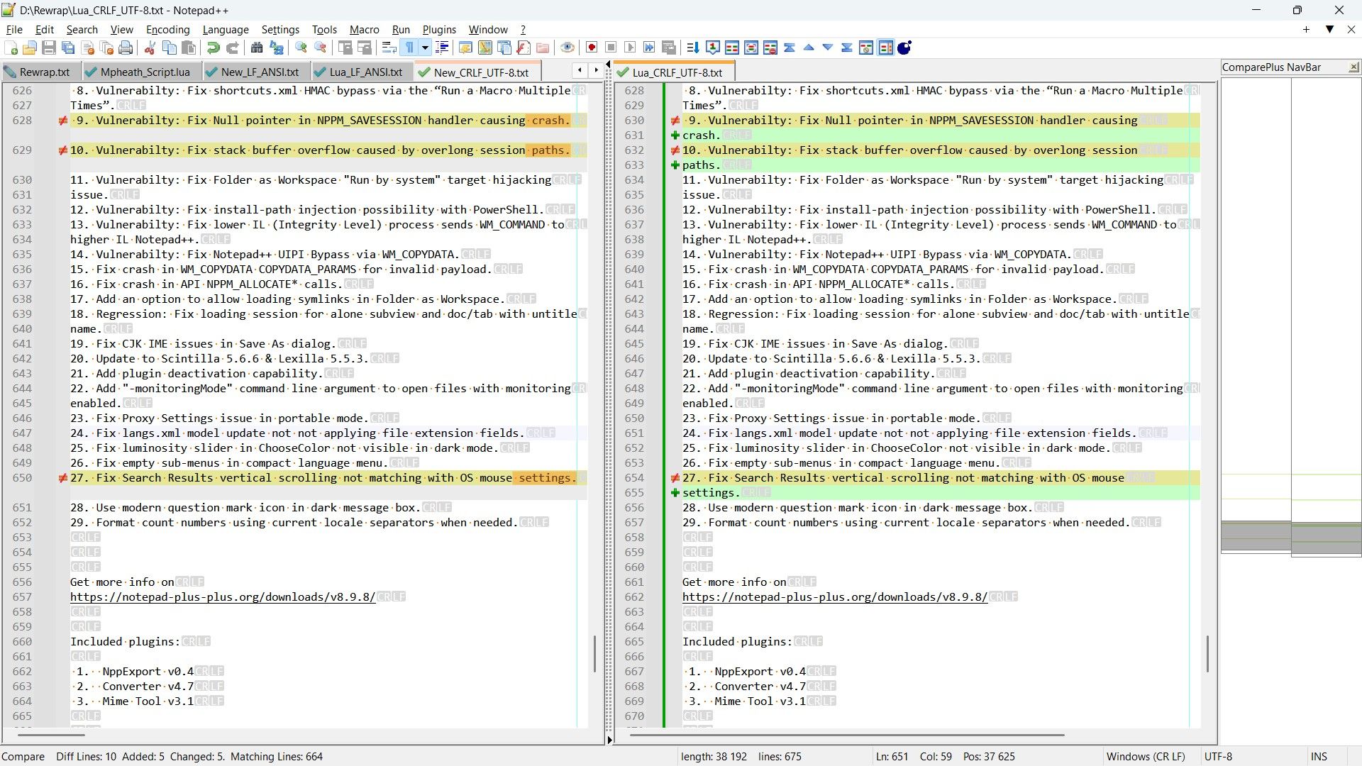

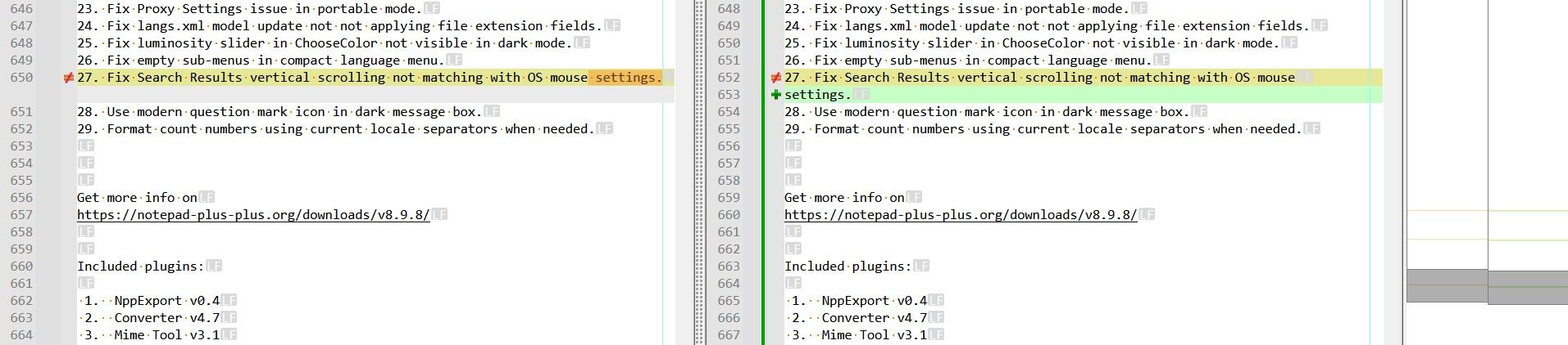

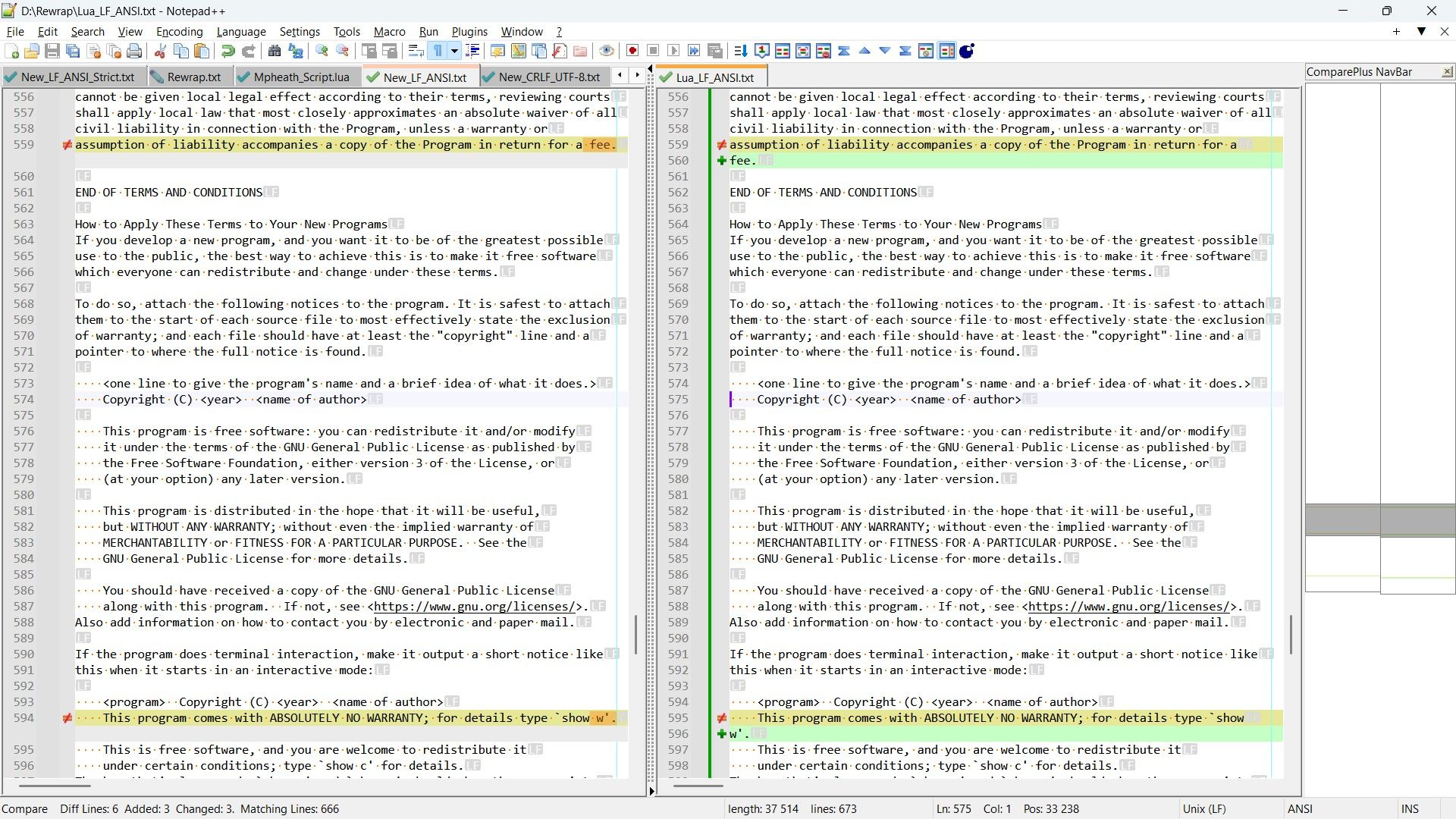

              @mpheath, I first copied the ORG_LF_ANSI.txt file as Lua_LF_ANSI.txt then I ran your last lua script against this file and the files are almost identical, except in the 3 locations below :
              Then I copied again the ORG_LF_ANSI.txt file as Lua_CRLF_UTF-8.txt then I ran your last lua script against this file. This time, there are 5 differences, shown below :
              Thus, as a conclusion, your Lua script is quite correct but the last regex solution :
              REPLACE \1\n ( for Unix files ) or \1\r\n ( for Windows files )
              Followed with a Trim Trailing Space operation, seems slightly better !
