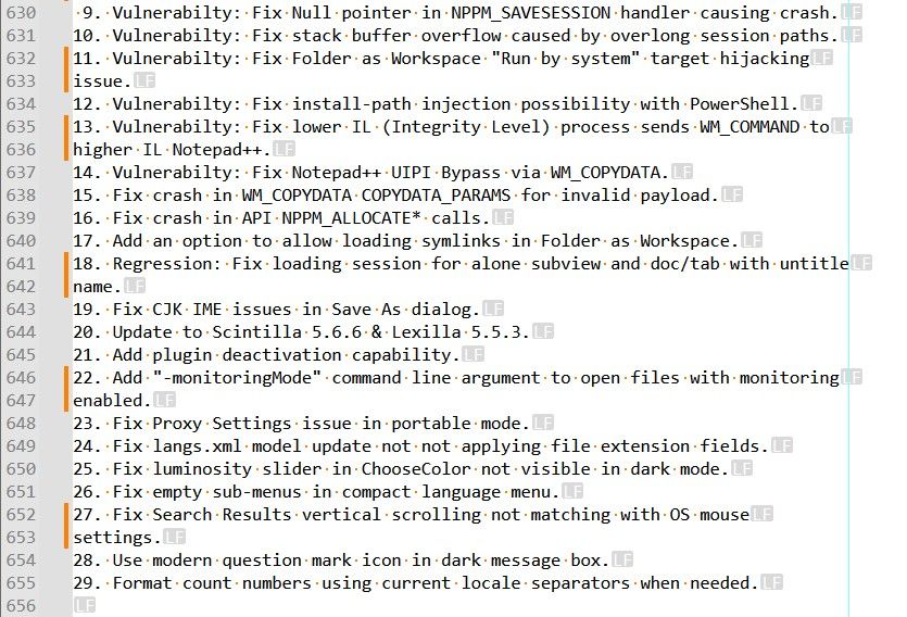

      Now, the wrapping process of both the TextFX plugin and the Python script are quite different : Here is, successively, a screenshot from the TextFX_ANSI.txt file and from the PythonCRLF_UTF-8.txt file :
      You can see, in the change.log section, that lines regarding, obviously, different points are badly concatened in a single line !

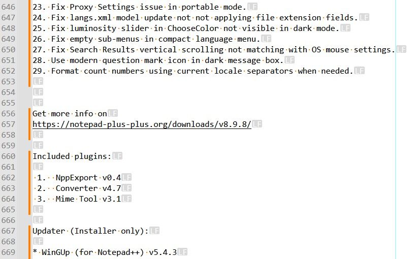

      Here is a screenshot of the resulting file, showing the end of the license.txt section and the beginning of the change.log section
      As you can verify, the reading of this text is rather painful :-((

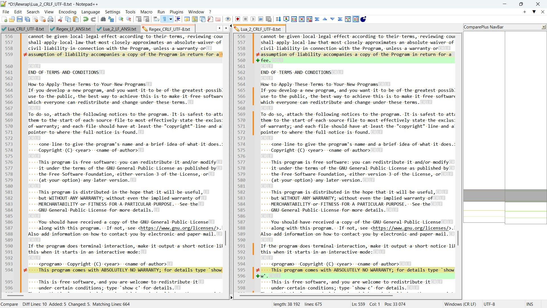

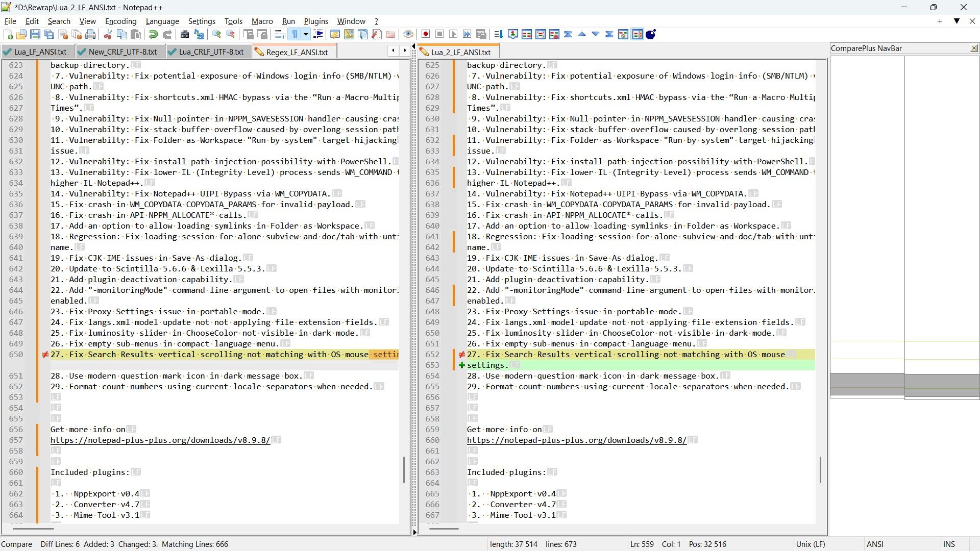

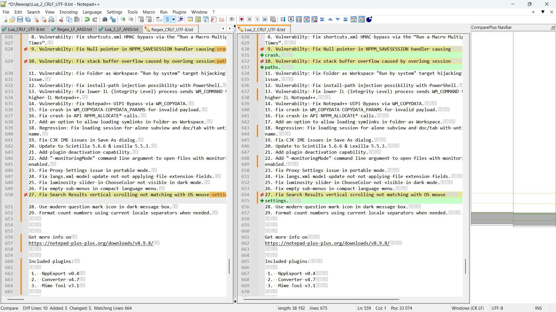

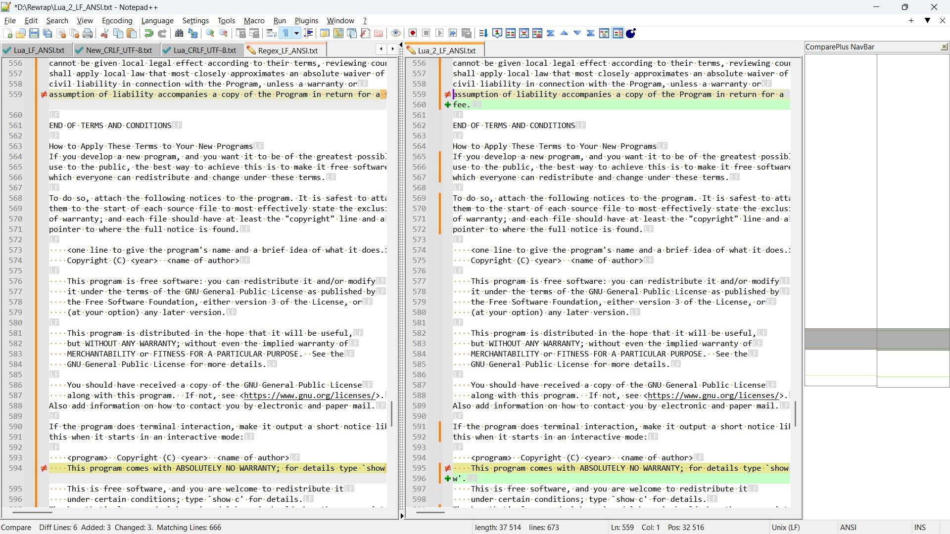

                  Ah… I understand. Thus, I’ve decided to conduct a second round of tests. This time :
                  • The files New_LF_ANSI.txt and New_CRLF_UTF-8.txt were copied from ORG_LF_ANSI.txt as Regex_LF_ANSI.txt and Regex_CRLF_UTF-8.txt
                  • The files Lua_LF_ANSI.txt and Lua_CRLF_UTF-8.txt were copied from ORG_LF_ANSI.txt as Lua_2_LF_ANSI.txt and Lua_2_CRLF_UTF-8.txt
                  Then, I stopped and restarted N++ : thus, no more change history feature !
                  Finally, regarding these new created files :
                  • I ran the regex replacement, followed by a Trim trailing Space operation, on files Regex_LF_ANSI.txt and Regex_CRLF_UTF-8.txt
                  • I ran your Lua script on files Lua_2_LF_ANSI.txt and Lua_2_CRLF_UTF-8.txt
                  So, these four files showed an orange change history color. As you can see on the screenshots, the regex process acted on all lines, but some empty line endings, and your lua script just acted on lines which need wrapping !
                  Regex process :
                  Lua process :
                  However, the comparisons between the regex process and the Lua process shows the same number of differences ( 3 for ANSI files and 5 for UTF-8 files )
                  • Between ANSI files :
                  • Between UTF-8 files
