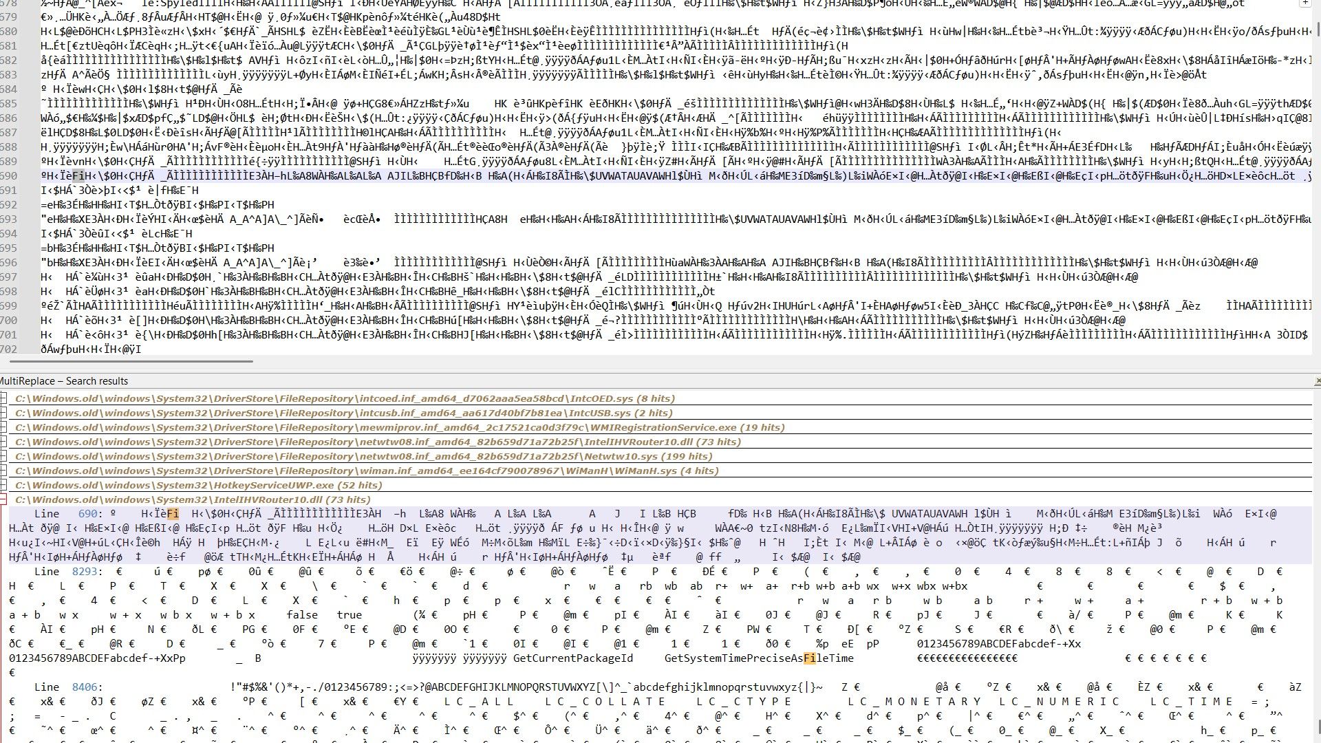

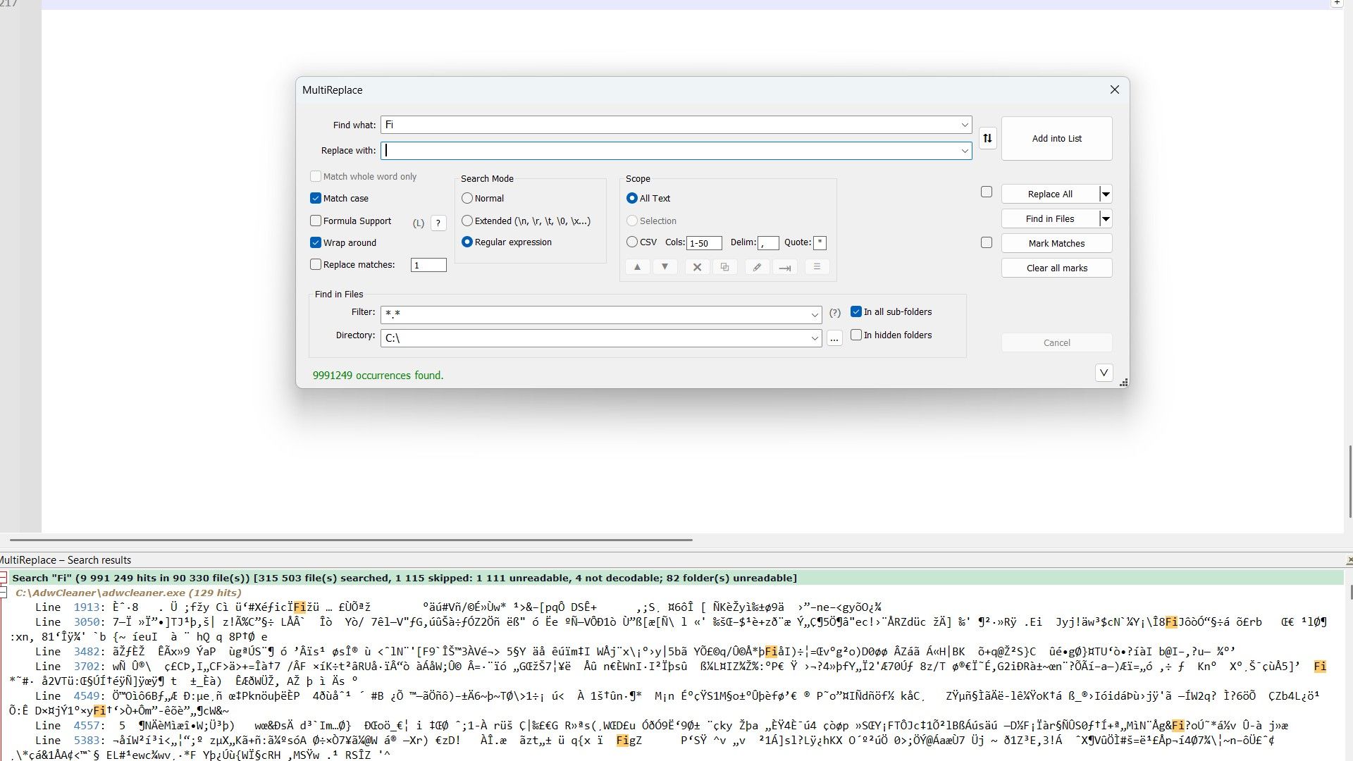

                      • guy038G Offline
                        Hello, @thomas-knoefel, @vitalii-dovgan, @coises and All,
                        @thomas-knoefel, I tested your last release and I’m pleased to confirm that no errors ocurred anymore during all the tests ! I followed the same protocol, that I described in my initial post.
                        Here are the results when scanning all the files of my SSD Drive C:\ :
                        |    Program     |                        Results                                             |  Scan Phase  |  Search End  |  Results panel  |                                   Details                                    |
                        |  MultiReplace  |  Search "Fi" (9 991 249 hits in 90 330 file(s)) [315 503 file(s) searched  |    5 m 56 s  |   48 m 15 s  |      48 m 27 s  |  1 115 skipped: 1 111 unreadable, 4 not decodable; 82 folder(s) unreadable]  |
                        But the nice thing is that your Search results panel was correctly displayed and functional :
                        Starting with the default Unfoll All option, I got these successive results :
                        |        Action          |   Time   |
                        |  Collapse to File List |   32 s   |
                        |  Fold All              |   24 s   |
                        |  Unfold All            |   0,8 s  |
                        |  Fold All              |  32,5 s  |
                        On the other hand, I went to the last file of the list, opened it and double_clicked on the first occurrence, in line 690. At once, the corresponding file was displayed in N++ with the caret on this first occurrence, in line 690 !

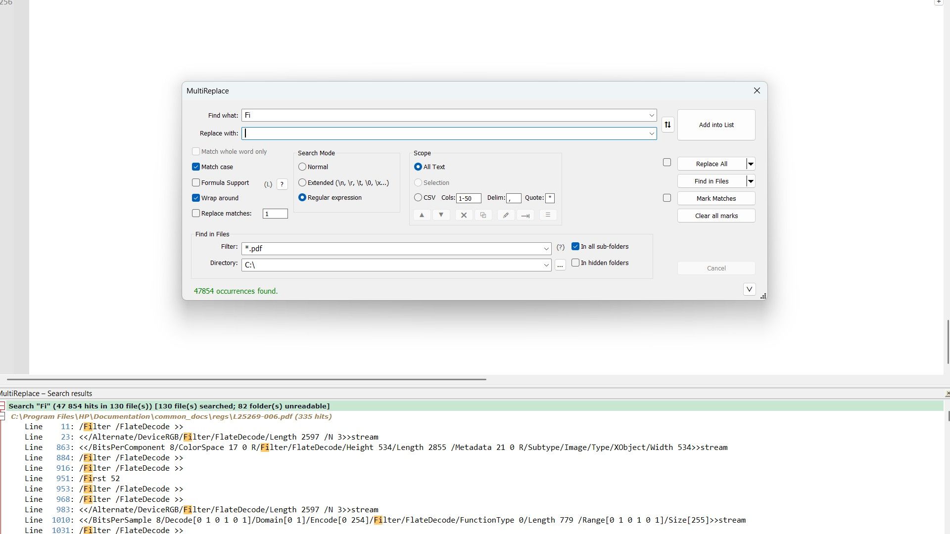

                        Now, here are the results when scanning all PDF files of my SSD drive C:\
                        |  MultiReplace  |  Search "Fi" (47 854 hits in 130 file(s)) [130 file(s) searched  |    5 m 45 s  |    5 m 48 s  |       5 m 48 s  |  ; 82 folder(s) unreadable]  |
                        Note that you find the same results as with the other Search programs, in my initial post : that’s quite reassuring !
