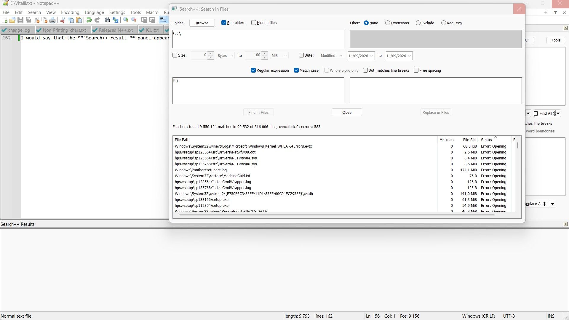

                    I re-ran my previous search on any file of my SSD drive C: with Search++ :
                    • 2 m 26 s after the beginning, the scanning phase was over and the file list began to fill up
                    • 10 m 01 s later, the waiting files number was about equal to the finished files number !
                    • 3 m 28 s later, the files list was completed
                    • 10 s later, the Search++ Results panel was displayed, as shown in the snapshot below :
                    • Note that, in this first snapshot, the docked Search++ dialog and the Search in Files dialog seem to be already inaccessible !

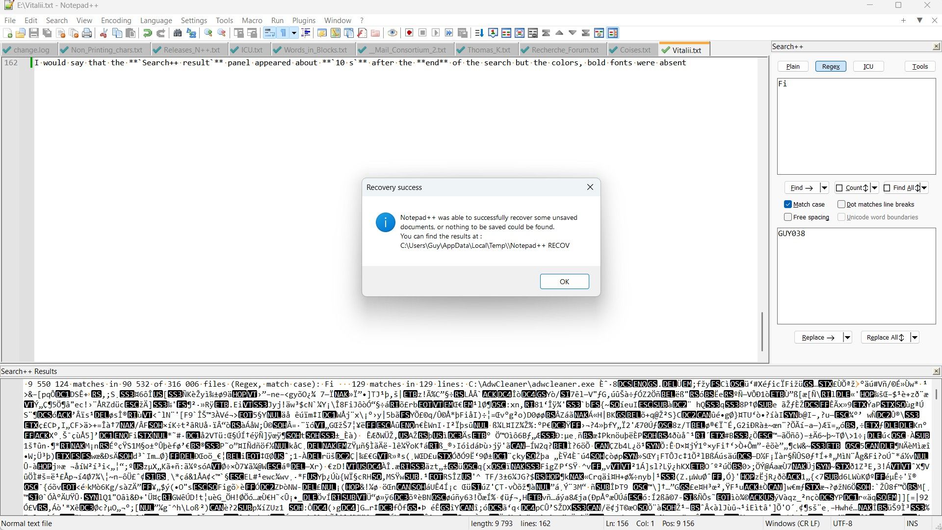

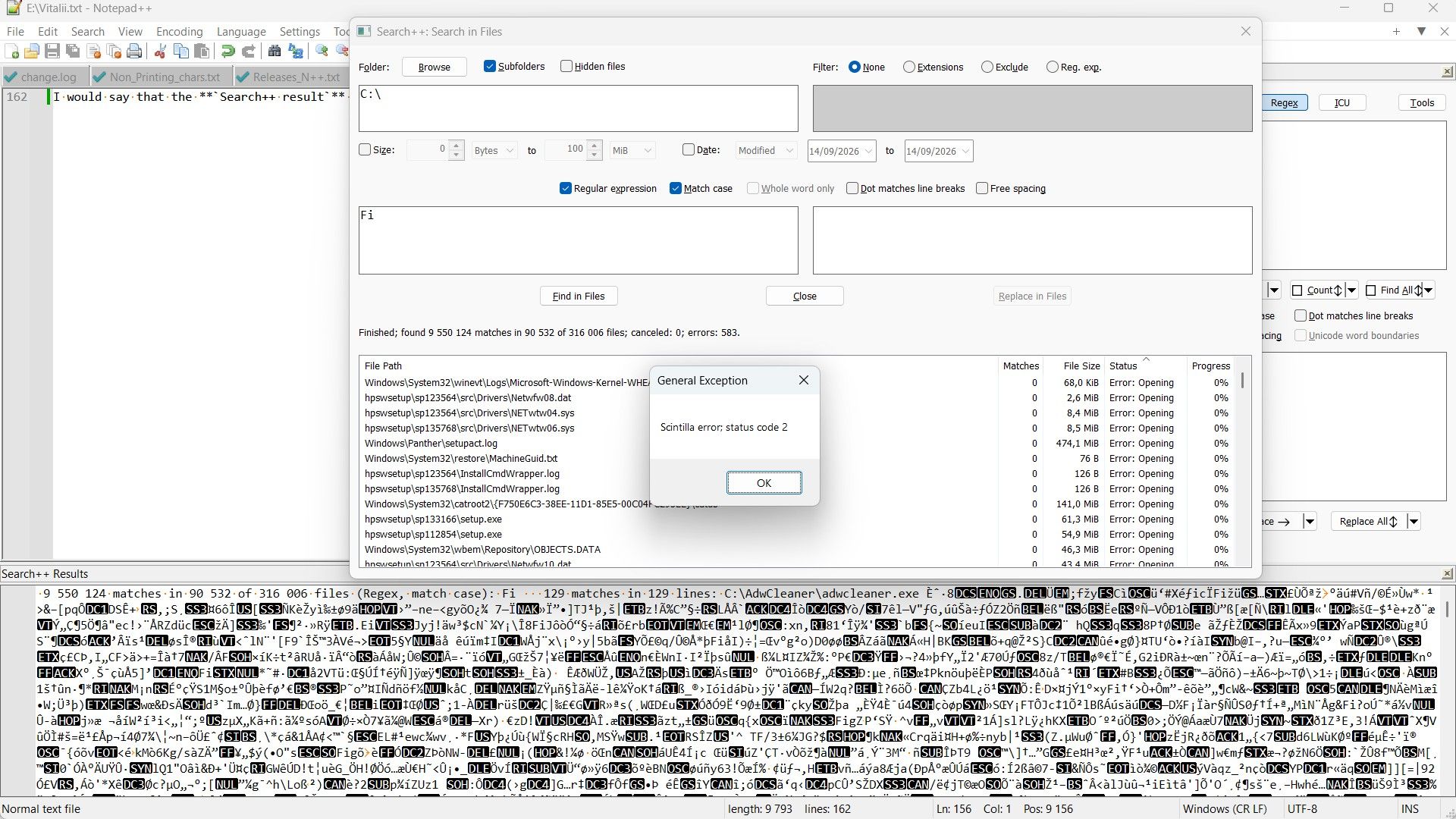

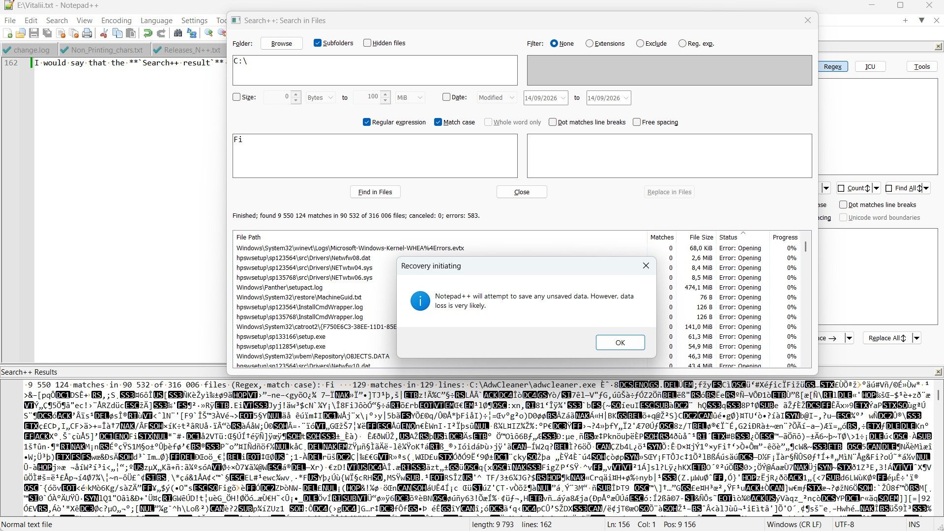

                    • Then, I saw, in the N++ title, that the program did not respond anymore. Then, trying to stop Notepad++, I choose the answer Wait till the program responds
                    • I then saw, this snapshot :
                    • Clicking twice, on the OK button, I got, successively, these two snapshots :
                    • Finally, after clicking OK in this last dialog box, it has disappeared.
                    • Unfortunately, clicking again on the Search++ results, closed N++ completely

                      Scintilla error: status code 2
                      Thank you for the explanation and screen shots. Scintilla status code 2 means “Memory is exhausted” — so just as you suggested, the results list was simply too big for Scintilla to handle on your machine.
                      This is still a good point to bring up: it means I should at least experiment and see if I can catch that error before it propagates to killing Notepad++. It might not be possible, but I won’t know until I try.
