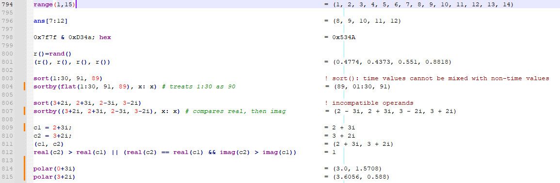

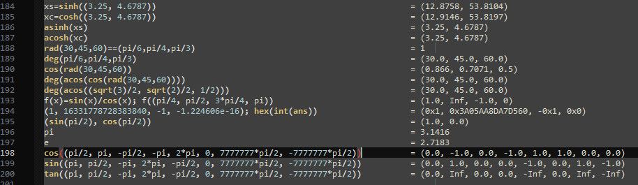

      Hi, I’m new to the Notepad++ community.
      I’d like to share a plugin with you that I made not long ago.
      Smart Math
      Real-time mathematical evaluation plugin for Notepad++ using EOL annotations. Supports variables, percentages, and persistent tab settings. Written in FreeBASIC.
      I think it’s pretty simple but also quite useful :)
      It would be great if the plugin showed up in the plugins manager list, but I’m a bit lazy and haven’t got a clue, so I’m just going to share it here.
      GitHub repository: https://github.com/c-sanchez/npp-smart-math/
      Thread on the FreeBASIC forum: https://www.freebasic.net/forum/viewtopic.php?t=33519

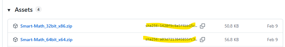

        • it’s just a PR to the nppPluginList project. Since you’re working in GitHub already, I assume you know how to do the PR
        • fork the nppPluginList repo, create your own branch
        • in that branch, edit pl.x64.json to link to the 64-bit version, and pl.x86.json to link to the 32-bit version
        • the id required in the JSON is just the SHA256 hash, which GitHub provides for you:
        • once you have edited both files in your branch, submit the PR from that branch
