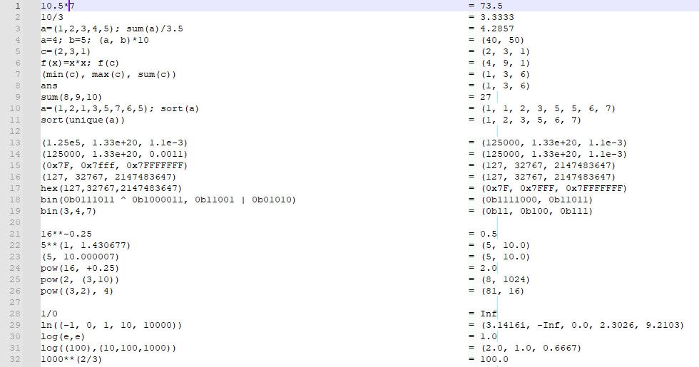

            A small example of what is already working:
            This demonstrates just several functions; the other functions from USAGE_AND_SYNTAX work as well.
            The next step is to:
            1. Create a syntax file to apply “function color” to built-in functions;
            2. Apply this syntax file automatically when Smart Math is enabled for the current file/document.
            The syntax file can be created by means of user-defined language.
            But how to apply this user-defined language automatically when Smart Math is enabled for the current file/document?
