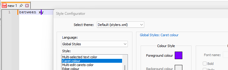

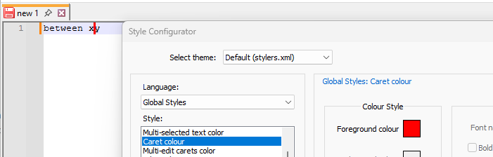

        also cant change cursor color, I am trying to change it in style configurator global styles -> caret color, doesnt work, theme is set to default, I have an own defined languge styler, but I dont find it in the language list in case it should be changed there. cursor is black.
        It works for me, in both v8.9.1 and v8.9.2.
        If you have done a multi-select (ctrl+click) to have multiple carets, then you also have to use Multi-Edits Colour, otherwise, they will be separate colors, as in:

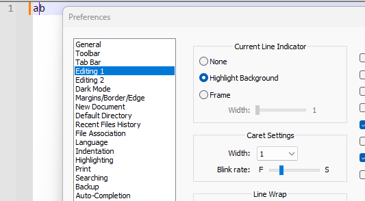

        update: also, what are your Settings > Preferences > Editing 1 > Caret settings? Because with width=1, it’s really hard to see, and you just might not notice the change in color. For my screenshots above, I was using width=3 and super-slow blink rate, so that the screenshot would easily show the change in color. But by default, Caret settings look more like this :
