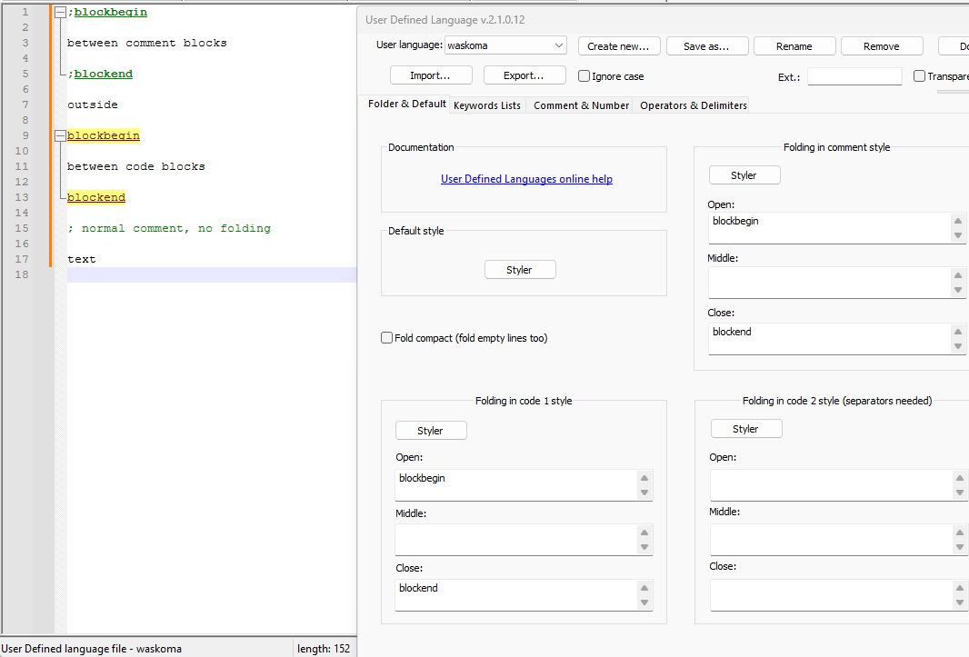

              WIth example text
              ;blockbegin
              between comment blocks
              ;blockend
              outside
              blockbegin
              between code blocks
              blockend
              ; normal comment, no folding
              text
              1. Folding in Code 1 Style:
                • Styler = deep red foreground, pale yellow background; underline
                • Open = blockbegin
                • Close = blockend
              2. Folding in Comment Style:
                • Styler = green foreground, bold, underline
                • Open = blockbegin
                • Close = blockend

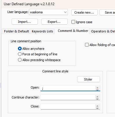

              3. Comment & Number tab > Comment line style:
                • Styler = green
                • Open = ;

                  As my followon post suggested, I think that what you really want is “folding in comment”, not “folding in code 1”. That would allow you to syntax-highlight a normal comment and allow the blockbegin/blockend inside your comment to cause folding… the best of both worlds.

                    @PeterJones oh sorry, now I understand. can you send me a screenshot on how you achieved that:? I am unable to replicate it
                    • waskomaW
                      waskoma @PeterJones
                      @PeterJones ok sorry, and thank you for your patience, you have explained exactly what to do, and I’ve failed to understand, I’ve got the flu and my brain doesnt operate normally :D

                            It still works for me in v8.9.2, using the same color descriptions as I used three years ago:
