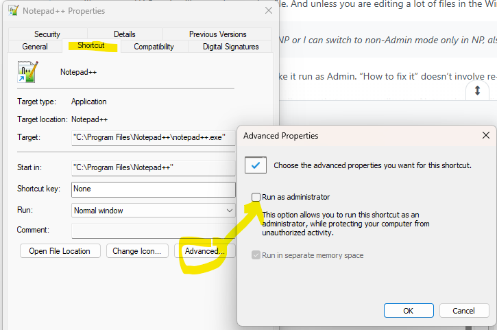

                    You actually had to do something special to make it run as Admin. “How to fix it” doesn’t involve re-installing, though it might involve changing one or more shortcuts:
                    • If you have the N++ icon pinned to your toolbar, so that you normally start Notepad++ by clicking its icon on the same bar as the start menu and where the running programs are shown, you can right click on the icon, then right click on Notepad++ in that menu, then choose Properties, which will allow you to edit that shortcut’s properties. Click on Advanced… , and if Run as Administrator is checkmarked, uncheckmark it, then OK a couple times to get it to save.

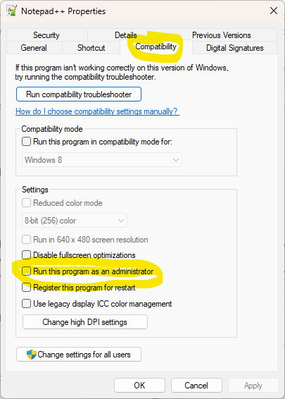

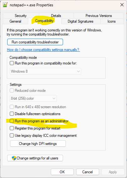

                    update: Ahh, if you go to the Notepad++ directory and right-click Properties on the notepad++.exe itself, it’s on the Compatibility tab of the dialog; and you can actually find the checkbox there for the shortcuts, too, instead of going to the Advanced… button.
                    exe properties > compatibility:
                    shortcut properties > advanced:
                    shorcut properties > compatibility:
