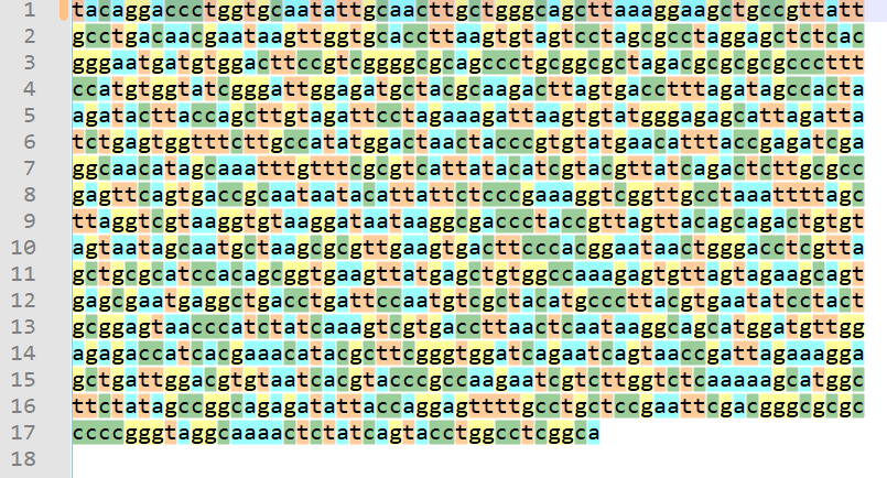

              Hello, @n-iels, @peterjones and All,
              Edited 2019-11-21 : Sorry, @n-iels, as I’m French, I used the wrong term ADN, instead of DNA !
              Of course the Peter’s solution, using @ekopalypse Python code, is quite robust but, may be, this macro, below, could help you to study your ADN sequences ;-)). Roughly, this macro :
              • First, execute the command Search > Unmark All > Clear All Styles
              • Then, write the ATGC upper-cased string, at beginning of the current line
              • Mark, successively the 4 letters A , T, G and C with, respectively, the styles 1, 2, 3, and 5
              • Re-select the ATGC string, at beginning of current line
              • Delete the ATGC string, leaving the contents of current line untouched !
              => As a result, all the ADN sequences of the current file should be highlighted, with the 4 different styles ;-))
              So :
              • Start Notepad++
              • Open the shortcuts.xml configuration file, generally located in %AppData%\Roaming\Notepad++ for an installed N++ version or in the same folder than the Notepad++.exe file, in case of a local installation with a zip or 7z package
              • Insert the code, below, in the <Macros>......</Macros section of shortcuts.xml
                      <Macro name="ADN Test" Ctrl="no" Alt="no" Shift="no" Key="0">
                          <Action type="2" message="0"    wParam="43032" lParam="0" sParam=""  />   <!--  DELETE ALL styles        -->
                          <Action type="0" message="2453" wParam="0"     lParam="0" sParam=""  />   <!--  Go to START of line      -->
                          <Action type="1" message="2170" wParam="0"     lParam="0" sParam="A" />   <!--  Write the letter A       -->
                          <Action type="1" message="2170" wParam="0"     lParam="0" sParam="T" />   <!--  Write the letter T       -->
                          <Action type="1" message="2170" wParam="0"     lParam="0" sParam="G" />   <!--  Write the letter G       -->
                          <Action type="1" message="2170" wParam="0"     lParam="0" sParam="C" />   <!--  Write the letter C       -->
                          <Action type="0" message="2307" wParam="0"     lParam="0" sParam=""  />   <!--  Select the NEXT char     -->
                          <Action type="2" message="0"    wParam="43022" lParam="0" sParam=""  />   <!--  Apply the 1st STYLE      -->
                          <Action type="0" message="2306" wParam="0"     lParam="0" sParam=""  />   <!--  Hit the RIGHT key        -->
                          <Action type="2" message="0"    wParam="43024" lParam="0" sParam=""  />   <!--  Apply the 2nd STYLE      -->
                          <Action type="2" message="0"    wParam="43026" lParam="0" sParam=""  />   <!--  Apply the 3rd STYLE      -->
                          <Action type="2" message="0"    wParam="43030" lParam="0" sParam=""  />   <!--  Apply the 5th STYLE      -->
                          <Action type="0" message="2454" wParam="0"     lParam="0" sParam=""  />   <!--  Select to START of line  -->
                          <Action type="0" message="2180" wParam="0"     lParam="0" sParam=""  />   <!--  Hit on the DELETE key    -->
                      </Macro>
              • Then save the modifications ( Ctrl + S ) and close shortcuts.xml ( Ctrl + W )
              • Now, stop and re-start N++
              • Open any file containing some ADN sequences
              • If some ADN sequences contained lower-cased letters :
                • Open the Find dialog, with Search > Find... ( Ctrl + F )
                • Untick, if necessary, the Match case option
                • Hit the ESC key to close the Find dialog
              • Execute this macro, running the command Macro > ADN Test, which should be visible, along with your present macros, if any ( You may assign a shortcut, as well )
              Et voilà ;-))

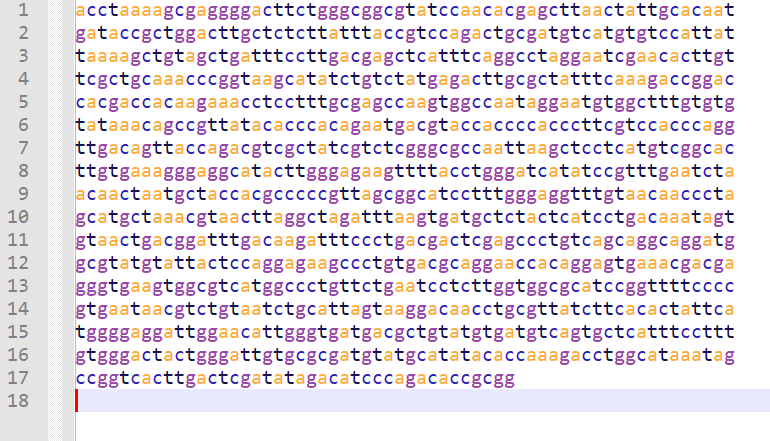

                @guy038 always tries out my proposed solutions to problems, so this time I tried @guy038 's solution and it works nicely. First I obtained some data to try it on from here. Then, executing the macro on the data resulted in this nicely visual view:
                Perhaps the only note to make is that, upon any future change to shortcuts.xml that is made automatically by Notepad++, will cause @guy038 's nice comments on each line of the macro to be removed! :-(
                  To give @Ekopalypse fair time as well, I decided to try the lexing script.
                  Here’s what I did:
                  • Create a barebones UDL called ADNTest. I changed/added nothing, just saved an “empty” definition.
                  • Get the latest version I could ascertain of the EnhanceUDLLexer.py file. [Sadly, the thread linked to (above by Peter) for this starts out with I opened this thread just to inform you that I have reworked the script a little bit. Such an opening is begging for a link to an original discussion thread!]
                  • Modify that file as follows:
                  1. lexer_name = 'ADNTest'
                  2. Comment out existing regexes variable settings (from the Examples section) and add in the following ones (using some “random” color numbers):
                  regexes[(0, (252, 173, 67))] = (r'a', 0)
                  regexes[(1, (152, 73, 167))] = (r'g', 0)
                  regexes[(2, (52, 37, 176))] = (r'c', 0)
                  regexes[(3, (25, 17, 77))] = (r't', 0)
                  • Run the script.
                  • Generate some random DNA data from the link provided earlier by me into a new Notepad++ tab.
                  • Change the Language of the tab to be my ADNTest UDL.
                  It worked nicely, giving me this view of the data:
                  Overall, perhaps I give the nod to @guy038’s solution because it is a lot simpler for someone to use that isn’t already using Pythonscript.
                    Note: I just picked up and used the term ADN from what @guy038 started, and I ran with it, without paying much attention. I think this really should have been DNA! Perhaps @guy038 is dyslexic – no, no, that can’t be…he’d never be a regex expert if that were the case. :-)

                        I finally gave in and actually tried using the script. It does work fairly easily, like you showed.
                        I confirmed with the following data that it is case sensitive.
                        gattaca
                        acctaaaagcgaggggacttctgggcggcgtatccaa
                        gataccgctggacctaaaagcgaggggacttctgggcggcgtatccaa
                        GATACCGCTGGACCTAAAAGCGAGGGGACTTCTGGGCGGCGTATCCAA
                        gataccgctgg
                        Thus,
                        regexes[(0, (252, 173, 67))] = (r'[Aa]', 0)
                        regexes[(1, (152, 73, 167))] = (r'[Gg]', 0)
                        regexes[(2, (52, 37, 176))] = (r'[Cc]', 0)
                        regexes[(3, (25, 17, 77))] = (r'[Tt]', 0)
                        will use Alan’s same colours, but allow lower case or upper case.
                        To make it automatic, I added the following to the startup.py (by Plugins > Python Script > Scripts, then Ctrl+Click on startup)
                        # to automatically import eko's EnhanceUDLLexer:
                        d = notepad.getPluginConfigDir() + '\\PythonScript\\scripts\\'
                        sys.path.append(d)
                        import EnhanceUDLLexer
                        EnhanceUDLLexer.EnhanceUDLLexer().main()
                        When you exit and reload Notepad++, DNA files should now automatically be colored.
                        However, as Alan said, @guy038’s macro is probably easier to use for someone who doesn’t already use PythonScript (or for anytime that Notepad++ updates break PythonScript notifications/callbacks).

                          Now, regarding the macro, I simply used the default N++ colors of the Mark styles. I just avoided the 4th style, which seems too dark purple, to my mind ! Of course, all these style colors can be changed in Settings > Style Configurator... > Global styles > Mark Style #1 to #5 ;-))

                                Thanks, you are amazing… I have now tried both solutions:
                                The Python script by @Ekopalypse works nicely, but has the following problems:
                                1. It slows Notepad++ down dramatically, to the point that working with a medium-size sequence file (500 k chars, mostly dashes) becomes impossible.
                                2. The script does not allow you to style the background. But background styling is what we usually want for this purpose.
                                3. Also, I noticed, that you cannot invoke the script twice (e.g. after changing colors).

                                As for the macro by @guy038:
                                1. It is much faster and actually makes editing the sequence file from above possible.
                                2. But on one of my computers, the A’s are not styled (I still have the standard colors set in the style configurator).
                                3. Understanding and editing the macro code is almost impossible and I could not find a useful macro documentation that is online (most links point to the now defunct npp wiki). It would be nice to have the same algorithm in Python Script…
                                4. The macro is not dynamic, i.e. after editing your sequences, you have to manually re-invoke that macro. Until then, your new sequence is styled wrong or not at all.
                                Both solutions allow me to finish my current project (thanks again!). But the preferable solution for non-hackers would be to make this a standard language (“Nucleotides”) after enhancing the UDL highlighter as discussed on the bug tracker: https://github.com/notepad-plus-plus/notepad-plus-plus/issues/7622.
                                EkopalypseE Alan KilbornA PeterJonesP 3 Replies Last reply Reply Quote 2
                                • EkopalypseE Offline
                                  Ekopalypse @N iels
                                  @N-iels
                                  Thank you very much for the testing and feedback of the test results.
                                  I’m afraid your use case reaches the limits of the script.
                                  Since the script only colors the current visual area, you seem to have very long lines with many hits, which leads to delays.
                                  The script is currently using, as you mentioned earlier, the
                                  textforeground indicator, this could be changed to get the same format as Guy’s solution.
                                  A restart of the script can be accomplished by deleting the class EnhanceUDLLexer via the PythonScript Console,
                                  with del EnhanceUDLLexer and another start.
                                  Can you tell me how much data you currently have, i.e. how long individual lines are in the visual area?
                                  I’d like to see if it’s possible to optimize the script, but I’m afraid, as I’ve said, this probably won’t do much good.
                                  But I understand, that a native support would be the preferred solution.
                                          I think the macro solution is a good one. While it would be possible to duplicate the functionality with Pythonscript, I don’t know that it is worth the effort, except maybe for instructional (how would one do it) purposes…hmmm…
                                            @Alan-Kilborn said in UDL syntax highlighting: non-delimited keywords (for nucleotide sequences):
                                            Beat you to it. :-)
