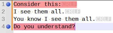

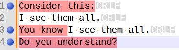

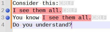

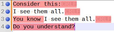

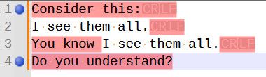

                Let me try to give an example of what I think is the problematic behavior. I agree that making users worry about whether or not to include line endings is not good.
                Copy this into a new tab:
                Consider this:
                I see them all.
                You know I see them all.
                Do you understand?
                Turn on display of line endings.
                Make sure there are only four lines: if copying added a trailing CRLF, remove that.
                Now, Mark using Regex with the following find text:
                I see.*$
                and Dot matches line breaks not checked.
                Now, observe what happens with each of these three seemingly reasonable sequences (after each, remove marks and bookmarks, and start fresh with a new Mark command):
                Invert Marked Text then Invert Bookmarks:
                Invert marked text then Bookmark only lines with marked text:
                Invert bookmarks then Mark only text in bookmarked lines:
                The result you probably would expect only comes from Invert marked text, excluding unmarked line endings, and sync bookmarks:
                I did this with line endings displayed so you can follow what is happening. Now go back and imagine how it looks to a user with line endings not displayed.
