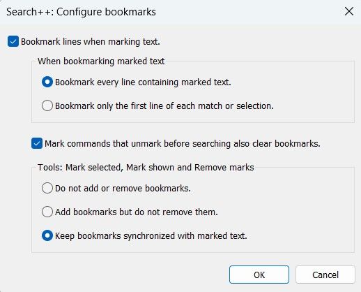

          Thus, I suggest this new dialog :
           Search++: Configure bookmarks
           ☑  Bookmark lines when marking text.
            Bookmark policy
              ◉ Bookmark every line containing marked text.
              ○  Bookmark only the first line of each match or selection.
            Tools menu
           ☑  When a Mark command adds existing marks to text, also add bookmarks.
           ☑  When a Mark command removes existing marks from text, also remove bookmarks.
           Invert option policy
              ○  Invert the marked text and bookmark the concerned lines
              ◉  Invert the bookmarked lines and mark the concerned lines
                                  [OK]           [Cancel]
          You’ll be able to verify that when :
          • The first When a Mark command... option is unchecked, it corresponds to the case 1, above
          • The first When a Mark command... option is checked, it corresponds to the case 2, above
          • The second When a Mark command... option is unchecked, it corresponds to the case 3, above
          • The second When a Mark command... option is checked, it corresponds to the case 4, above
          You’ll also verify that :
          • The present option When a Mark command removes existing marks ... is the second When a Mark command... option of my new dialog
          • The present Mark commands do not add or remove bookmarks. corresponds to the cases 1 and 3
            The present Mark commands add bookmarks but do not remove them. corresponds to the cases 2 and 3
            The present Keep bookmarks synchronized with marked text. corresponds to the cases 2 and 4
          At the end of this new dialog, I simply add txo choices regarding the Invert option policy !
          What is your feeling about it ?
          P.S. :
          Oh, I forgot : Why not make the entire menu, under an unchecked Bookmark lines when marked text option, gray, in this new dialog ?

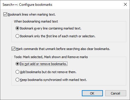

              Search++ version 0.7.0.2 is a test of my second attempt at improved bookmark handling. Help and change log have not been updated.
              @guy038, @peterjones, @astewart77 and anyone else interested, please let me know if this is better than the last attempt, and anything you would like to be different.
              • Fixed right-click in Find or Search box causing next left-click on a Search++ menu to act as if it were a right-click.
              • Some changes in the wording and organization of the Configure bookmarks dialog.
              • Separated Invert and Synchronize into sub-menus on the Tools menu, with all sub-menu choices now independent of the Configure bookmarks settings.
              Hopefully the Configure bookmarks dialog is a little more clear now. I rearranged it as @guy038 suggested, putting the Bookmark lines when marking text check box at the top and disabling everything when it is not checked, and I made some changes in wording:
              In version 0.7.0.1, the Invert marked text and Synchronize bookmarks to marked text commands on the Tools menu were affected by some settings in the Configure bookmarks dialog but not by others. It was confusing.
              In version 0.7.0.2 the dialog is more explicit about what commands respond to the settings in the bottom box. The commands that were previously exceptions are now on sub-menus, Invert marks or bookmarks and Synchronize marks and bookmarks. Each sub-menu has several options, none of which depend on settings in the Configure bookmarks dialog.
              A downside to this is that there are no keyboard shortcuts for the items on the sub-menus. (There are only a couple available shortcuts left, and I can’t see how I could prioritize one over another.)
              • The sub-menu options that are qualified with “excluding line endings” mark entire lines to match bookmarks, but avoid marking the line ending characters.
              • “Add (book)marks” vs “(Book)Mark only” distinguishes adding to preexisting marks or bookmarks from clearing them first.
              All feedback is welcome and appreciated.

                  • guy038G Offline
                    Hi, @coises,
                    Oh…, my God, I’m just realizing that I did all my previous tests with the main Bookmark lines with marking text option OFF, so with the Search++ Configure bookmark dialog all greyed !
                    Thus, my tests are quite incomplete :-(( I’ll continue testing … !
                    • guy038G Offline
                      Hello, @coises and All,
                      Thus, I chose these options within the Search++: Configure bookmarks dialog :
                      And ultimately, given the chosen options, the only differences are :
                      • When you mark something, it automatically bookmarks the associated line
                      • When you unmark something, it automatically removes the bookmark of the associated line
