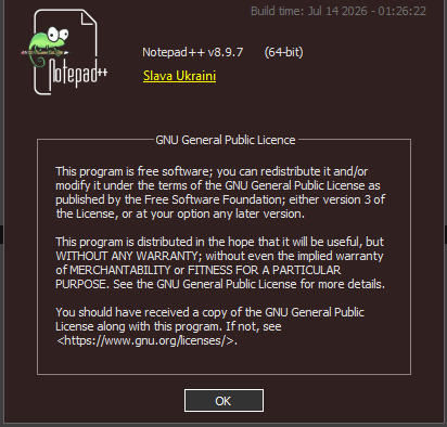

                    • R Offline
                      RoxxiedaPunk @donho
                      @donho Hey, Just wanted to let you know in case this isn’t just an isolated incident that my Notepad++ isn’t updating to 8.9.8. It’s now the 17th of September for me which is 3 weeks since the release of 8.9.8, and idk if this is an isolated incident, but my Notepad++ is still 8.9.7 and clicking the “Update Notepad++” button still displays the “No update is available” message, though the update is being detected by winget, just not the actual program, which is odd. Anyways, just thought i’d let you know about this just in case it’s not actually just an isolated issue! I’ll attach a screenshot of the info screen and updater, and will also add the Debug info below this and above the screenshots!
                      Debug Info: Notepad++ v8.9.7 (64-bit)
                      Build time: Jul 14 2026 - 01:26:22
                      Scintilla/Lexilla included: 5.6.4/5.5.1
                      Boost Regex included: 1_90
                      pugixml included: 1.16
                      Command Line:
                      Admin mode: ON
                      Local Conf mode: OFF
                      Cloud Config: C:\Users\Foxy\OneDrive
                      WinGUp: present
                      disableNppAutoUpdate.xml: absent
                      Periodic Backup: ON
                      Placeholders: ON
                      Multi-instance Mode: monoInst
                      asNotepad: OFF
                      Dark Mode: ON
                      Display Info:
                      visible monitors count: 1
                      0000: Description - Meta Virtual Monitor
                      0000: DriverVersion - 5.3.57.114
                      0001: Description - Intel® UHD Graphics 750
                      0001: DriverVersion - 32.0.101.7088
                      0002: Description - NVIDIA GeForce RTX 3050
                      0002: DriverVersion - 32.0.16.1692
                      OS Name: Windows 10 Pro (64-bit)
                      OS Version: 22H2
                      OS Build: 19045.7725
                      Current ANSI codepage: 1252
                      Plugins:
                      ComparePlugin (2.0.2)
                      JsMapParser.NppPlugin (4.2)
                      mimeTools (3.1)
                      NotepadStarterPlugin (2.3.3)
                      NppConverter (4.7)
                      Screenshots
                        PeterJones @RoxxiedaPunk
                        That’s because it was not triggered for auto-update.
                        The downloads page at https://notepad-plus-plus.org/downloads/ will indicate the most recent auto-update version with “(stable: auto-update triggered)” or similar phrasing. As of today, 8.9.7 is the last triggered version.
                        The manual explains the reason for not immediately triggering a new version for auto-update here: https://npp-user-manual.org/docs/upgrading/#no-new-version-found-safety-delay.
                        In this case, there were some critical fixes needed, hence today’s v8.9.8.1 Release Candidate
