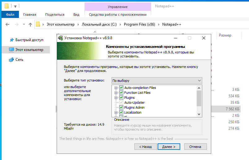

      When you ran the installer, did you turn off the following checkmark?
      How do I change this setting in the portable version?

        There is no such setting for portable. The normal portable (not the minimalist) comes with the nppPluginList.dll in the right place, so Plugins Admin should just work.

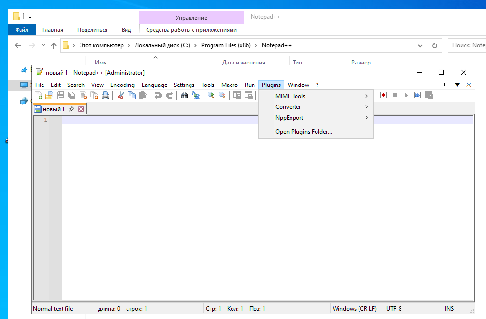

        • A Offline
          andrecool-68 @PeterJones
          @PeterJones said:
          If you need more help, create a new Topic, as the problem you are having does not appear to be a regression, and shouldn’t be part of this Announcement.
          I can’t ask questions on the site github.com and I don’t understand what to do about it:
          https://i.imgur.com/EnMge5h.mp4
          This question of mine is not related to this topic, but I already don’t know what to do.

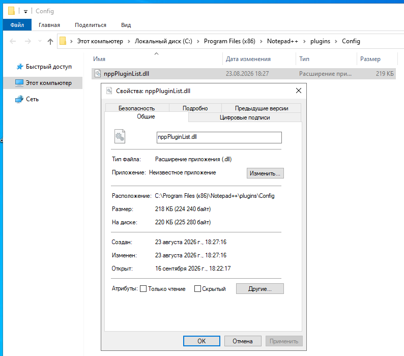

            PeterJones @andrecool-68
            @andrecool-68 ,
            I wasn’t saying to use GitHub. I was saying to create a new Topic here, in the Community Forum. I just moved your post and the replies to a new Topic, so you don’t have to create a new Topic any more. Just answer in reply here, not in the Announcement topic.

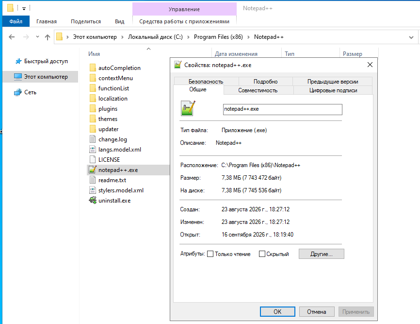

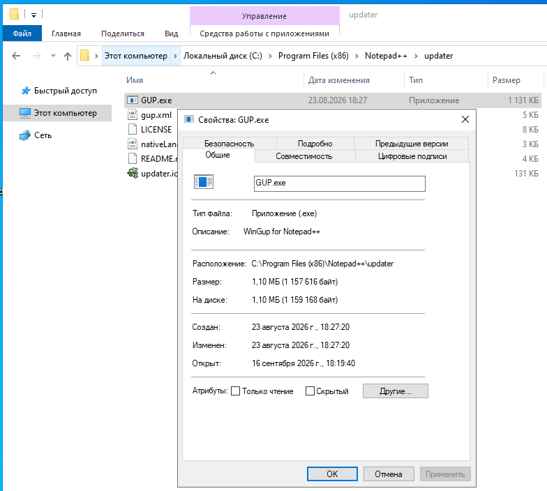

              @andrecool-68 ,
              So I have no clue why GitHub isn’t letting you type, as shown in your video. It might have something to do with you using the onscreen keyboard instead of a physical keyboard. There’s nothing I can do about that.
              But let’s get back to your Plugins Admin issue. (At least, I am assuming you have an issue with Plugins Admin, since you were asking how to change that installer option when using Notepad++. The only reason I can imagine that’s what you are asking for is because you were seeing Plugins Admin not being there in the menu.)
              You claim you have a portable version. So that means it’s at some path like c:\myportable\notepad++\ (that’s the path I will use for my examples)
              1. Exit all copies of Notepad++
              2. use Windows Explorer to go to c:\myportable\notepad++\
              3. right click on notepad++.exe,
                • select Properties,
                • be on the General tab (which is the first tab you should see).
                • Look at the bottom.
                • Does it have the “Unblock” checkbox at the bottom, like in the following screenshot?
                  • If so, click the checkbox and choose Apply then OK
              4. use Windows Explorer to go to c:\myportable\notepad++\updater\
              5. right click on GUP.exe,
                • Does it have the “Unblock” checkbox at the bottom?
              6. use Windows Explorer to go to c:\myportable\notepad++\plugins\Config\
              7. right click on nppPluginList.dll,
              Now, run Notepad++ again. Plugins Admin should show up in the Plugins menu
              If it does not, you need to do the following:
              • Share your ?-menu’s Debug Info
              • Share a screenshot of your Plugins menu
                • not a movie
                • please do a normal screenshot, so you can paste it right in your post, so we can see it withouth going to an external website who exists solely to show us ads we don’t want.
                • it should be something like this:
              • Share your directory listing (either a screenshot or the output of the dir command) for each of the three directories mentioned in my initial steps 1, 3, 5
              A 1 Reply Last reply Reply Quote 0

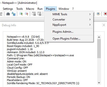

              • A Offline
                Did a clean install on a virtual machine with Windows 10
                Notepad++ v8.9.8 (32-bit)
                Build time: Aug 23 2026 - 17:20:01
                Scintilla/Lexilla included: 5.6.6/5.5.3
                Boost Regex included: 1_90
                pugixml included: 1.16
                Path: C:\Program Files (x86)\Notepad++\notepad++.exe
                Command Line:
                Admin mode: ON
                Local Conf mode: OFF
                Cloud Config: OFF
                WinGUp: present
                disableNppAutoUpdate.xml: absent
                Periodic Backup: ON
                Placeholders: OFF
                Multi-instance Mode: monoInst
                asNotepad: OFF
                Dark Mode: OFF
                Display Info:
                primary monitor: 1920x1007, scaling 100%
                visible monitors count: 1
                0000: Description - VirtualBox Graphics Adapter for Windows 8+
                0000: DriverVersion - 5.2.44.0
                OS Name: Windows 10 Enterprise LTSC 2021 (64-bit)
                OS Version: 21H2
                OS Build: 19044.1288
                Current ANSI codepage: 1251
                Plugins:
                mimeTools (3.1)
                NppConverter (4.7)
                  @andrecool-68 said:
                  All the mark of the web looks okay, and all the files are in the right place.
                  I am not sure why it’s not working for you. With a similar installation, but 64-bit, I have no problems with Plugins Admin

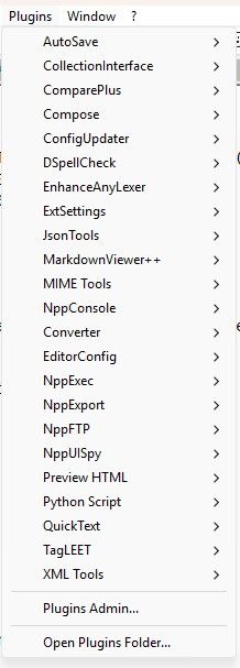

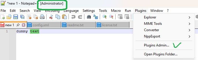

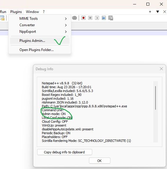

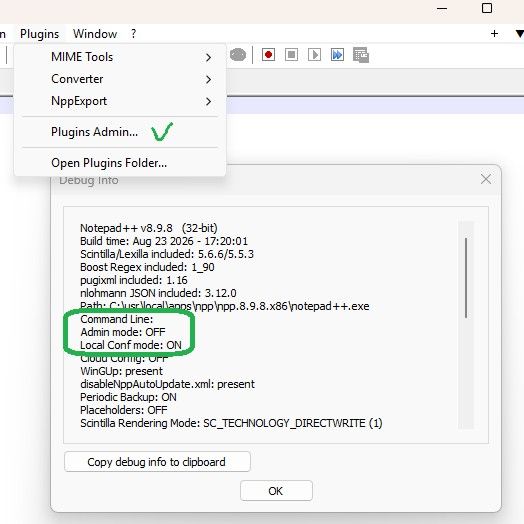

                  First few experiments on my end:
                  • 8.9.8-64bit, non-Admin: my daily driver, and I use Plugins Admin frequently:
                  • 8.9.8-64bit, Admin:
                  • 8.9.8-32bit, Not Admin:
                  • 8.9.8-32bit, Admin:
                  So, so far, on my Win 11 machine, I cannot replicate with 64-bit or 32-bit, admin or no, with the portable (or the installed, for 8.9.8-64)
                  Update
                  Virtual Win 10 machine:
                  • Portable 32-bit: Plugins Admin is there, whether normal run or Admin
                  • Portable 64-bit: Plugins Admin is there, whether normal run or Admin
                  • Installed 64-bit: Plugins Admin is there, whether normal run or Admin
                  • Installed 32-bit: Plugins Admin is there, whether normal run or Admin
                    Command Line:
                    Admin mode: ON
                    Cloud Config: OFF
                    WinGUp: present
                    Periodic Backup: ON
                    Placeholders: OFF
                    asNotepad: OFF
                    Dark Mode: OFF
                    Display Info:
                        primary monitor: 1024x666, scaling 100%
                            0000: Description - VirtualBox Graphics Adapter (WDDM)
                            0000: DriverVersion - 7.1.8.18469
                    OS Name: Windows 10 Home (64-bit)
                    OS Version: 22H2
                    OS Build: 19045.5854
                    Current ANSI codepage: 1252
                    Plugins:
                        mimeTools (3.1)
                        NppConverter (4.7)
                  I tried to get as close to your setup as I possibly can, and I still cannot replicate your problem.
                  If what I have suggested to you to try doesn’t help, then you’ll have to wait for someone else to have some ideas. Good luck,
