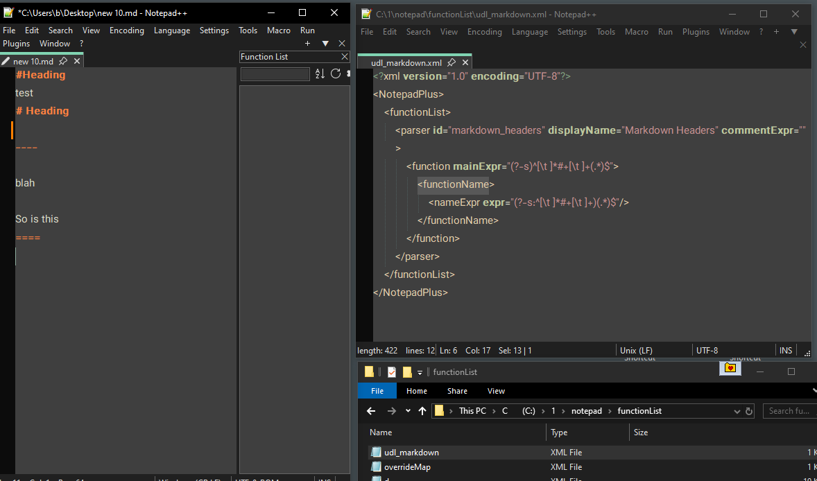

      Hi
      headings are not displayed in the function list menu.It was working fine until a few months ago, but suddenly it stopped showing any headlines. I tried 50 AI commands, but it didn’t work. I really need the headlines. What can I do to make it show the headlines again?2026-09-09 16_42_57.png ش

          Tanks for your help. I use portable version.I save all the useful texts I collect from the internet in .md files because they have headings. For example, after I find a solution to this problem, I save it in an .md file.

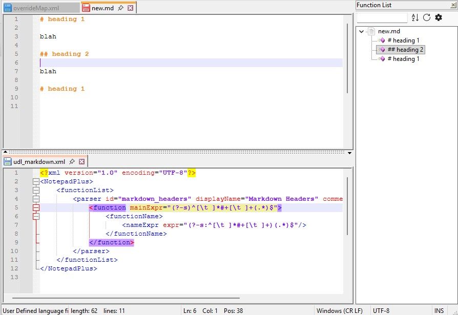

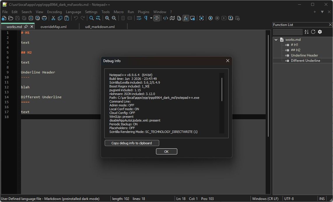

            PeterJones @behrouz1
            @behrouz1 ,
            All your setup – directories, file names, and the overrideMap association – look right.
            It looks like your function list regex can be slightly modified to make it work.
            The .* from ^[\t ]*#+[\t ]+(.*)$ is matching across multiple lines, because the default for the .-matches-newline switch in the regex engine is “on”. Using (?-s) or equivalent is highly recommended for the function name matching.
            So with that slight tweak, I was able to make yours work:
            <?xml version="1.0" encoding="UTF-8"?>
            <NotepadPlus>
                <functionList>
                    <parser id="markdown_headers" displayName="Markdown Headers" commentExpr="">
                        <function mainExpr="(?-s)^[\t ]*#+[\t ]+(.*)$">
                            <functionName>
                                <nameExpr expr="(?-s:^[\t ]*#+[\t ]+)(.*)$"/>
                            </functionName>
                        </function>
                    </parser>
                </functionList>
            </NotepadPlus>
            You also might want to try mine (linked above), because it also handles “underlined header” syntax, like:
            This is a header
            blah
            So is this
            And those “underlined header” syntaxes are recognized by many markdown parsers (including the one for this forum).
            B 1 Reply Last reply Reply Quote 0

              I put your code in the udl markdown file but the problem did not resolve and don’t show any thing in function list.
              I’m not good in English and Codes so I’m sorry maby I’m mistake

                @behrouz1 ,
                Any time you make a change to the function list definition, you must save it, then close all instances of Notepad++, then reopen Notepad++ to force it to re-read the definition, before it will take effect. Did you do that?
                (And, the (?-s) change isn’t sufficient to get underline headers. You have to use the version from the link I provided earlier to get those.)
                    @behrouz1 ,
                    I didn’t notice: you are using dark mode.
                    overrideMap.xml needs to point to Markdown (preinstalled dark mode) as the UDL name.
                    • B Offline
                      behrouz1 @PeterJones
                      Yes. I"m using dark mode.I edit udl_markdown.xml but the problem did not resolve. udl_markdown.xml now:
                      <association id="udl_markdown.xml" userDefinedLangName="Markdown (preinstalled dark mode)"/>
                        @behrouz1 ,
                        I cannot see what’s going wrong. It all works perfectly when I set things up for myself, as decribed in the conversation above. My guess is there’s been a miscommunication or misunderstanding at some point.
                        Here is a zip archive of a portable 8.9.6.4 set in Dark Mode:
                        • (link deleted). The zipfile will only be there for a few days, then I will delete this link.
                        Download it. Look at the mentioned files and filestructure. Compare what’s wrong in yours compared to this working example.
                        • B Offline
                          Thank YOU so much
                          I copy Your overrideMap & udl_markdown in my folder and problem is solved.
                          I wish program by default have this option.
                          Thank you again dear Peter
