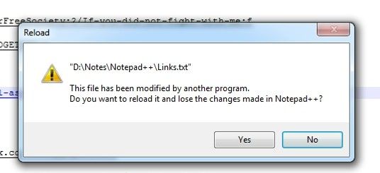

          On another note, off & on since the update, I keep getting this error, & then there’s another question after this one which I forgot to take a SS of.
          https://nimb.ws/i9V1zXa
          Also, when I click on Ctrl. F, most of the time it doesn’t highlight & place my cursor in the text field so I can type a new keyword. I had no problems with the other one.
          Thanks for your help.
            Just paste the image into your post: you don’t need to upload it to a service.
            That means some other program had updated Links.txt since the time you opened it in Notepad++. Your choices are to say “YES”, which will read the copy from disk, and get rid of all your edits, or to say “NO” and overwrite whatever is on disk with what’s currently visible in Notepad++. Which choice is right depends on your computer, and we cannot tell you which is right for you to choose.
