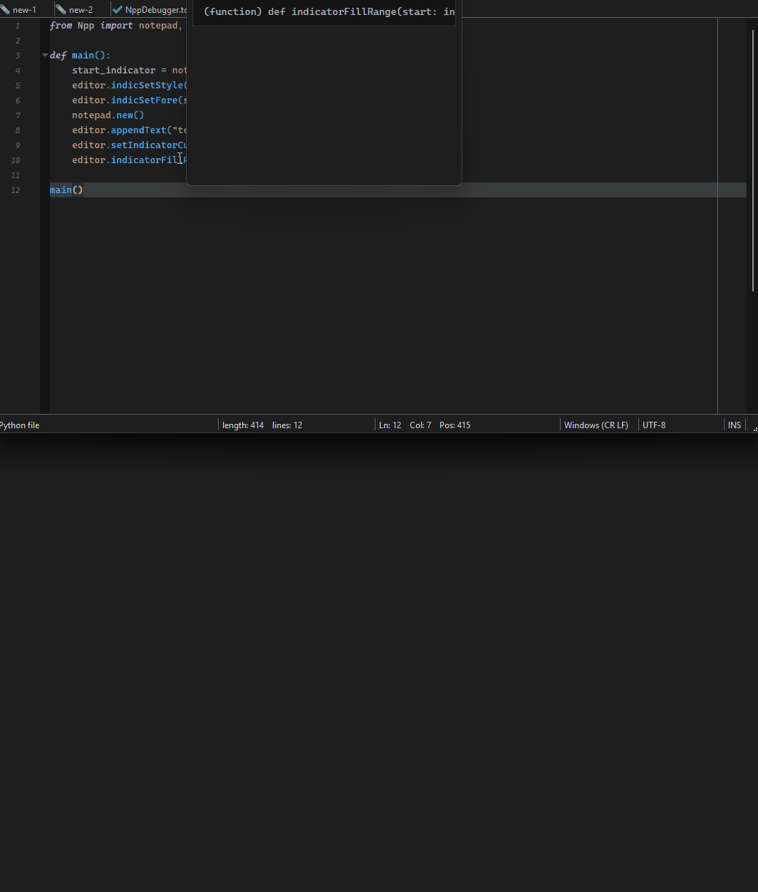

                  Now if it worked with PythonScript, so I could single-step while debugging N++ automation
                  To enable debugging of Python scripts, you need a local Python installation and must install the “debugpy” module.
                  Of course, the PythonScript plugin must also be able to access the local Python installation.
                  My test configuration looks like this
                  [python.script]
                  debugger = "C:/PortableApps/npp/notepad++.exe"
                  debugger_args = ["-pluginMessage=PythonScript=run_in_debug_mode=C:/repos/nppdebugger/tests/debuggees/python/test_pythonscript.py"]
                  mode = "tcp"
                  host = "127.0.0.1"
                  port = 5678
                  launch_args = '''{
                  	"program": "C:/repos/nppdebugger/tests/debuggees/python/test_pythonscript.py"
                  In addition, you need a script to configure debugpy accordingly.
                  import os
                  os.environ["PYDEVD_DISABLE_FILE_VALIDATION"] = "1"
                  from Npp import console, notepad
                  import debugpy
                  import re
                  def main():
                      cmd_line = notepad.getCommandLine()
                      if "-pluginMessage=PythonScript=run_in_debug_mode" in cmd_line:
                          debugpy.configure(python=r"C:\python\python314\python.exe")
                          debugpy.listen(('127.0.0.1', 5678))
                          console.write("Waiting for DebuggerApp to attach on port 5678...\n")
                          console.show()
                          matches = re.search(r'-pluginMessage=PythonScript=run_in_debug_mode=(.+?)(?>;|$)', cmd_line)
                          if matches is None:
                              console.writeError("Script to be debugged was not provided")
                              return
                          target_file = matches.group(1)
                          debugpy.wait_for_client()
                          console.write("PythonScript thinks this file is: " + __file__ + "\n")
                          with open(target_file, 'r', encoding='utf-8') as f:
                              script_content = f.read()
                          code_obj = compile(script_content, target_file, 'exec')
                          env = globals().copy()
                          env['__file__'] = target_file
                          env['__name__'] = '__main__'
                          exec(code_obj, env)
                  main()
                  The key factors are the debugpy lines and the fact that the correct script is called as soon as the client connects to debugpy.
                  So, start debugging and run the script in the new NPP instance, and then you should be able to step through it.
                  EDIT: and of course the new v.0.0.2 version of NppDebugger is needed
