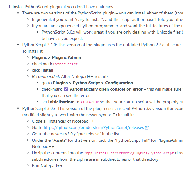

        We have a FAQ that explains the entire process of getting a script to work in the PythonScript plugin, including how to add it to the menu then attach a keyboard shortcut

            Then I looked for “python” and found “FAQ: How to install and run a script in PythonScript”
            In my last post, the word “FAQ” was a link which took you to the FAQ: How to install and run a script in PythonScript. If you didn’t notice that and click it, and instead had to actually read through the topic list in the FAQ, I’m sorry that you didn’t recognize a link in the post.
            Thanks for your response but I looked in the FAQ for the word “hotkey” and found nothing NO FAQ

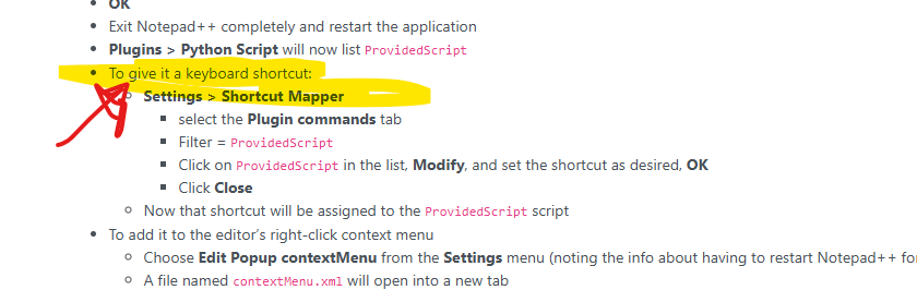

            Inside the PythonScript FAQ, which is the FAQ I linked you to, it’s called “keyboard shortcut”, not “hotkey”. Here’s a screenshot of the relevant piece of the FAQ:

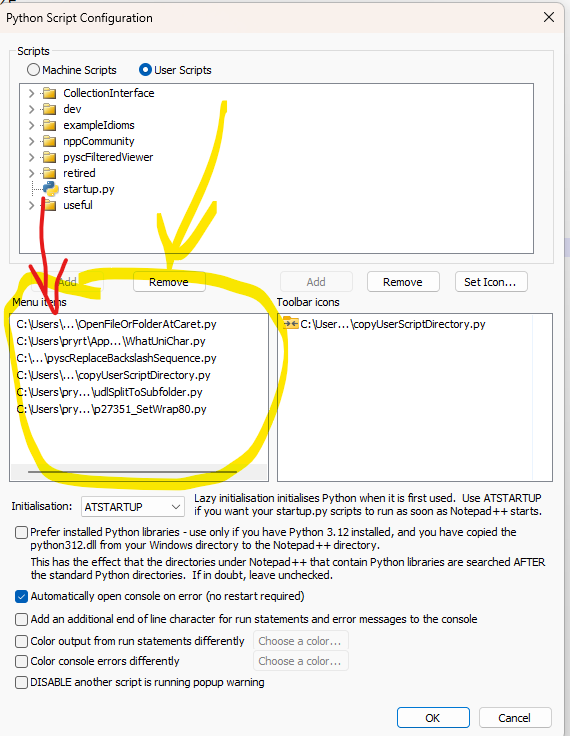

            Nonsense. This is my PythonScript Configuration menu for PythonScript 3.x, which is essentially unchanged from PythonScript 2.1’s Configuration menu:
            To add to the Menu Items list, you click the Add button over the Menu Items. It’s a very intuitive dialog, and that’s easy to understand.

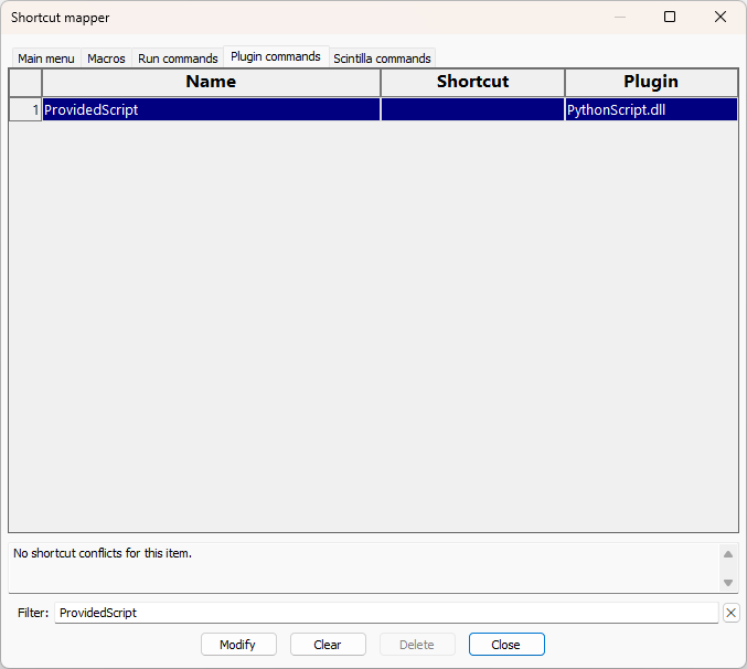

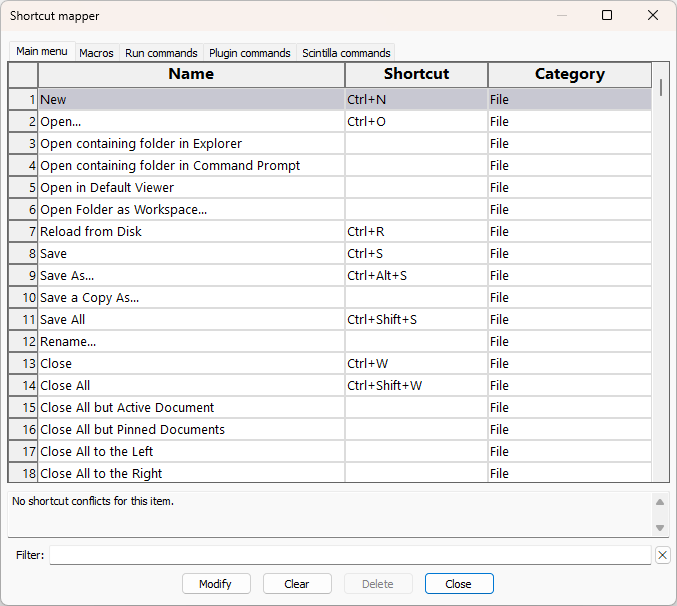

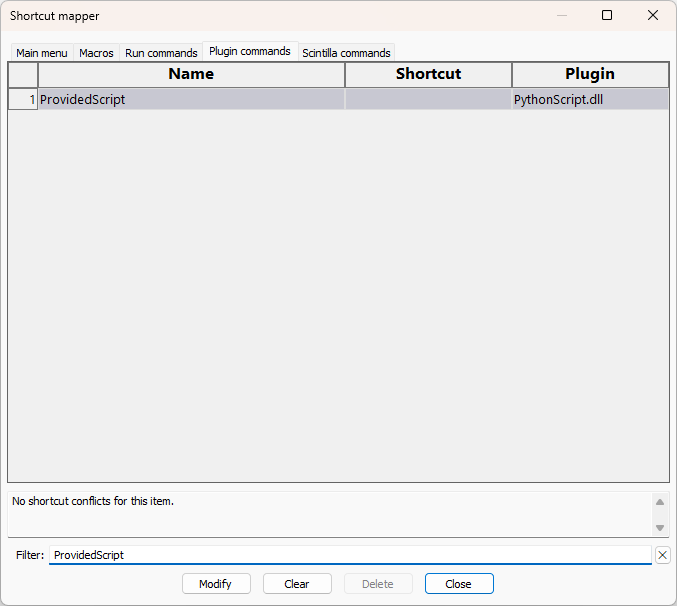

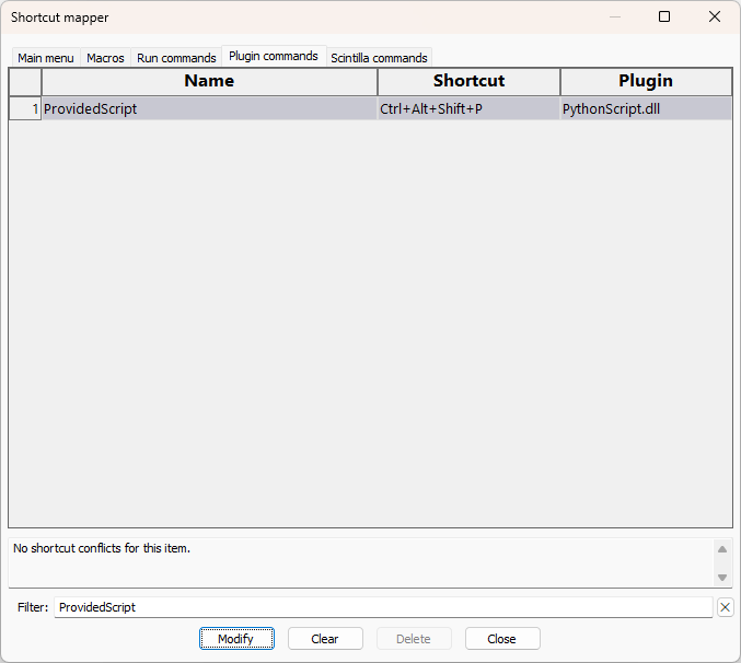

            Once you have placed the script in the menu, as explained in the FAQ, then you use Notepad++'s Shortcut Mapper (Settings > Shortcut Mapper) on the Plugin Commands tab of the Shortcut Mapper dialog. The FAQ explains this.

            As the FAQ explains: add the script to the menu, then use Notepad++'s Shortcut Mapper to assign the shortcut.

                “To give it a keyboard shortcut:
                Settings → Shortcut Mapper → Plugin Commands → ProvidedScript”

                  I will reword the instructions that I already wrote in the FAQ just to help you. This is how important it is to me to help you understand how to do this.
                  I am testing these steps PythonScript 3.0.25, and will be following my own instructions that I am typing to you while I take the screenshots. These replicate the steps in the FAQ.
                  My assumptions are:
                  • you already have PythonScript 3.0.x installed – hopefully 3.0.25, but the interface hasn’t changed since before PythonScript 2.0, so the screenshots should still match what you have.
                  • you already have created the script, and it shows up in Plugins > Python Script > Scripts

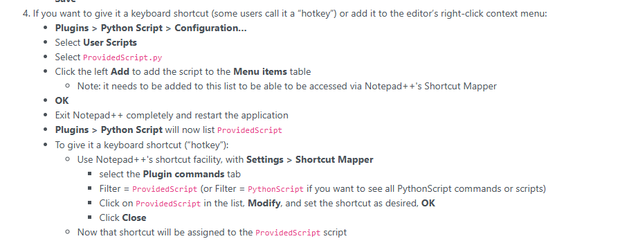

                  These are the instructions I am following from the FAQ:
                  The instructions, with screenshots:

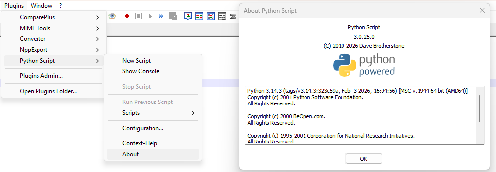

                  1. First, here is confirmation that I’m running PythonScript 3.0.25, based on a screenshot of PythonScript ABOUT box:
                    please show your ABOUT box if following these instructions do not work for you

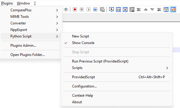

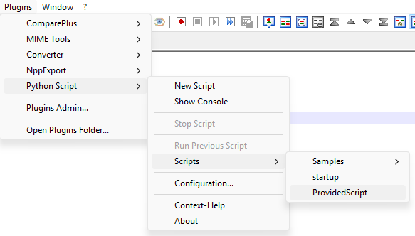

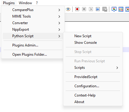

                  2. This shows I have already created the ProvidedScript.py, and it is in my scripts menu, but not in the main PythonScript menu.
                    please show a screenshot of your Scripts submenu if these instructions do not work for you

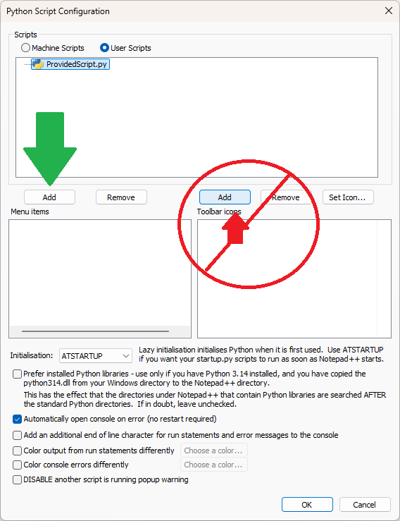

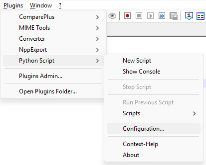

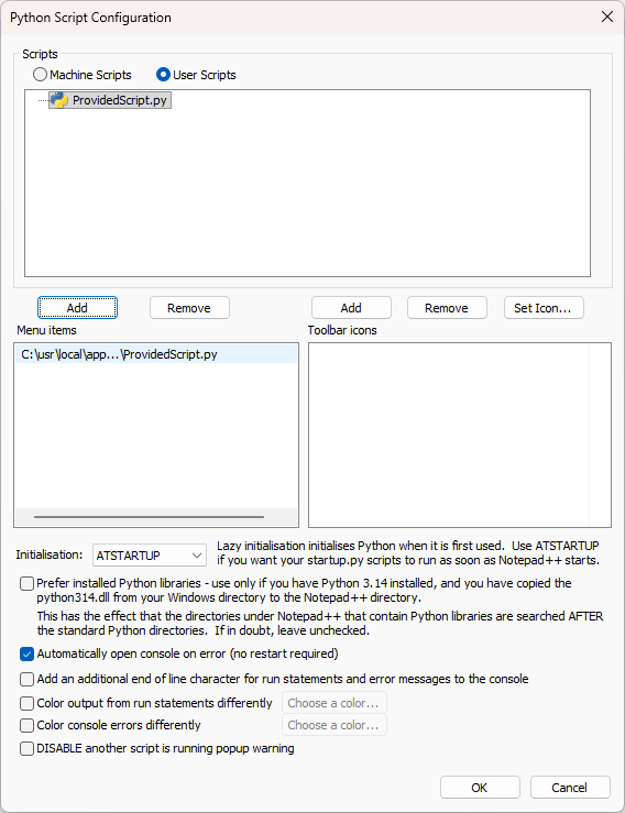

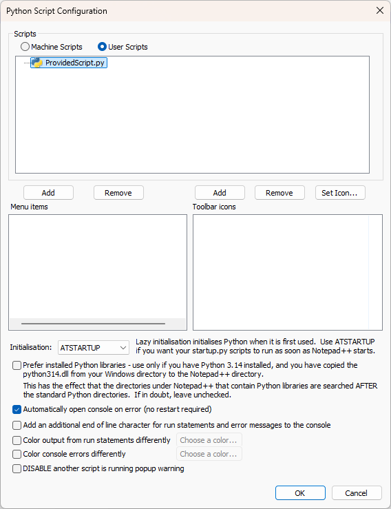

                  3. The FAQ instructions tell me to go Plugins >Python Script > Configuration…: I follow those instructions, and confirm the menu entry exists:

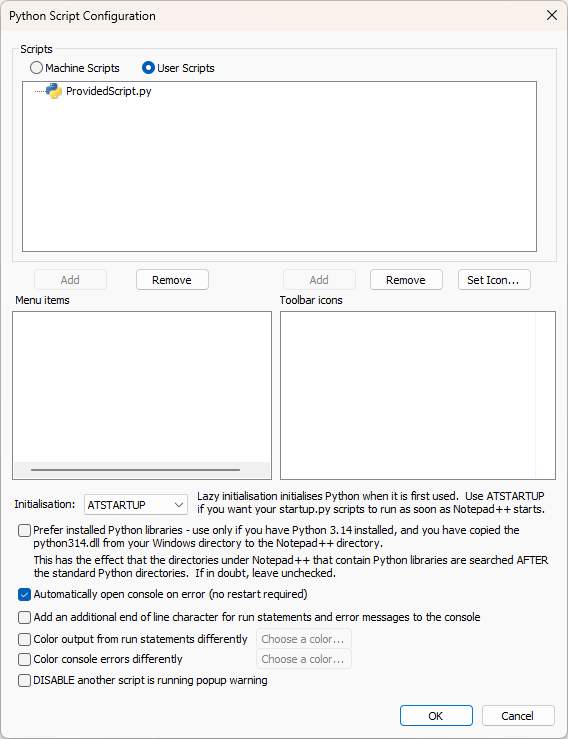

                  4. When I click that menu entry, I see the following dialog:
                    please show a screenshot of your Python Script Configuration dialog if these instructions do not work for you
                  5. The FAQ instructions tell me to pick User Scripts next. That is already selected, as shown in screenshot for step 4
                  6. The instructions tell me to select ProvidedScript.py. I click that, so it’s now got a highlight/selection bubble around it:
                  7. The instructions tell me to “Click the left Add to add the script to the Menu items table”. In this dialog, I see two Add buttons, so in the next step, I will click the left one: here is a screenshot with that button pointed to with a big green arrow. Do not click the one with the red arrow:
                  8. I follow the instructions to click the left Add button. Now the dialog has changed, to include my script in the Menu items list:
                  9. The instructions next say to click OK. I won’t supply another screenshot, as that button is easily findable.
                  10. The FAQ instructions tell me to “Exit Notepad++ completely and restart the application”. You have to do this in order for Notepad++ to be able to assign the keyboard shortcut. If you skip this step, the remainder of my instructions will not work. So I exit and restart Notepad++ (no screenshots)
                  11. The FAQ next says, “Plugins > Python Script will now list ProvidedScript”: here is a screenshot showing that is true for me:
                  12. The FAQ says to use Notepad++'s shorcut mapper using Settings > Shortcut Mapper. First, here is a screenshot of the menu, which includes that entry:

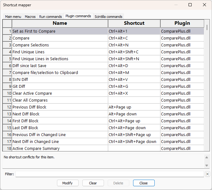

                  13. When I click that entry, I get the following dialog:
                  14. As the FAQ says, I next “select the Plugin commands tab”. In that dialog, I see “Plugin commands” at the top, so I click it, and see:
                  15. As the FAQ says, I next “Filter = ProvidedScript”. I see the Filter box in the dialog, so I type ProvidedScript there, and now see
                  Cool, I can see that ProvidedScript is available to the Shortcut Mapper with PythonScript 3.0.25 at this point. Making good progress.
                  If following these instructions is not working for you, please change the Filter to PythonScript, and then show a screenshot of your Shortcut Mapper dialog
                  1. The FAQ says, “Click on ProvidedScript in the list”, so I click on it. and can see that it’s been highlighted as active:
                  2. The FAQ instructs me to Modify, so I click that button, and a new dialog pops up:
                  3. The FAQ next says, “and set the shortcut as desired”, so I pick Ctrl+Alt+Shift+P:
                    if following these instructions is not working for you, please share the screenshot here, if you made it this far
                  4. The FAQ tells me that OK is next, so I click that, and it goes back to the full Shortcut Mapper dialog, which now shows that Ctrl+Alt+Shift+P is the shorcut:
                  5. At this point, the FAQ tells me that I can Close the dialog, so I do.
                  6. To check, I look at the Plugins > PythonScript menu again, and see that it now lists the shortcut next to ProvidedScript. Cool:
                  7. Finally, I do Ctrl+Alt+Shift+P, and it runs my script.

                    Step 1 - Confirmed I AM using 3.0.25.0
                    Step 2 - Confirmed Script Display plugins -> Python Script -> scripts

                    Step 3 - NOT confirmed plugins -> Python Script -> Configuration
                    DOES NOT LIST MY SCRIPTS… It NEVER has EVER in ALL my tests. My scripts DO NOT register…

                            In fiddling around I copied the PythonScript directory from Program Files into AppData and TaDa! Everything fell into place… EVERYTHING WORKED like clockwork!
                            BTW ALL shows in Configuration NOW including Samples AND startup.py. AND Settings -> Shortcut Mapper work a treat and I built my hotkeys… 👏🙏👍

                              Also, I thought telling you that NOTHING showed in " -> Configuration" was self evident and DIDN’T need a screen snapshot?
                              The screenshot would have confirmed: 1) that there really was “nothing” there (maybe you and I have a different definition of “nothing”), 2) whether you had really selected “user scripts” or had selected “machine scripts”, and 3) that you were willing to follow instructions to try to get help.
                              I’m happy to announce I’ve fixed it!!! Don’t ask me how but my WHOLE NP++ setup was weird!!! It seemed half in Program Files and half in AppData.
                              That’s not weird. That’s how Notepad++ and PythonScript are intentionally set up. The FAQ footnote that I’ve begged you to read explains why there are the two different script locations.
                              You thus copied way too much.
                              You could have copied just the scripts. Or you could have just clicked the “machine scripts” button in the dialog, like I told you to, and not had to copy any files.
