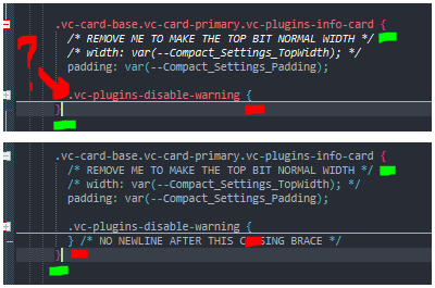

      When I fold a code level, I don’t want to also include the final, closing })] delimiter in the hidden part of the fold. How do I modify an existing language or UDL to include this brace folding behavior from python?
      If I select python as the language, and fold a layer using {} braces, the beginning line and the final line will be shown, which allows you to use the margin select to grab the entire block cleanly. Whereas most languages will include the closing line in the hidden part of the fold, and you need to rely on a newline after a block to properly select the entire block while it’s folded.
      In this image, the top is CSS syntax, the bottom is python and in the python image, you see the code block’s closing brace is visible, but the CSS text, does not; the next visible line is the closing brace for the fold level above this block. I highlighted level 1 with green and 2 with red.

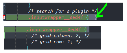

              @PeterJones This does show the closing brace on the end, but it unfortunately doesn’t do what I am looking to fix here. That being, the ability to select the entire block and its closing brace + newline.
              The top image appears to have selected until the closing } brace, but when i expand the section, the bottom image shows that it has only selected the first line.

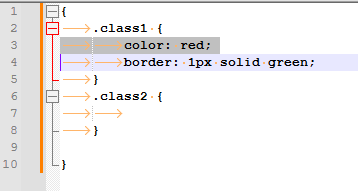

                Notepad++ indicates whether the newline is selected by extending the visible selection beyond the end of the line when it is. And if you really want to be sure, use View > Show Symbol > Show End of Line:
                • EOL not selected, so not whole block:
                • EOL selected, so whole block is actually selected, including final EOL:
                Yellow FolderzipY 1 Reply Last reply Reply Quote 2

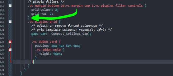

                  @PeterJones This is what I meant to describe by:
                  in the original post. Because without a double newline after the closing brace, selecting down one row will grab the first line of the next block. If I were to rely on this functionality, I would have to insert a double newline after every block, at the green arrow.

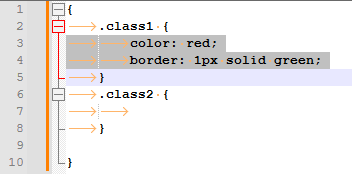

                    If you select the whole second fold line, of course it will select from that, just like with non-folded text. If you end the selection at the beginning of the line, rather than selecting the line, then it will work as you desire.
                    	.class1 {
                    		color: red;
                    		border: 1px solid green;
                    	.class2 {
                    Normal (visible) text:
                    • To select one line (including EOL) of indented text when next line is indented to the same level, stop the selection at the beginning of the next line
                    • To select both lines (including EOL), then stop at the beginning of the line following those lines.
                    Similarly, with collapsed blocks:
                    • To select just the first .class1 block when collapsed, just select to the beginning of the next line:
                    • To select both, then select to the beginning of the line after:
                    There is no need to have a blank line between them. Just select as much as you want to copy, exactly identical to how it works with no folded text.
