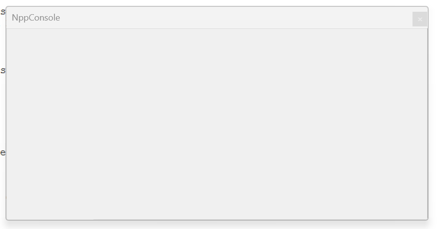

                  I installed v1.2.8.1 (i can tell that it is the one running from the different menu options), but i have sometimes () similar issues :
                  grey console at launch.
                  ) it seems to be sensitive to history.

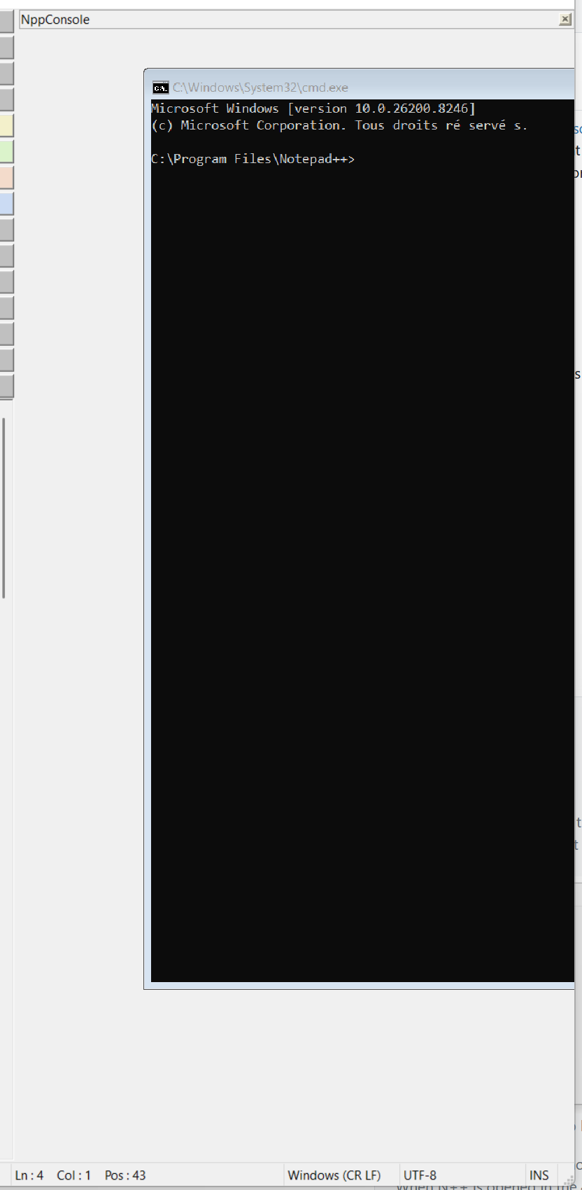

                  OK, i think i get it : It does not handle correctly 4K screen.
                  When N++ is opened in the 4K screen, i noticed that the terminal within the NppConsole does not occupy the full window -and cannot be resized to occupy the full window.
                  So i guess that when the Nppconsole is grey, the terminal within is out of bounds.
                  Restart console does not (always) help .
                  This time, i get :
                    @arnaud-derette said in Terminal window in a N++ tab:
                    That does not surprise me. Notepad++ is still not great for high-DPI environments, and it’s been taking a long time to finish some of the last-remaining high-DPI issues. And if the main app, with lots of contributors, still has issues, then it should come as no surprise that the plugins, which usually only have one developer (if they remain interested), whose skillset usually focuses on the feature that their plugin implements, rather than on the generics of all the edge cases of modern win32 coding. (At least, I know that’s true for me on my plugin(s).)
