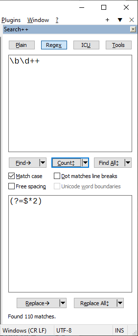

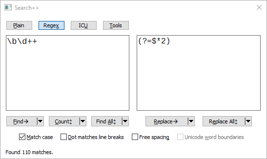

              Perhaps I should have included screenshots. Docked (default):
              Horizontal (non-docking):

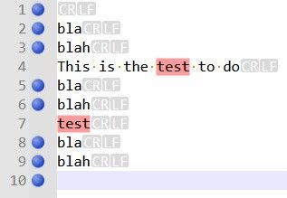

                            • Let’s hide all the contents of a file 1, with the option in the Tools panel
                            • Switch to an other file 2
                            • Switch back to file 1
                            All the lines of file 1 are visible again : I suppose that this behaviour is the one that you expect, don’t you ?

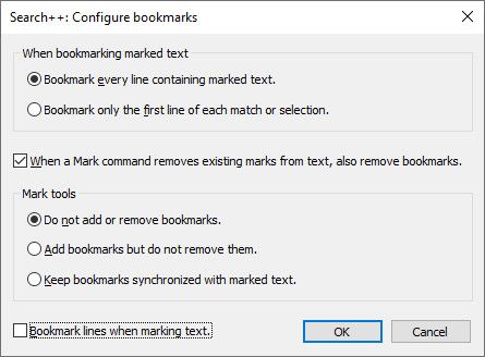

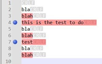

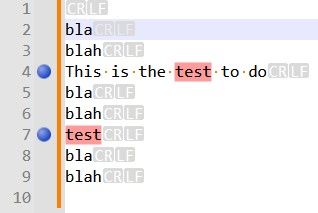

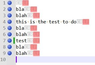

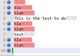

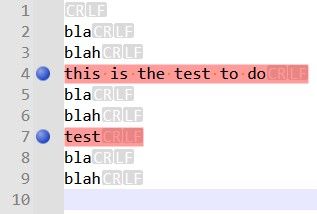

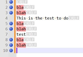

                            • Regarding the Mark functionnality :
                            • Let’s mark some text with the native N++ Mark dialog with the Bookmark line option checked
                            • If you use the Unmark All Text option of the Tools panel, it correctly clear all the marks. However, it does not clear the associated bookmarks !
                            I think of two possible solutions :
                            • Clear all the bookmarks, as well
                            • Add a new Clear bookmarks option
                            Now, let suppose this text :
                              Unless it doesn’t work for some reason (I haven’t tried it yet), I think Notepad++’s own Search | Bookmark | Clear all bookmarks can handle that.
