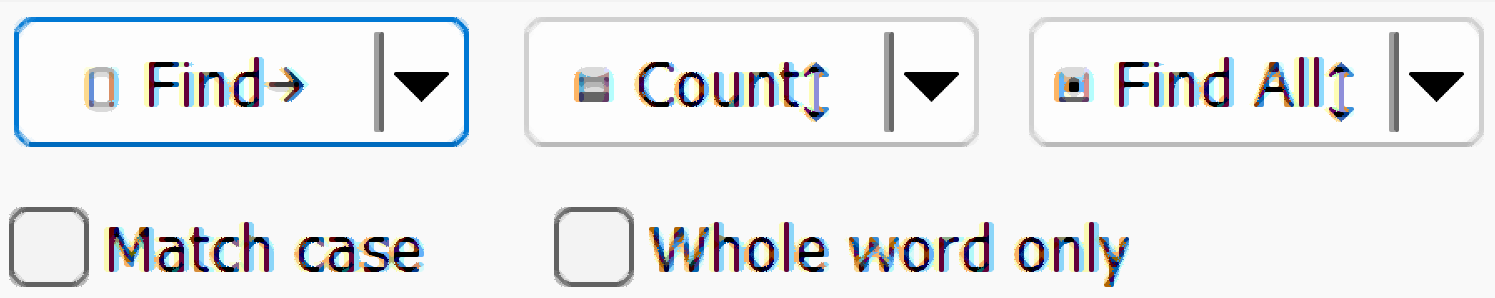

                    • First, I would say that the possibility to change the default value of a button by hitting the Shift key while clicking on a specific sub-menu, is very interesting !
                    After testing all the cases, I noticed that :
                    • The Backward direction is noted with the ← arrow, in the Find and Replace sub-menus
                    • The Forward direction is noted with the → arrow, in the Find and Replace sub-menus
                    • The Before indication is noted with the ↑ arrow, in the Count, Find All / Mark / Select / Show and Replace All sub-menus
                    • The After indication is noted with the ↓ arrow, in the Count, Find All / Mark / Select / Show and Replace All sub-menus
                    • The All/Everywhere indication is noted with the ↕ arrow, in the Count, Find All / Mark / Select / Show and Replace All sub-menus
                    However, the indications for Selection, Marked text and Whole document, at beginning of buttons, are rather difficult to visualize : May be, a different and distinctive shape and/or color would be welcome ! I put the 3 cases in a single picture and they look as below :
                    • The Find button is preceded by the Whole Document mark
                    • The Count button is preceded by the Marked Text mark
                    • The Find All button is preceded by the Selection mark
                    I’ve begun to study the purpose of each sub-menu ( not so obvious ! ) and I’ll probably ask you about some weird behaviours in a next post
