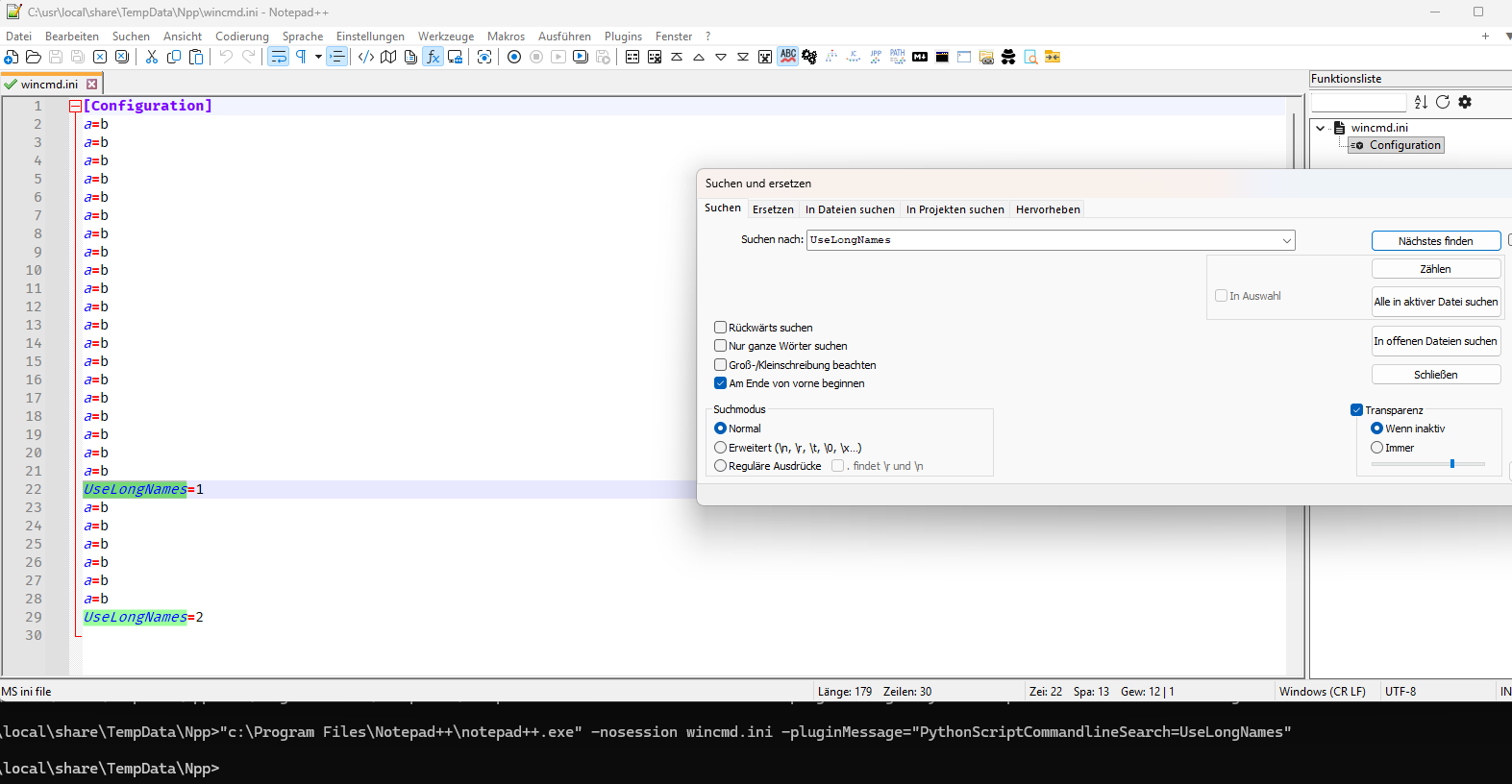

                  I wanted to ask whether you wrote the script so that the search is executed automatically (i.e., the “Find next” button is pressed automatically) or if it only fills the search field with the “term”?
                  For me, the term is only inserted, and I have to trigger the search manually (I’m not a programmer – please excuse my lack of scripting knowledge).

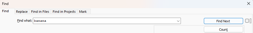

                    For me, it clicks the Find Next. It worked with 100% of my tests. Are you using English localization (so the button is literally Find Next) or are you in a different localization?
                    And do you have the single button, like
                    or the two buttons with arrows?
                    Because it’s looking for exact button text when trying to figure out what to click; if it cannot find a button called Find Next, then it won’t be able to press it. So if there’s anything different from a default setup, my script will likely not work for you.
                      But surely it isn’t difficult for @Native2904 to edit any necessary text string content in the script, even if “not a programmer”.
                      Saying “…my script will likely not work for you” seems rather dead-endish…
                      • PeterJonesP Online
                        @Alan-Kilborn said in How can I pass a search term to Notepad++ via command?:
                        You’re right. I should have said, “my script will likely not work for you as is” or “… without edits”.
                        Putting in the exact text of that button is what’s essential for @Native2904 … but if it’s got an underlined character, it needs to be remembered to put the & before that characater in the string.
                        So yes, @Native2904, if you can put in the text of your Find Next button, and it makes it work, great. If not, take a screenshot of the Find dialog, and paste it in your reply. (Also grab ?-menu’s Debug Info)

                          I only modified her script in such a way that I changed all the names that were different according to the pattern:
                          hFindBtn = FindWindowEx(hFindWnd, 0, "Button", None)

                          • N Offline
                            Native2904
                            Sorry, but in the GIF, Notepad** is already set to English; it was actually running in German until now.
                            I first need to get used to the editor’s rules as a new user.
                            I can no longer edit my first reply with the debug log.
                            I would like to correct myself: it’s only that one entry I changed.
                              PeterJones @Native2904
                              @Native2904 said in How can I pass a search term to Notepad++ via command?:
                              Most likely, you’re just missing the & to indicate the underlines.
                              But assuming it’s the default German localization, I should be able to figure out what needs to be done, and post the edited version of the script.

                                updated script:
                                # encoding=utf-8
                                """in response to https://community.notepad-plus-plus.org/topic/27472/
                                (fixed URL to Topic)
                                process -pluginMessage="PythonScriptCommandlineSearch=term"
                                `term` must be a normal search term, not a regular expression; it currently cannot include semicolons `;` or double-quotes `"`
                                updated version for German localization
                                #####   Instructions:
                                #####   {these assume a normal installation of Notepad++, using %AppData%\Notepad++ for user configuration}
                                #####   See [PythonScript FAQ](https://community.notepad-plus-plus.org/topic/23039/faq-how-to-install-and-run-a-script-in-pythonscript)
                                #####   - Create `%AppData%\Notepad++\plugins\PythonScript\scripts\commandlineSearch27472.py`, from the contents below
                                #####   - Check for menu entry **Plugins > Python Script > Scripts > startup (User)**
                                #####       - if it is listed, `Ctrl+click` on it to edit, and add the following to the end:
                                #####       - if it isn't listed, create `%AppData%\Notepad++\plugins\PythonScript\scripts\user.py` from the contents below
                                #####       - set **Plugins > Python Script > Configuration...** to **Initialisation: `ATSTARTUP`**
                                #####       - exit and restart Notepad++
                                #####   After doing that, the script should look for
                                #####   `notepad++ -pluginMessage="PythonScriptCommandlineSearch=term"`, and run a search for `term`
                                #####   For now, it won't work with semicolon `;` or double-quote `"` in the search term;
                                #####       if that is needed, I would need to add an escape sequence processing, which would make it more complicated.
                                from Npp import notepad, console, NOTIFICATION, MENUCOMMAND
                                import ctypes
                                import sys
                                import re
                                import time
                                import ctypes
                                from ctypes.wintypes import HWND, UINT, WPARAM, LPARAM, HMODULE, LPCWSTR, LPCSTR, LPVOID
                                def usePluginMessageString27472de(s):
                                    m = re.search(r'PythonScriptCommandlineSearch=([^;"]+)', s)
                                    t = m.group(1)
                                    # Define the functions and constants needed
                                    FindWindow = ctypes.windll.user32.FindWindowW
                                    FindWindow.argtypes = [LPCWSTR, LPCWSTR]
                                    FindWindow.restype  = HWND
                                    FindWindowEx = ctypes.windll.user32.FindWindowExW
                                    FindWindowEx.argtypes = [HWND, HWND, LPCWSTR, LPCWSTR]
                                    FindWindowEx.restype  = HWND
                                    SendMessage = ctypes.windll.user32.SendMessageW
                                    SendMessage.argtypes = [HWND, UINT, WPARAM, LPARAM]
                                    SendMessage.restype  = LPARAM
                                    SendMessageStr = ctypes.windll.user32.SendMessageW
                                    SendMessageStr.argtypes = [HWND, UINT, WPARAM, LPCWSTR]
                                    SendMessageStr.restype  = LPARAM
                                    SendDlgItemMessage = ctypes.windll.user32.SendDlgItemMessageW
                                    SendDlgItemMessage.argtypes = [HWND, UINT, UINT, WPARAM, LPARAM]
                                    SendDlgItemMessage.restype = LPARAM
                                    WM_SETTEXT = 0x000C
                                    BM_CLICK = 0x00F5
                                    # see https://community.notepad-plus-plus.org/post/59785 for VB.net inspiration
                                    notepad.menuCommand(MENUCOMMAND.SEARCH_FIND)
                                    hFindWnd = None
                                    # try 10 times
                                    for i in range(10):
                                        hFindWnd = FindWindow("#32770", "Find")
                                        if not hFindWnd:
                                            hFindWnd = FindWindow("#32770", "Suchen")
                                        if not hFindWnd:
                                            hFindWnd = FindWindow("#32770", "Suchen und ersetzen")
                                        if hFindWnd:
                                            break
                                        time.sleep(0.2) # wait for the Find window to appear
                                    hComboBx = FindWindowEx(hFindWnd, 0, "ComboBox", None) if hFindWnd else 0
                                    hFindStr = FindWindowEx(hComboBx, 0, "Edit", None) if hComboBx else 0
                                    SendMessageStr(hFindStr, WM_SETTEXT, 0, t)
                                    # set search mode:
                                    hNormBtn = None
                                    for i in range(10):
                                        hNormBtn = FindWindowEx(hFindWnd, 0, "Button", "Norma&l")
                                        if hNormBtn:
                                            break
                                        time.sleep(0.2)
                                    if hNormBtn:
                                        SendMessageStr(hNormBtn, BM_CLICK, 0, None)
                                    # start search
                                    hFindBtn = None
                                    for i in range(10):
                                        hFindBtn = FindWindowEx(hFindWnd, 0, "Button", "Näch&stes finden")
                                        if hNormBtn:
                                            break
                                        time.sleep(0.2)
                                    console.write(f"FindWindows: FIND={hFindWnd:08X} ComboBox={hComboBx:08X} FindNext:{hFindBtn:08X}\n")
                                    if hFindBtn:
                                        SendMessageStr(hFindBtn, BM_CLICK, 0, None)
                                    # TODO: I'd like to try SendDlgItemMessageW(hFindWnd, ctrlID, BM_CLICK, 0, 0), to avoid having to search for the "Find Next" button
                                    #   but using the 1625 from search macros, I couldn't get it to change Search Mode, so just manually click the buttons for now
                                def getStringFromNotification27472de(args):
                                    code = args['code'] if 'code' in args else None
                                    idFrom = args['idFrom'] if 'idFrom' in args else None
                                    hwndFrom = args['hwndFrom'] if 'hwndFrom' in args else None
                                    #console.write(f"notification(code:{code}, idFrom:{idFrom}, hwndFrom:{hwndFrom}) received\n")
                                    if idFrom is None: return
                                    s = ctypes.wstring_at(idFrom)
                                    #console.write(f"\tAdditional Info: str=\"{s}\"\n")
                                def getStringFromCommandLine27472de():
                                    for token in sys.argv:
                                        if len(token)>15 and token[0:15]=="-pluginMessage=":
                                            s = token[15:]
                                            #console.write(f"TODO: process {token} => \"{s}\"\n")
                                notepad.callback(getStringFromNotification27472de, [NOTIFICATION.CMDLINEPLUGINMSG])
                                console.write("Registered getStringFromNotification27472de callback for CMDLINEPLUGINMSG\n")
                                When I have localization=Deutsch, I get:
                                The changes I made: I fixed the variable/function naming; I updated the window/button strings per german.xml localization file, and I added a wait-loop so if it takes a second or two for the FIND dialog to appear, it will try again rather than give up.
                                N 1 Reply Last reply Reply Quote 1
                                • N Offline
                                  Native2904 @PeterJones
                                  Thank you many times!
