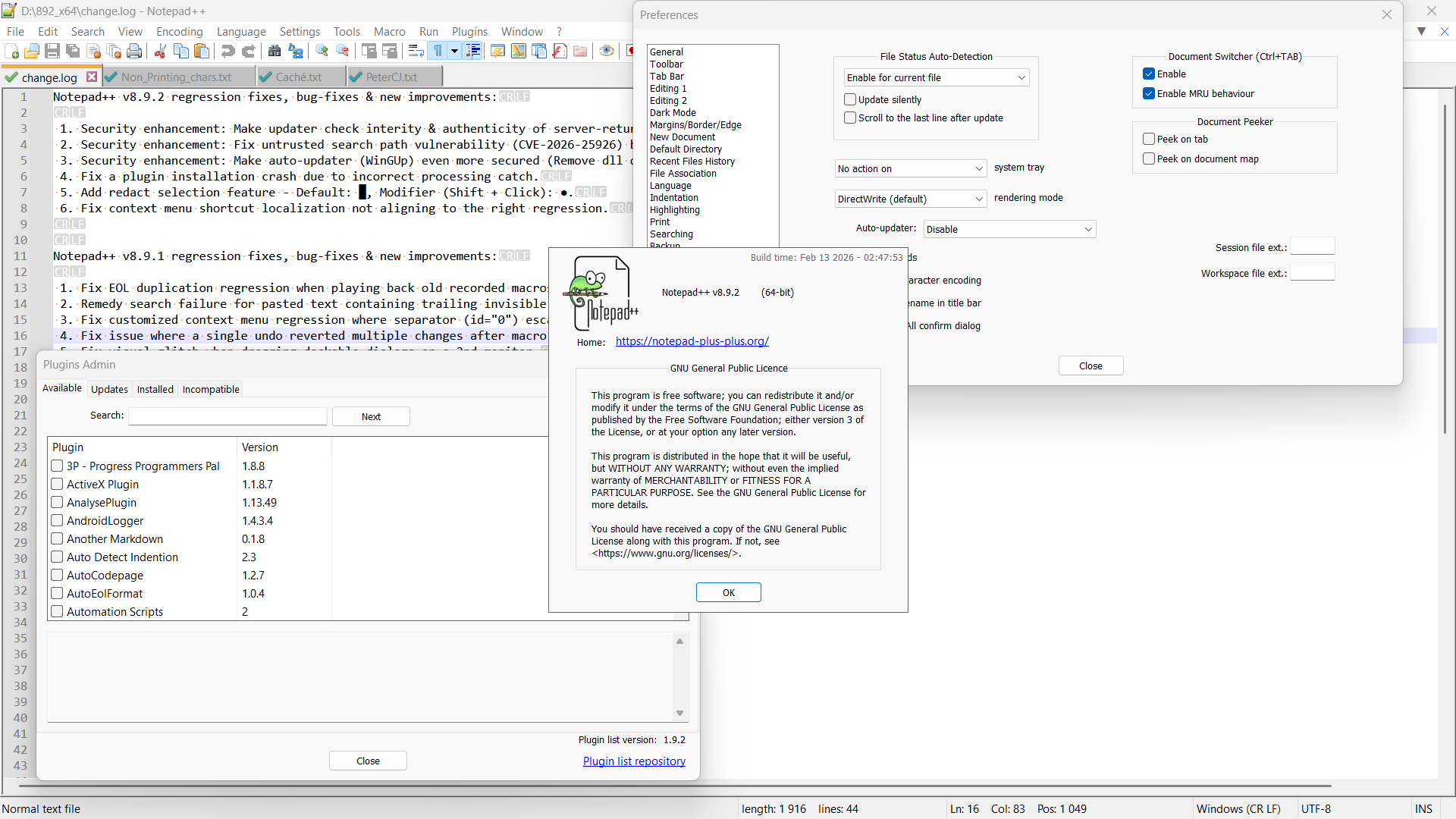

              Hello, @peterjones,
              In this post, you said :
              Did you turn off auto-updater when you installed? Because Plugins Admin requires the auto-updater/gup to work.
              I was rather intrigued by your response !
              So, I’ve just done a test with my fresh portable 8.9.2 release and, although the auto-updater is disabled, I still can open the Plugin Admin dialog !?
              Notepad++ v8.9.2   (64-bit)
              Build time: Feb 13 2026 - 02:47:53
              Scintilla/Lexilla included: 5.5.8/5.4.6
              Boost Regex included: 1_90
              pugixml included: 1.15
              Path: D:\892_x64\notepad++.exe
              Command Line:
              Admin mode: OFF
              Local Conf mode: ON
              Cloud Config: OFF
              Periodic Backup: OFF
              Placeholders: OFF
              Multi-instance Mode: monoInst
              asNotepad: OFF
              Dark Mode: OFF
              Display Info:
                  primary monitor: 1920x1080, scaling 125%
                  visible monitors count: 1
                      0001: Description - Intel(R) Iris(R) Xe Graphics
                      0001: DriverVersion - 32.0.101.7077
              OS Name: Windows 11 Pro (64-bit)
              OS Version: 25H2
              OS Build: 26200.7462
              Current ANSI codepage: 1252
              Plugins:
                  mimeTools (3.1)
                  NppConverter (4.7)
                PeterJones @guy038
                @guy038 said in Notepad++ v8.9.2 Release:
                I didn’t say “disable auto-updater in the Notepad++ preferences”. I said “turn off auto-updater when you installed”. There is a difference. From @xomx’s post in the 8.9 RC announcement discussion:
                vs
                If you uncheck the Plugins Admin and Auto-Updater checkboxes, the gup.exe will not be installed, and Plugins Admin will not work. (I know there was a recent conversation and/or issue and/or PR about also having that remove the old gup.exe if it’s unchecked in the installer, but I cannot find it, and cannot remember whether the removal has been implemented yet or not.)
                Many people are taking the (misguided, IMO) approach that, because of the recent kerfuffle about the updater website hack, they should disable auto-updater even when installing one of the recent, secure Notepad++. So I am assuming that @thoralf-gerbeth was one of those who didn’t understand that the auto-updater that ships with v8.9.2 is highly secure and is safe to include when installing Notepad++ – if my assumption is correct, then turning off those options in the installer would explain why Plugins Admin isn’t working. If that wasn’t uncheckmarked (or they don’t remember), I was going to follow up with asking for directory listings of the updater subdirectory, and checking windows file properties for the Mark of the Web and what have you, but I thought the low-hanging fruit of “you told the Notepad++ to not install the updater and plugins admin” would be a good first question to ask.
