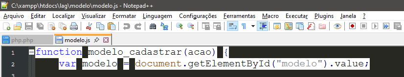

      Is version 8.9.1 of Thema Monokai faulty? How do I fix it?
      The code has a white background; I’ve already uninstalled and reinstalled, but it’s still the same.Screenshot_1.png

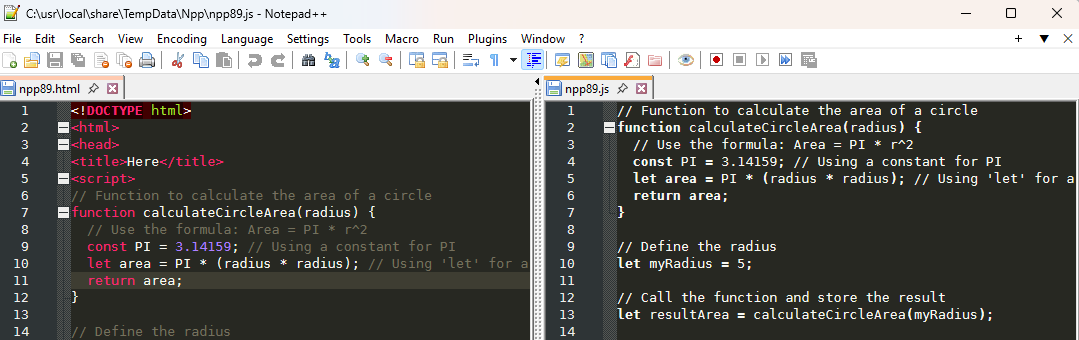

        update 2:
        1. if I start with a fresh v8.8.8 in Light Mode + Monokai (to match your screenshot), then upgrade to v8.8.9 and then to v8.9.1, I can see something akin to your screenshot.
        2. if I start with a fresh v8.8.8 in Light Mode + Monokai, then upgrade to v8.9.0 and then to v8.9.1, I see something different: the *.js appears to have no highlighting, because it’s set to default fg and bg for all styles (but Style Configurator lets you change those):
        3. if I start with a fresh v8.8.8 in Light Mode + Monokai, then upgrade to v8.9.1 directly, then everything works as I expect:
        Given your screenshot, I am very confident that you started at some older version, updated to v8.8.9 and ran at least once (but maybe hadn’t looked at any javascript to notice the problem), then updated again to v8.9.1 and finally saw the problem. If that’s what happened, then the instructions in the FAQ will help you get the theme fixed.

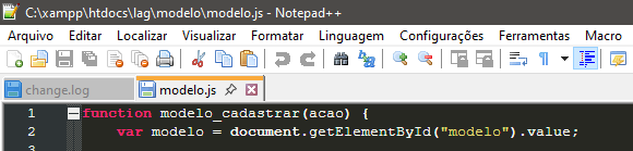

          I had version 8.8.5 and then downloaded 8.8.9 and then 8.9.1. In this last installation, I even deleted the previous installation folder, and the problem still occurred.

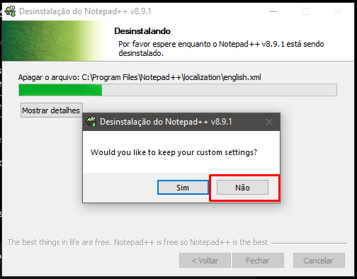

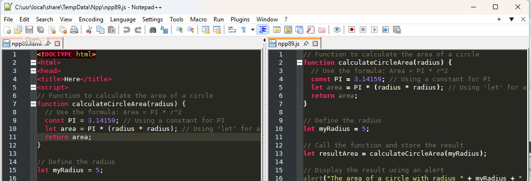

              @PeterJones I managed to do it, I uninstalled it again and when it asked about settings, I answered no, upon startup it was like a completely new installation.Screenshot_1.png nnn.png
              When I started up, I changed the theme and it worked, thank you very much for the tips.
