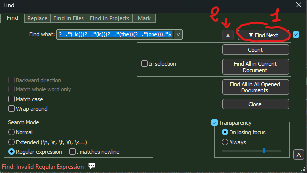

      Hello,
      When search in Find : the regex ^((?=.(Don))(?=.(Ho))(?=.(is))(?=.(the))(?=.(one))).$
      Only 1 is available, not 2 , (1 and 2 defined in the picture above)
      While 2 is available when in search mode : Normal is selected, andnot regular expression,
      Would be nice to have 1 and 2 in regular expression, wouldn’t be ?
      Thanks all for you time !

        Regular expressions don’t work the way you expect in search-backwards mode, so it’s disabled except for advanced users.
        Advanced users can look at the user manual and figure out how to enable regexBackward4PowerUser
        https://npp-user-manual.org/docs/preferences/#preferences-for-advanced-users
        Fred MorantF 2 Replies Last reply Reply Quote 1

            This solution requires a change in config.xml,
            But :
            regexBackward4PowerUser at yes seems to be not an accepted value for my version V8.9.1.
            And :
            observed behavior :
            if config.xml is detected with value not conformed at start then config.xml is not considered and default parameters are used,
            if config.xml is not conformed then config.xml is rewritten at close,
            Reason for considering regexBackward4PowerUser at yes as not a accepted value :
            going backward with a regex requires more computation than going forward, and that value is not accepted in V8.9.1,
            Do you confirm ?

              @Fred-Morant said in "In Find, Regex Search in Current File Limited to "Find Next" Downward Direction Only":
              @PeterJones ,
              As described in the user manual, yes.
              Nope. Works just fine for me in v8.9.1. My guess is you used your active Notepad++ to edit config.xml. But Notepad++ overwrites config.xml when it exits, so you lost your change. The user manual has a few paragraphs at Config Files Details > Editing Configuration Files which explains how to edit most of the Notepad++ configuration files, and then explains the workaround for the config.xml exception.
              Until you properly edit and save the config.xml, Notepad++ will not see your regexBackward4PowerUser="yes"
              Correct. That’s described in more detail in the user manual, where I just linked you.
              Wrong. Don’t believe AI hallucinations. It has nothing to do with computation. Regular expressions parse characters in byte order, and when they do that but go backwards through the bytes for the start of the match, there are quirks that users don’t expect; the Developer got tired of people reporting bugs in the regex engine because they didn’t understand the implications of how backward mode interacts with regular expression parsing, so turned it off by default, but gave power users the ability to turn it back on. That ability has not been taken away, despite the lies the AI is telling you.
              Do you confirm ?
              I confirm it’s nonsense from AI that just says the most likely next words based on context. “Most likely” does not equal “true”.
              Fred MorantF 1 Reply Last reply Reply Quote 0
