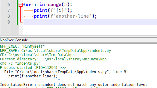

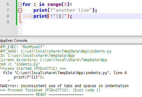

              I would have thought python would give you a line number of where the inconsistency in indentation occurs, so you should easily be able to compare indentation characters before and after the first line mentioned. Quick experiments:
              1. if I have tab on the first indent followed by spaces on the second, it gives the IndentationError:
              2. if I have spaces on the first indent and tab on the second, it gives the TabError:
              And both show me exactly which line the problem is in. You should be able to use that information to fix your code. (Also, Edit > Blank Operations is your friend for making indentation consistent.)

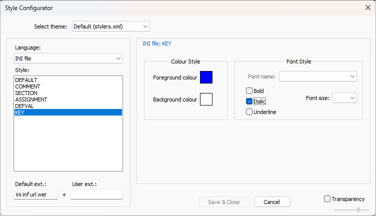

                    the user had outdated themes, which didn’t have the KEY style for either Langage:INI or Language:Properties.
                    Were the preinstalled themes out-of-date, or is that in reference to my custom theme? Because I’ve deleted my custom theme files several times within the past year or two and re-customized them from stock, so I would have expected them to be roughly equal to the ones that come with the application. Either way, as much as the italics were bothering me, I’m glad to see the themes are being updated dynamically now. I’m honestly not sure why I assumed it was a regression, I guess it just seemed visually jarring and I didn’t see a changelog entry about it.
                      PeterJones @Drift91
                      @Drift91 said in Notepad++ v8.9.1 Release:
                      Yes. Only stylers.model.xml and themes\DarkModeDefault.xml were guaranteed to have all updates; all other themes were up to the original theme author and/or other volunteers to keep up to date, and volunteer ever took real ownership of them. That’s why I implemented the new feature, to make sure that themes would never get hopelessly out of date again.
                      The changes involved in this new feature were announced as:
                      • v8.8.9 Announcement, Item 8
                      • v8.9 Announcement, Item 7
                      • v8.9.1 Announcement, Item 10 (above)

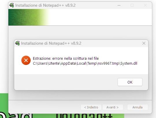

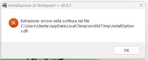

                        Why do I get these errors when I install Notepd++ with both v8.9.2 and v8.9.1?
                          PeterJones @leleganja
                          @leleganja said in Notepad++ v8.9.1 Release:
                          At first glance: it appears that whatever account that is being used to install Notepad++ doesn’t have write-permission to the temp directory that the installer created. That is odd, given that the installer usually asks for Admin privileges to install. But maybe your computer is set up so the Admin account(s) don’t have write permission to the indiviudal user file-areas.
                          Try creating a directory someplace where both your normal user and your admin user have write access, and then temporarily set %TMP% to point to that directory. When you run the installer, it should use that new directory instead, and should (I would think) have write-permission there. (My experiments showed it used the alternate location if I set the %TMP% user variable, but not if I set the %TEMP% variable, so you only need to change %TMP%. If you don’t know how to change that variable: click the START menu, type system environtment which will find the Edit the system environment variables option, which you use; click Environment variables button, then in the User variables section, edit TMP to point to the new directory you created; after doing OK a few times, then you can run the installer, and it should use that directory. When done installing, don’t forget to set TMP back to %USERPROFILE%\AppData\Local\Temp in the same manner.)
