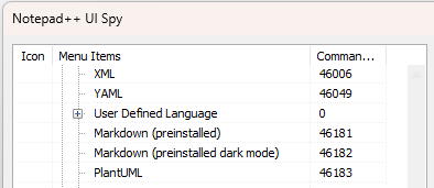

            So, in my current Notepad++ instance, the Language > Markdown (preinstalled) is getting the dynamic commandID=46181. I can determine this easily using the UI Spy plugin:
            So then I call up the PythonScript console, and send the command notepad.menuCommand(46181), and it changes my language from Normal text file (Language > None (Normal Text)) to the UDL Markdown (preinstalled), thus showing that, indeed, you can use already-existing notepad.menuCommand() using an integer command ID to call a UDL’s command ID (or anything else by commandID).
            So if you know the commandID, whether it’s a built-in command or a dynamic command (like a UDL or macro), you can use notepad.menuCommand(). If you don’t already know the commandID, then you cannot use it (but then again, you couldn’t use this “new” function that you claim you want, because this new requested function would also require that you already know the commandID, based on the feature you described).
            So I don’t see why you think it won’t work for you. Because I can use it to call any of the UDL or Macros that I want to call.
            W 1 Reply Last reply Reply Quote 2
              To do this, you need to know about the UI Spy plugin.
              The description for the notepad.menuCommand() command does not mention anything about the UI Spy plugin, or that it can be used to obtain ID numbers for this command. I was unaware of this.
              ID numbers may change in different versions of the program, or their syntax may be added or removed and their order may change, i.e., specifying the number is not universal, but as an option, it is not bad at all.
