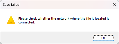

          @xomx Our users have been experiencing this problem in the past week too. They just reported it to me today, and I was able to reproduce the problem in Notepad++. Basically, our users are trying to edit small files (change a value) and then save, and they’re receiving this pop-up dialog:
          I’m able to edit and save this file just fine using other editing tools (UltraEdit, Notepad, VS Code), but our preferred tool is Notepad++.

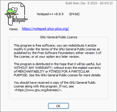

          Most of us are running this version of Notepad++:
          For the past few Notepad++ updates, we’ve had difficulty installing them (due to detected changes or something), so our IT department has had to release these as “Software Center” updates.
          I see there’s an update (to version 8.8.9), so I’m going to try installing that version to see if it fixes anything.

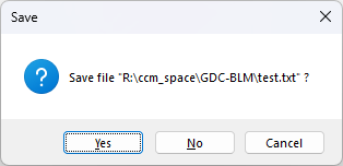

            @xomx I tried updated to version 8.8.9, and I’m still experiencing the same issue:
            I also tried disabling file checking (via Settings->Preferences->MISC.->File Status Auto-Detection, set to Disable), and I’m still getting the same result: my file isn’t saved.

                Ok, but what you’re reporting now doesn’t correspond to your 1st report (?):
                I receive a notification that the file doesn’t exist, and ask me
                if I want to close it without saving or Keep it open
                So this Save failed dlg with the msg “Please check whether the network where the file is located is connected.” changes my POV on this issue and that nppLogNetworkDriveIssue log stuff is no longer needed.
                Futher, from this I think now that it might be an AV-like problem:
                If some security SW or Windows setting blocks the N++ app access to your network storage in question, the outcome can be exactly such N++ dlg.
