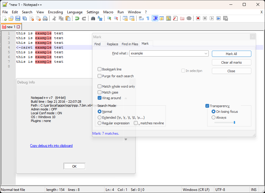

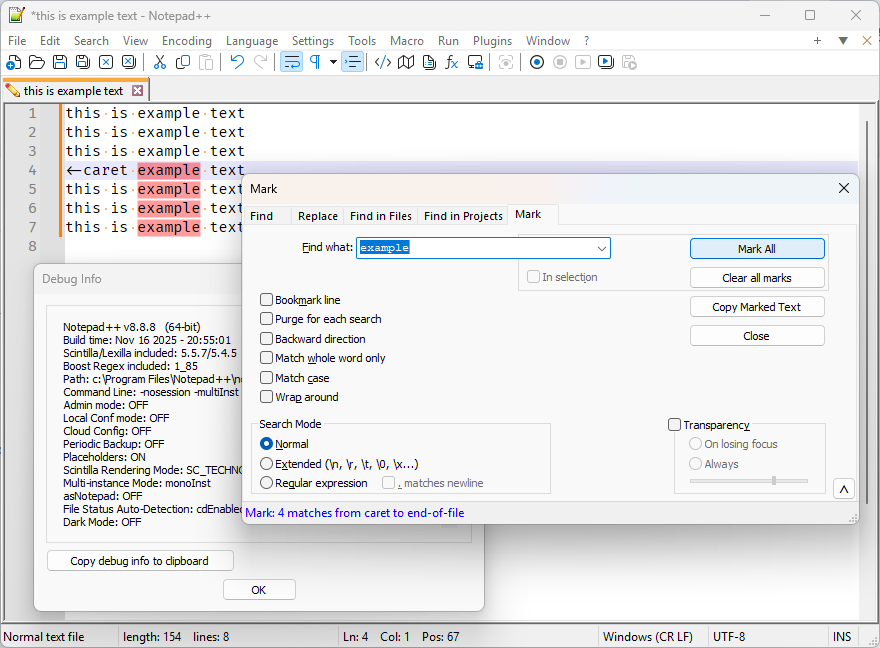

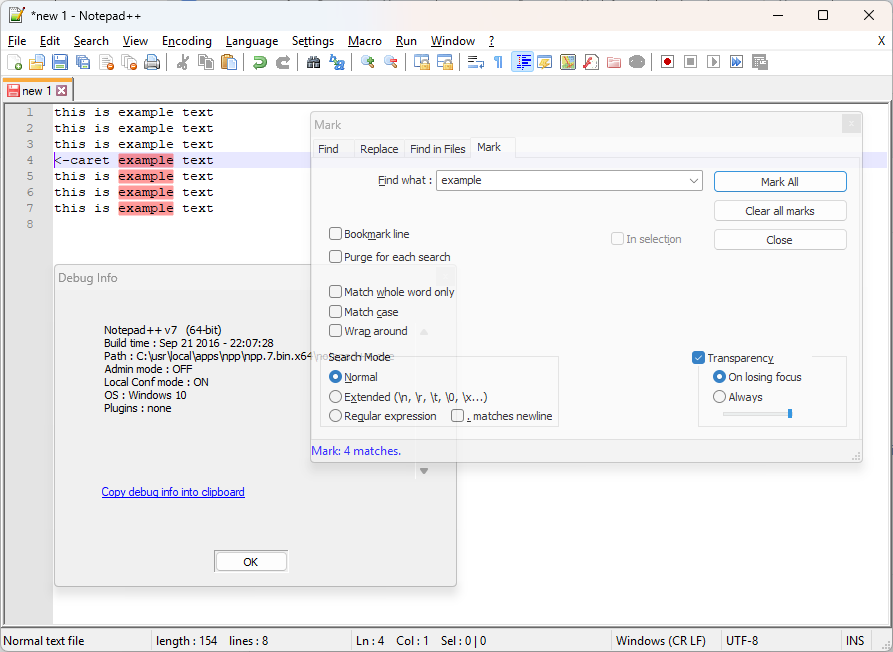

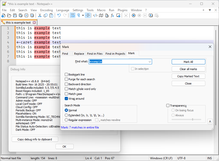

                  Are you sure you didn’t change the “wrap around” checkbox default? Because I am quite certain that if you downloaded a portable copy of Notepad++ from about a decade ago, say v7.0 (available here, from 2016), and set your FIND dialog settings to the same (or equivalent), they will work the same.
                  That is:
                  condition v7.0 v8.8.8
                  ☑ Wrap Around (on) 1dd875ca-21ed-4387-8f0b-a2ac7c0c7002-image.png 4cdf0eb8-e935-46c0-9dbb-ed3125316dbd-image.png
                  ☐ Wrap Around (off) 6bad231b-fa53-4058-9390-66b15b92ec70-image.png 5996dc12-6190-47ad-af5f-9376fe56875c-image.png
                  They behaved identically when given the same settings. If you don’t trust my experiment, you can download v7.0 yourself, and see it’s been the same behavior for years.
                  (I used Mark, because that’s easiest to show what the results were.
                  Data for copy paste:
                  this is example text
                  <-caret example text
                  FIND WHAT = example
                  SEARCH MODE = Normal
                  WRAP AROUND = checkbox or not, as shown in table above.
                  Action = MARK ALL
