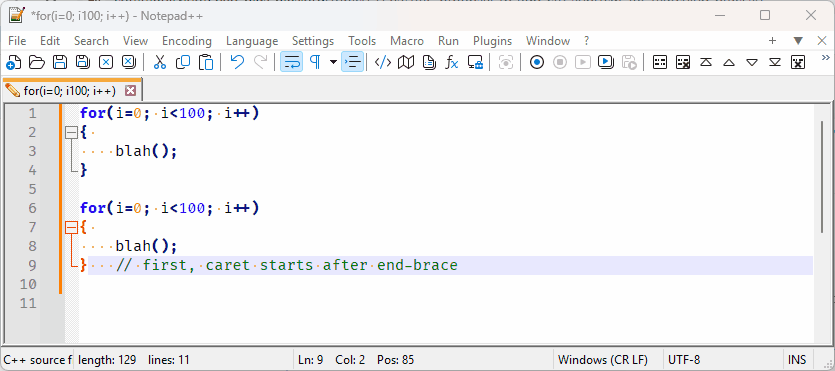

        At the closing brace }, Ctrl + B moves to before the opening brace {, without highlighting it.
        That is not what I see. If I have the caret just before or just after the closing brace, both opening and closing braces are highlighted. And when I do Ctrl+B to go to the opening brace, the caret is just before the initial brace, and both braces are still highlighted.
        So I don’t think there needs to be a feature request.
