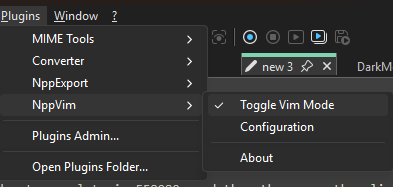

                  I just grabbed a copy on a portable N++ to experiment. So yes, when you first install NppVim, it starts Notepad++ in “Vim” mode. So, just in Vim, in order to add text, you need to use the a (append) or i (insert) or o (add new line) or the capital versions thereof. NppVim hijacks the status bar, and will list --NORMAL-- when it’s in the mode that accepts the hjkl navigation keys (and similar) or --INSERT-- when it’s in the insert/append mode. It’s only when you are in --INSERT-- mode that the Notepad++ INS/OVR INS-key toggle has any meaning, and it’s only when you are --INSERT-- mode that you can type text in the editor.
                  vs
                  and now, just a few seconds of using Vim-style editing commands, just to prove that’s how it works, my brain has already reverted to vi keys, and I tried to edit this post with vi keystrokes. so thanks for that 😜
                  update:
                  If you don’t want to have to use the Vim keys with that plugin, you can use Plugins > NppVim > Toggle Vim Mode to toggle off that plugin’s features temporarily.
                  So, as of now, my working theory is that @Salam-Elias had the NppVim plugin installed without understanding the implications, and the problems with typing, mentioned in the original post, were 100% due to user error and that plugin.
