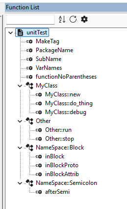

      The expectations are that it would need to have the same unitTest results in the automated process, which looks like the following FL in the GUI:

              Hum… Peter, I did not understand how the unitTest.expected.result is supposed to work !
              Sorry for being such a beginner, in this regard. I tried to rename this file as unitTest.pl. without any improvement ! The Function List panel is desperately empty, after the unitTest.pl name :-((
              … And I cannot get your snapshot showing a functional Function List panel, with name UnitTest. What obvious thing am I forgetting ?
                unitTest.expected.result is the JSON file that Notepad++ uses during its automated tests to check the result (User Manual > Function List > Unit Test File Is Absent describes how to manually run).
                But the unitTest.expected.result is not the file you should use to test the Perl lexer. The unitTest file is Perl source code, and is the file that Notepad++ needs to load.
                If you were trying to get a FunctionList on the unitTest.expected.result, that’s not going to happen, which probably explains the rest of your questions.
                For the unitTest file, which is Perl code, it has a perl shebang line, so Notepad++ can auto-recognize it. But if, for some strange reason it doesn’t, renaming unitTest to unitTest.pl or manually choosing Language > P > Perl should be sufficient to get FunctionList to display (maybe with clicking the REFRESH button on the FL panel)

                  I re-started N++, each time, with current tab = unitTest.txt and opening the View > Function List feature, I did verify that :
                  • The Function List panel with perl_886 was immediate but quite incomplete
                  • The Function List panel with perl_887 was correct but with a slight delay at opening time
                  • The Function List panel with perl_NEW was correct and with no delay at all !
