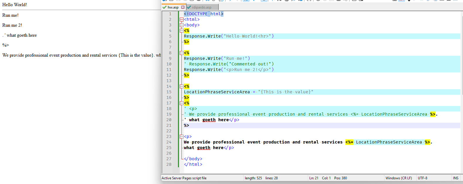

                        For example, I spun up the IIS features on my Win11 machine.
                        If I use:
                        <!DOCTYPE html>
                        <html>
                        <body>
                        Response.Write("Hello World!<hr>")
                        Response.Write("Run me!")
                        ' Response.Write("Commented out!")
                        Response.Write("<p>Run me 2!</p>")
                        LocationPhraseServiceArea = "{This is the value}"
                        ' <p>
                        ' We provide professional event production and rental services <%= LocationPhraseServiceArea %>.
                        ' what goeth here</p>
                        <p>
                        what goeth here</p>
                        </body>
                        </html>
                        … which is the best interpretation I can come up with for your “later in the page content:” code snippet, plus some extra to prove that IIS ASP code is working around it, I get:
                        The Notepad++ highlighting seems to match what’s displayed when I look at what the server shows – that is, the %> at the end does close the ASP wrapper, and it goes back to being raw HTML, which the browser renders.
