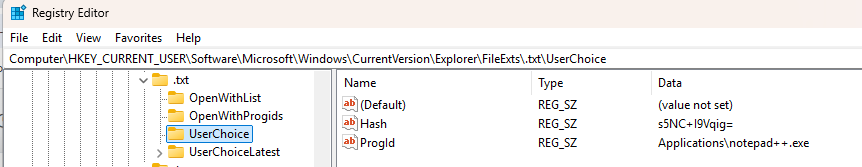

                  • Run regedit.exe and paste in that key name HKCU\Software\Microsoft\Windows\CurrentVersion\Explorer\FileExts\ into the “address bar” of the regedit window:
                    • I navigated to the UserChoice key to show that Applications\notepad++.exe is chosen, showing that Notepad++ is my default app for .txt files

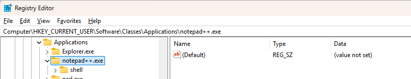

                  • Go to HKCU\Software\Classes\Applications\ , and you should see notepad++.exe as one of the keys
                    • Right Click on notepad++.exe and choose to create a New > Key called DefaultIcon (no space)

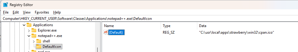

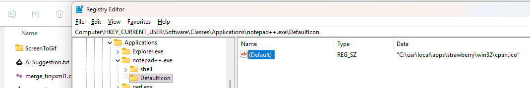

                    • On the (Default) in the right panel, insert the path to the ICO file: 809d369f-f720-44df-b44b-d90cdc2dd48e-image.png
                      • This was just an example icon that I knew where it was on my PC.

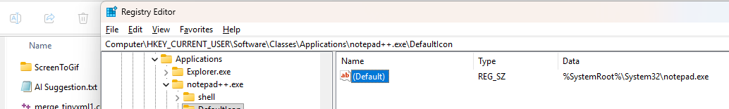

                      • You could also use something like the MS Windows notepad.exe’s icon, using %SystemRoot%\System32\notepad.exe as the (Default) value there

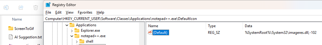

                      • or %SystemRoot%\System32\imageres.dll,-102 will use icon #102 from imageres.dll, which for my version of imageres.dll is another “text file” icon.

                  • Screenshots with it working for various of the above icons:
                    • cpan.ico: f18268c3-8204-495d-add6-07e5cc6001b9-image.png
                    • %SystemRoot%\System32\notepad.exe: 5ab06335-bd2f-4afd-902a-d9fccbf3a062-image.png
                    • %SystemRoot%\System32\imageres.dll,-102: daa0447c-b90f-419b-856f-dc4c19395642-image.png
