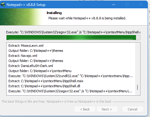

      quick note about this update… for some reason the exe installer got stuck during the regsvr32 phase…
      for about 30-60 seconds… then it finally completed… and exited…
      I am running Windows 11 PRO v25H2 build 26200.7171
      Rolf WittR 1 Reply Last reply Reply Quote 0
      • Rolf WittR
        Rolf Witt @MelchiorGaspar
        @MelchiorGaspar
        Looks like a Windows 11 bug. When an installer calls regsrv32.exe, dllhost.exe crashes. This also happens with other installers. However, I don’t know where to report this error to Microsoft.
        The ‘good news’ is that apart from the extended installation time, there don’t seem to be any other consequences.

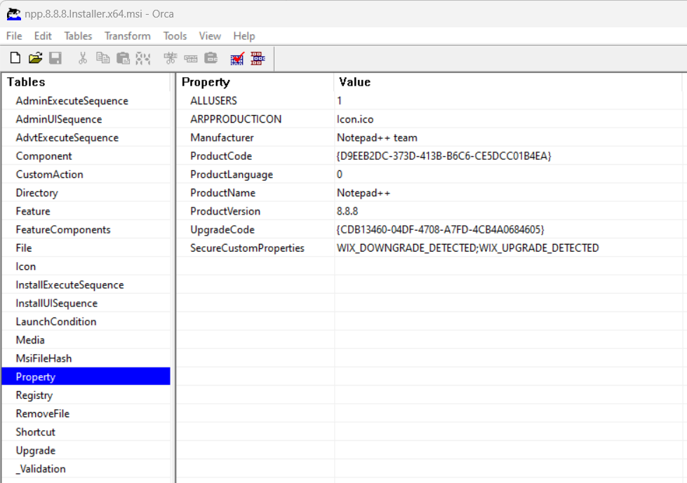

              • Lukas MayrL
                Lukas Mayr
                For the .exe installer there are a few command line options as detailed in Command Line Arguments | Notepad++ User Manual
                At the moment i am unable to find those for the new .msi installer.
                Parsing the installer with Orca shows no proberties that could be changed into that direction and also replacing the .exe options in .msi writing doesn’t seem to work either.
                i.e. instead of /noUpdater a noUpdater=“1”
                If I am missing something here, I would be glad to be pointed in the right direction, or perhaps the information if the options will be added in in future releases

                  @Daniel-Richter
                  where can i find the install switches for the silent installation with the new msi-installer?
                  If you use MSI for IT deployment, there must be a option in SCCM, or other MS deployment tools, or am I missing somethings?
                  @Lukas-Mayr
                  I have no experience in IT deployment, but if I understand correctly, MSI is the standard installer format of MS Windows, and you should check the parameters of MSI in MS deployment document.

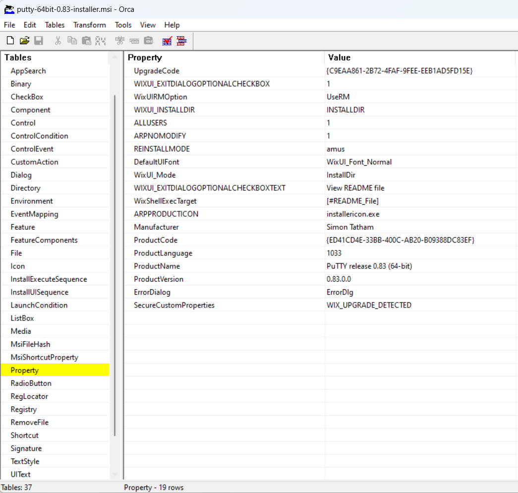

                      • Lukas MayrL
                        Lukas Mayr @PeterJones
                        Thank you for adding the MSI-Installer section.
                        The usual switches for silent/passive/… installation work just fine out of the box with the .msi.
                        @donho
                        For the .exe installer there are the Notepad++ -specific options, like /noUpdater
                        These options seem to be missing from the .msi package
                        For instance: in the putty installer you have the option to set your own install-directory by changing the property of INSTALLDIR
                        msiexec /i "putty-64bit-0.83-installer.msi" /q INSTALLDIR="C:\Tools"
                        Those Options seem to not yet exist in the npp-msi installer
                        donhoD 2 Replies Last reply Reply Quote 0
                        • donhoD
                          donho @Lukas Mayr
                          @Lukas-Mayr said in Notepad++ 8.8.8 release:
                          OK, I will add this option for the next release.
