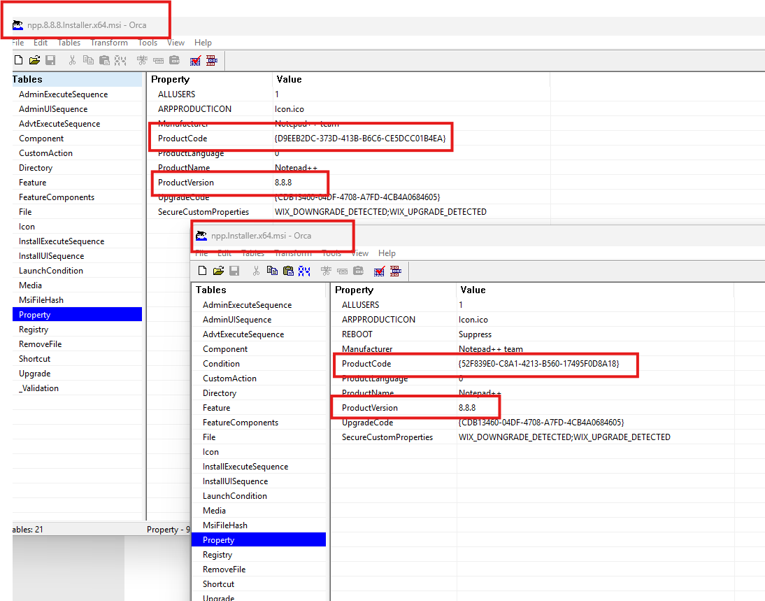

                  • GarrettG
                    Garrett
                    I am switching to the msi installer from exe installer for our deployments. I have noticed in my initial testing that using the .msi installer does not remove the previous version (.exe installed) on the device.
                    I have also noticed that there are two separate .msi installers for v8.8.8 with different Product Codes https://github.com/notepad-plus-plus/notepad-plus-plus/releases/download/v8.8.8/npp.8.8.8.Installer.x64.msi and https://download.notepad-plus-plus.org/MISC/npp.Installer.x64.msi
                    Do I need to add to my PSADT scripts to uninstall previous versions in my Pre-Install block, or should the .msi (as intended) remove earlier versions? In addition will the duplicate installers be consolidated to a new single Product Code in an updated installer?
                    Thank you for giving us the .msi for enterprise deployments, I’m looking forward to using them over the .exe installers.
                    GarrettG 1 Reply Last reply Reply Quote 0

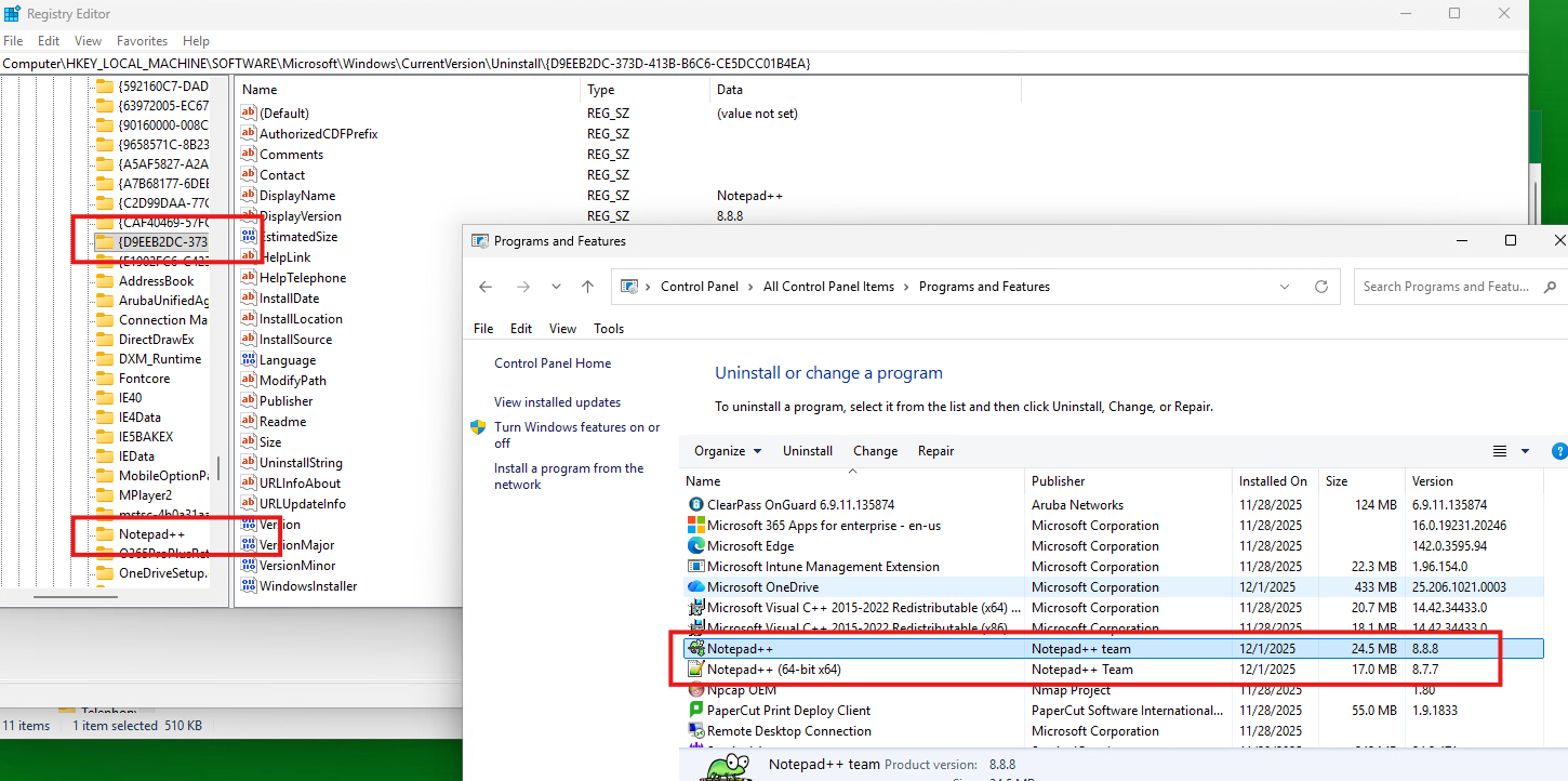

                                  • DustyMarieD
                                    DustyMarie
                                    I have noticed going from the executable to the MSI, when installing from Intune, that remnents of the old version get left behind. 2025-12-18_12-23-57.png
                                    Also, when we deployed 8.8.8 and the program updates to 8.8.9 that it doesn’t clean up and you see two versions.2025-12-18_12-06-12.png
                                    These are registry entries which should have been cleaned up in both events. I probably should have stuck with the original executable. 😕
                                    • DustyMarieD
                                      DustyMarie @Andrea Gaviraghi
                                      @Andrea-Gaviraghi More results from allowing updates on MSI package. The 8.8.8 MSI pulls the update from Notepad++ and it then installs the 8.8.9 executable. So again, the computer shows 2 installs, when only the newest is really installed. This process should be a lot cleaner…
