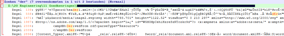

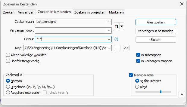

      I try to find words in a docx file, but have 0 results. I think my search parameters are OK:
      I deleted already the config.xml, but it doesn’t work. The same to my collegue
      The result for a small word is some strange code where the word is found:
      what could be wrong?

        @Rick-Kosters said in can't find words with search in files:
        See the FAQ: Why does my .docx file look like junk in Notepad++
        Rick KostersR 1 Reply Last reply Reply Quote 1
        • pbarneyP
          pbarney @Rick Kosters
          @Rick-Kosters, .docx files are compressed files, so unless you’re able to uncompress them first, you’ll never be able to use a third-party program to search them.
          For what it’s worth, 7-ZIP, Pkzip, WinZip, WinRAR, etc are all capable of opening those files. If you do unzip them, you’ll find a number of files and folders. What you’re looking for is most likely in word\document.xml.
