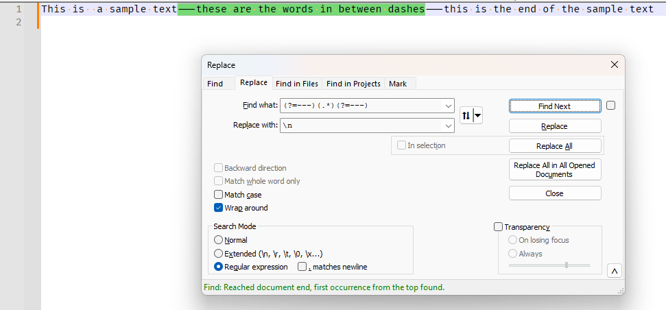

      To accomplish this, I have tried using the following Find/Replace expressions and settings
      • Find What = (?=---)(.*)(?=---)
      • Replace With = \n
      • Search Mode = REGULAR EXPRESSION
      • Dot Matches Newline = NOT CHECKED

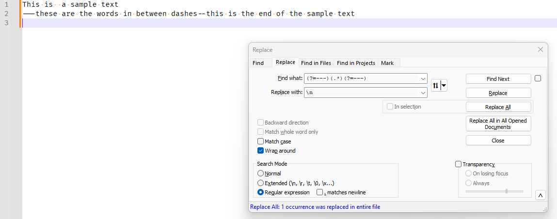

      I can only get it to look like this:
      This is a sample text
      —these are the words in between dashes–this is the end of the sample text

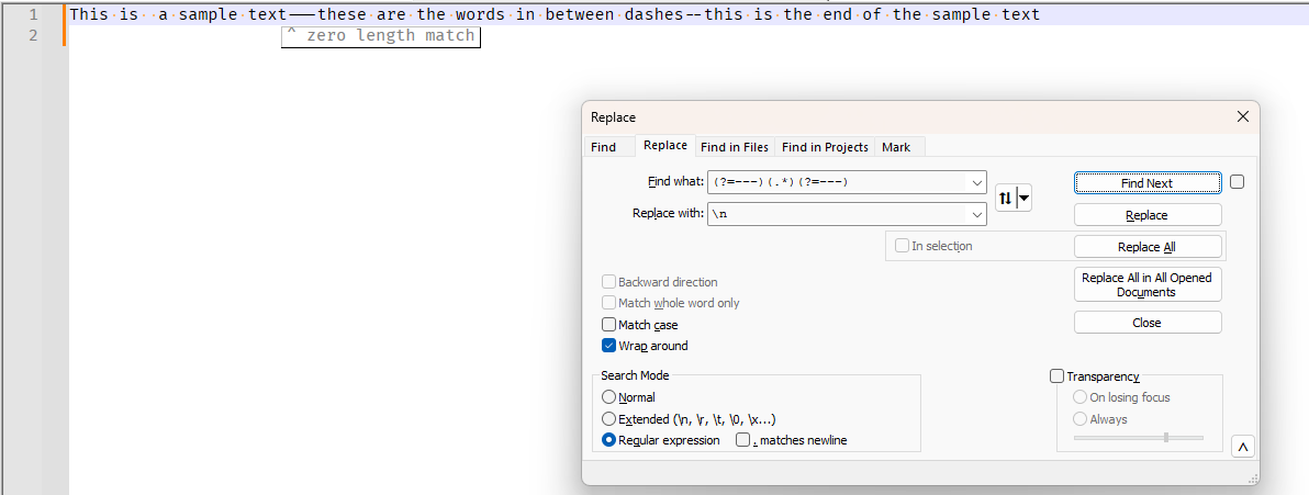

        In your Find What, the (?=---) says “the next three characters must be hypens, but DON’T SELECT THEM YET OR MOVE THE CURSOR” – so that puts the search cursor at the beginning of the ---these are the words in between dashes---. Then (.*) says “grab 0 or more of any type of character…”. Then the second (?=---) says "… until you reach a point where the next three characters are hyphens, but don’t select those final three hyphens
        In your example text, there is only one triple-hyphen; the second set of dashes are just a double hyphen. This means that the (.*)(?=---) matches 0 characters – because if the .* doesn’t “eat up” any characters, then the lookahead will find the original triple-hyphen as the matching point. So you’ve got a 0-width selection just before the first and only ---.
        Here’s what it matches, using Find Next instead of Replace, so you can see the “selection” (which it indicates with ^ zero length match):
        Then your replacement says “replace everything that was matched” (ie, the emptiness just before the ---) “with a LF sequence”, which gives you:

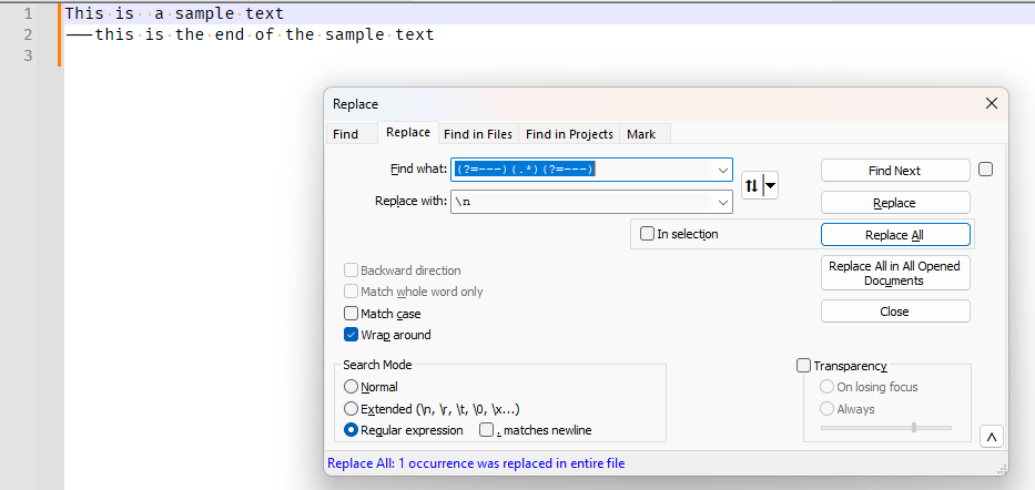

        Please note: if your sample text had the text you thought it had three hyphens at the end of the phrase:
        This is  a sample text---these are the words in between dashes---this is the end of the sample text
        then your regex would have selected the first three hyphens, and the words in between:
        And then the replace would have replaced all that selected text with a newline,
        … which still wouldn’t be what you want.

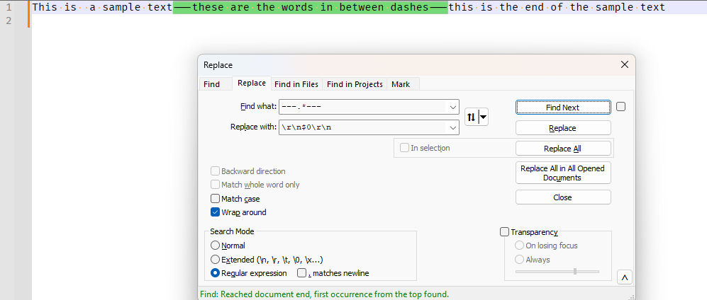

        Based on your “how I would like it to look”, I think what you really intended to do was to put a newline before the first --- and another newline after the second --- (if there really were a second ---. To do that, I would do the following:
        • Find What: ---.*---
        • Replace With: \r\n$0\r\n
        • Search Mode: Regular Expression
        • . matches newline not checked
        The Find What is simpler: you want to match everything, including the hyphens, so no reason for the lookaheads and groups.
        In the Replace With, I am using $0 to say “include the contents of everything that was matched”, so that your original text isn’t lost. I am also using \r\n instead of just \n, because I am assuming you really have Windows-style newline (CRLF), not Unix/Linux newlines (LF only). If you actually do have Linux LF only, then Replace With: \n$0\n

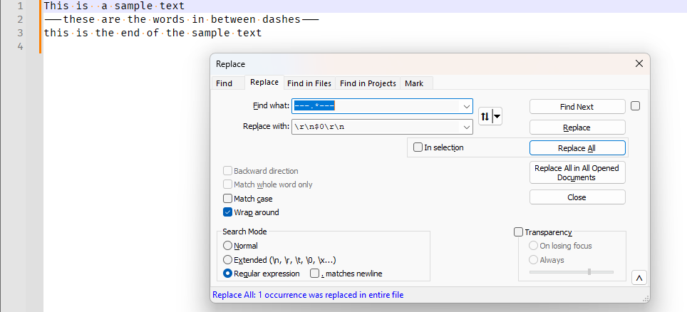

        Results:
        FIND NEXT =>
        REPLACE ALL =>
        But my regex will not work for your original single-line, because that one only has two hyphens, not three, so it will find no matches and do no replacements.
