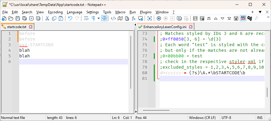

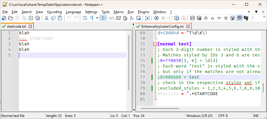

        Second (and this one I’m more confident of): you could use the UDL feature of Notepad++ in combination with the EnhanceAnyLexer plugin. That plugin defines its rules based on the lexer language (whether it’s a builtin language like Python or a UDL for your custom needs), and doesn’t actually care whether the UDL has any keywords (though you might want to define STARTCODE as a keyword). But with that plugin, you can define a foreground color
        [normal text]
        0x777777 = ^.*STARTCODE
        [exact name of UDL]
        (My screenshot shows it in the [normal text] section, since I didn’t want to create a new UDL for this example, but if you’ve got a UDL called exact name of UDL, then the second section in my post would do it.)
        I had seen your Issue earlier, so already had a mental plan of what I’d say if you ever posted here. But while I was typing up this reply, I realized that maybe my first interpretation was wrong. If you had the text,
        before
        before
        xyz STARTCODE
        blah
        blah
        were you intending the gray text to just be the xyz STARTCODE, or did you want to also gray out the before lines?
        If the latter, then your EnhanceAnyLexer line would be more like,
        0xcccccc = (?s)\A.*\bSTARTCODE\b
        (Either way, make sure to not set the excluded_styles = #, #, .... unless you want to exclude your regex from working when inside one of the other UDL styles. It’s more powerful to be able to restrict it, but for new users, it usually makes more sense to just leave that option out.)
        I hope one of these is what you want.

          Sorry I wasn’t clear enough: I wanted to say that I want to change the background color for all the lines before that line containing the word STARTCODE, so your second answer is what I need.
          However, it works but once I close the EnhanceAnyLexerConfig.ini or I simply start editing the “startcode.txt” file, the graying is gone for those lines before STARTCODE
          And another question is: how can I change the background color instead of the ink color?
            PeterJones @SuperCPU
            Once you save the config, assuming you used [normal text], then the next time you open a text file, it will use that rule. So if you close startcode.txt and reopen it, it should work right.
            EnhanceAnyLexer only affects foreground colors, not background colors. Sorry.
            SuperCPUS 1 Reply Last reply Reply Quote 1

                    Ekopalypse @SuperCPU
                    @SuperCPU said in How to set a different background color for the text before a certain line?:
                    but once I start editing the startcode.txt
                    The EnhanceAnyLexer plugin only processes visible lines.
                    Therefore, if a regex is used that affects a match outside this range,
                    it will be ignored unless the offset parameter is set in the configuration.
                    The reason for this is that the plugin reacts to changes in the text or position and repeatedly executes the respective regular expressions.
                    The more lines that need to be taken into account, the longer this takes.

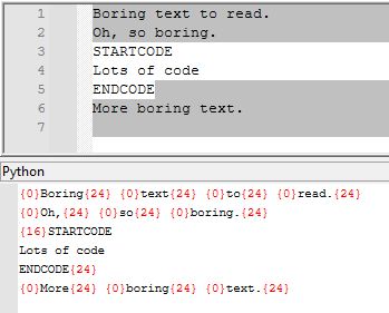

                      May need to restart Notepad++ after setup of the UDL and the Lua code. Once the editor is ready and the document is active, then set the language to the UDL.
                      Viewed with the default theme:
                      The Python console shows the Style IDs in red so you know where the 0, 16 and 24 originate from.
