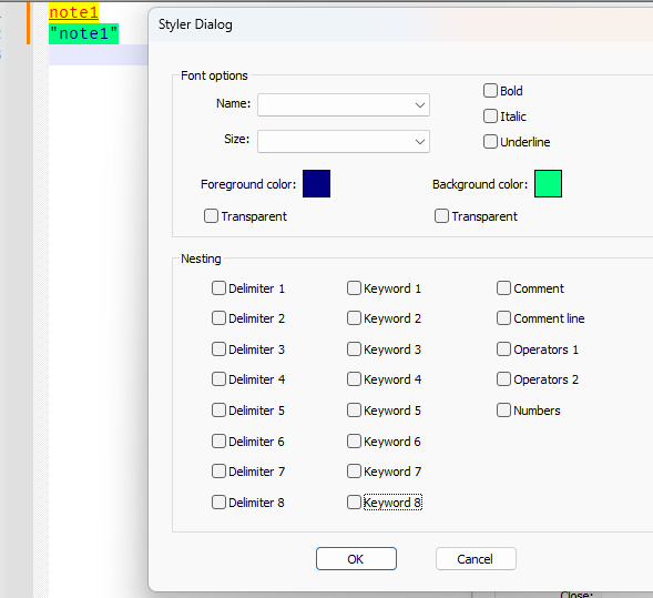

        If you set " as the open and close for a delimiter pair, and set that Delimiter # > Styler to allow nesting of the Keywords1 - Keywords8:
        if you don’t allow nesting then everything inside the quotes is colored as part of the quote:

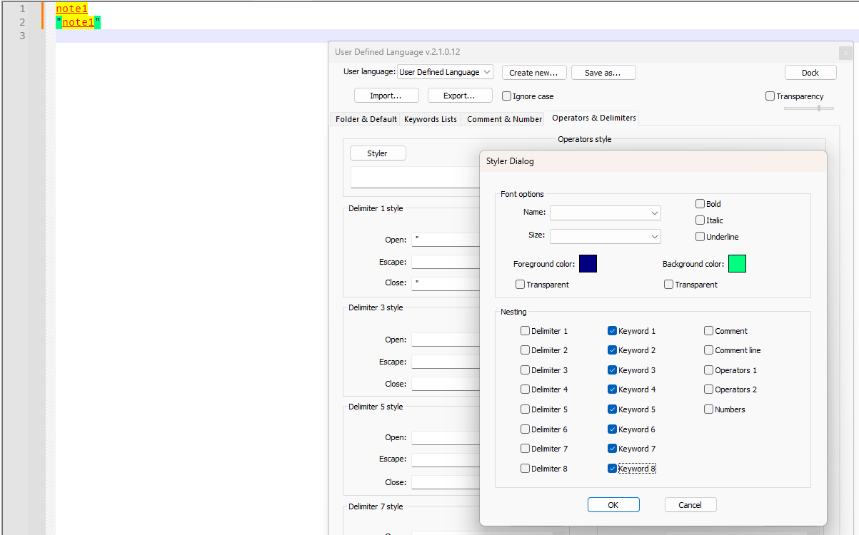

        So, with
        • Ignore Case on
        • Keywords1 set to note0 note1 note2 note3 note4
        • Delimiter 1 set to open:" close:" and allowing nesting of keywords# inside
        I can get the following, which I believe is what you want:
