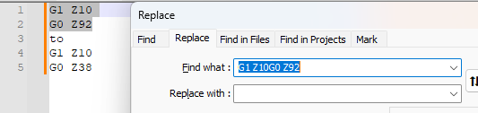

            Have you? Because that doesn’t work for me. I just tried, both in an older (v8.4.6 portable) and in a newer copy (8.8.4 installed) and in the newest (v8.8,5 portable), and none did what you claim. I cannot recall it ever working where pasting multi-line works like that (or at least, it hasn’t for a long time)
            Instead, if I copy from G1 to Z92 in that two-line file, and paste it into the FIND or REPLACE fields, it just lists the G1 Z10, without including the second line, and if I do the search, it really only matches a single line, not both lines.
            If I highlight G1 to Z92, then do Ctrl+H to bring up replacement, it populates with what looks like the two lines smooshed together (but the CRLF newline is really invisible there):

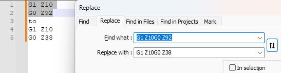

            So @Brent-Ficker could follow the idea behind that:
            1. Highlight the replacement version (G1 to Z38)
            2. Ctrl+H to populate the FIND WHAT in the Replace dialog with the smooshed version
            3. click the 1a716695-9527-4a7e-94d2-6d676b2d21e0-image.png to move it to the REPLACE WITH
            4. highlight the search version (G1 to Z92) and Ctrl+H again, to bring it into the FIND WHAT:
            5. Now Replace or Replace All will do the two-line replacement…

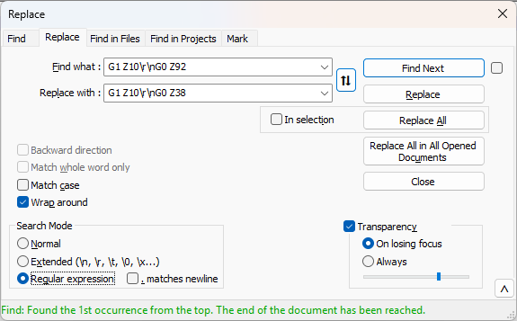

            Instead, use Search Mode = Regular Expression, and use the \r\n nomenclature for doing the CRLF line ending. So FIND WHAT = G1 Z10\r\nG0 Z92 and REPLACE WITH = G1 Z10\r\nG0 Z38
            That allows @Brent-Ficker to customize the search and replacement for any such replacement, even if they don’t have a copy of the replacement text already in the document.

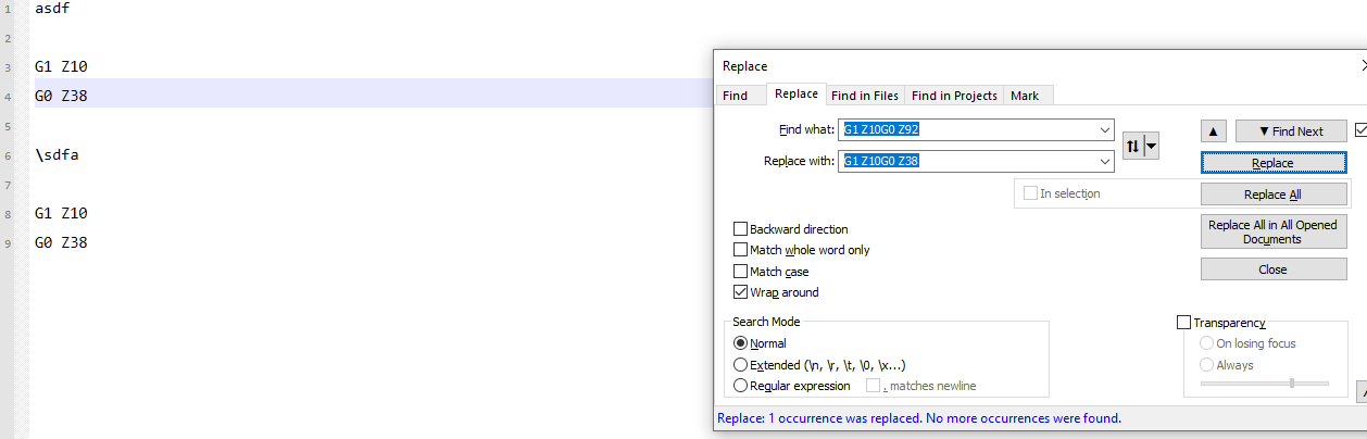

                  It looks like the reason it works for me is that I’m using the LF EOL, not CR LF as typical in Windows.
                  Cheers
                  P.S. @Brent-Ficker if you’re not familiar at all with regex, the “Extended” mode setting would work for this particular problem too, to gently introduce you to such things.
