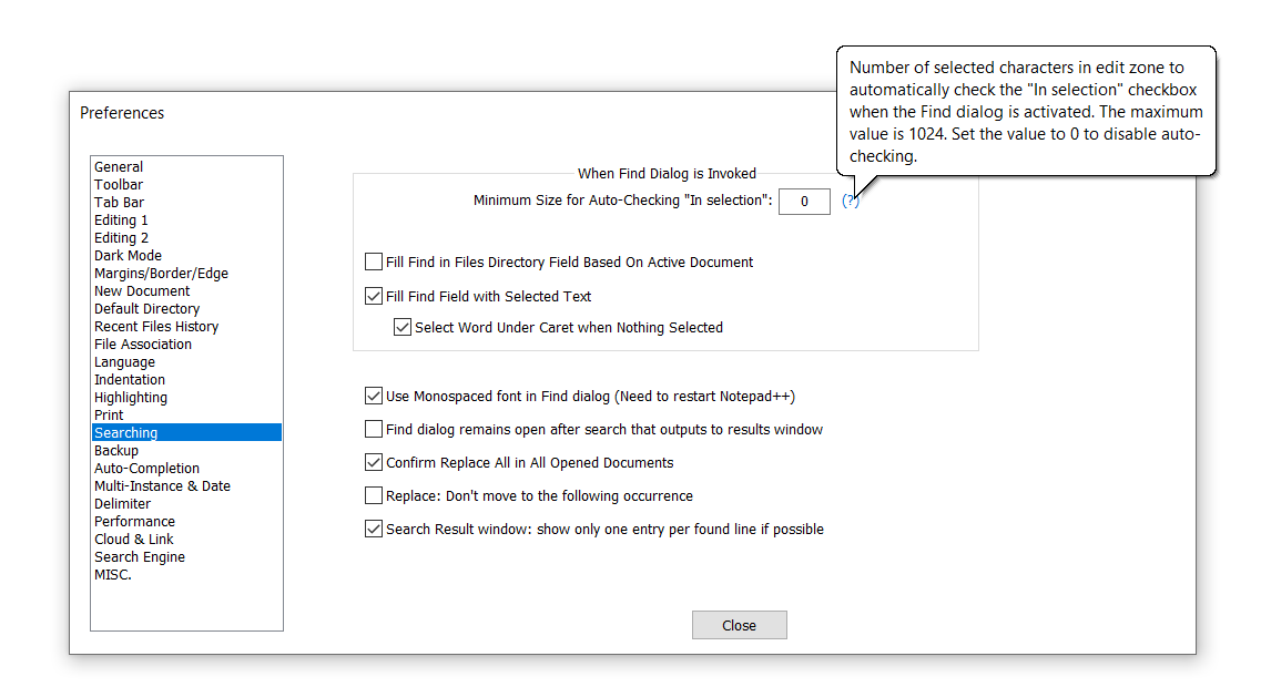

          I assume that :
          • The Maximum Size for Auto-Checking "In selection", in Settings > Preferences... > Searching, is set to 0
          • The Search mode of the Find dialog is set to Normal
          • All other options of the Find dialog are unckecked
          If I chose these preferences about searching :
          And if I consider the text below :

              The problem when selecting 1025+ characters as a pre-step is because of this line of code:
              https://github.com/notepad-plus-plus/notepad-plus-plus/blob/dab30de9c677165fcd7f9cc045b4529ab0c4f7b7/PowerEditor/src/NppCommands.cpp#L1380
              FINDREPLACE_INSELECTION_THRESHOLD_DEFAULT is set to 1024, here:
              https://github.com/notepad-plus-plus/notepad-plus-plus/blob/dab30de9c677165fcd7f9cc045b4529ab0c4f7b7/PowerEditor/src/Parameters.h#L167
              Probably the check against that constant should not be made if Maximum Size for Auto-Checking "In selection", in Settings > Preferences… > Searching, is set to 0.
