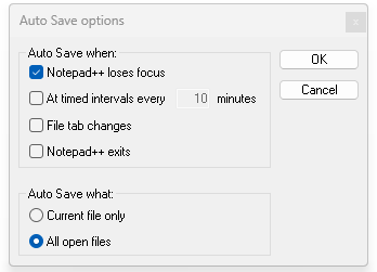

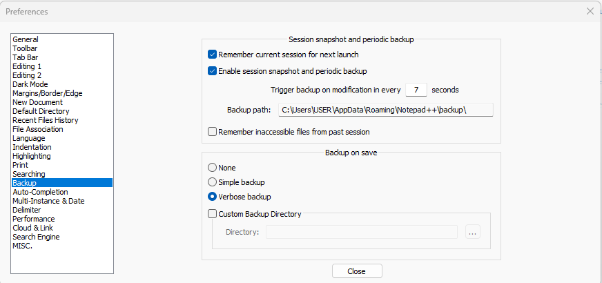

      TL;DR: Today I installed AutoSave with settings “loses focus” & “All open files”. Question: What do you recommend for Settings » Preferences » Backup? I’m thinking I should deselect everything, but I’m not sure. Thanks!

      My current settings:
      and:

        Today I searched for a file and found only a .bak file, which I cannot open, probably because it doesn’t have anything in it (?). It is not in %AppData%\Notepad++\backup\ .
        Right. Because the %AppData%\Notepad++\backup\ is used for the session snapshot files, which don’t use the .bak extension; the .bak extension is only used for the backup-on-save options. The backup-on-save go in the same directory as the file (or in a subdirectory relative to the file, depending on settings). This is described in both the FAQ and the User Manual.
        The most recent file in %AppData%\Notepad++\backup\ is from May (three months ago)
        That’s because that folder is only for the file tracking unsaved changes in the snapshot/periodic mode. As the FAQ descrbes, the instant you hit SAVE on a file, the snapshot/periodic file is deleted from the backup\ folder. This is described in the Built-in “Enable Session Snapshot and Periodic Backup” Feature of the FAQ, with more details for the particulars in Named Files and Unnamed Files sections just below it.
        If you’ve got a file from May still in that directory, then either
        • you’ve had snapshot/periodic enabled that whole time, and you’ve had a file with unsaved changes that’s never been saved in the past 3 months (unlikely),
        • or (more likely), in May, you had snapshot/periodic enabled, and had unsaved changes in one file; then you turned off snapshot/periodic (which means that Notepad++ stops its auto-save to the backup folder, but doesn’t actually delete any active snapshots currently stored)
        • or you reset the session or there was a crash/unexpected-reboot, which left Notepad++ not noticing that it hadn’t closed that file

        I leave ☑ Remember current session for next launch checkmarked, because that allows Notepad++ to remember which files were open last time – it doesn’t do the “unsaved files” tracking, but I don’t need that; but I like Notepad++ always opening whatever files I happened to last be editing.
        So I usually use AutoSave plugin with every 10 minutes (plus often one or both of lose-focus and/or change-tabs), set for All Open Files. In the builtin backup preferences, I remember the session, but don’t do the snapshot/periodic or the backup-on-save.
