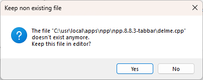

          With two network files open, if the network temporarily disappears, the first popup comes, it says
          1. If you say No, then Notepad++ believes you, and closes that file. Then it checks the next file, and sees that it, too, is missing. Maybe it would be better if it polled all the files, and gave you a Yes/No/YesToAll/NoToAll choice, but that’s not the way it’s currently implemented. And this, at least, makes you think about your answer for each file – maybe you want something different on each, and you’d get upset if you accidentally chose XToAll.
          2. If you say Yes, then Notepad++ will keep that file, and check occasionally to see if the network connection is back. Then it will see the next file is gone, too, and prompt again.
            • If you want to keep your blood pressure down, then click Yes, not No, to the each of these.

          (Note: while writing this up with two files called delme.cpp and second.cpp, I simulated a “network problem” by running a cmd.exe window in those files’ directory, running ren delme.cpp x_delme.cpp & ren second.cpp x_second.cpp to make the “network disconnect” and ren x_delme.cpp delme.cpp & ren x_second.cpp second.cpp to make the “network reconnect”)
