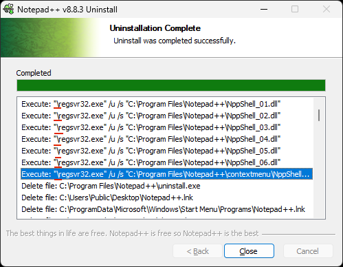

          There is a checkbox to check to stop the log page from automatically closing. If the log closed then the extraction of files would be basically finished. I can only suggest checking system event logs and program logs that may scan and block processes. More details may help to expose the source of the issue.
          The v8.8.3 installer may work like previous versions though the uninstaller appears to be bugged regarding the unregistering of the context menu extension as I found today viewing the log.

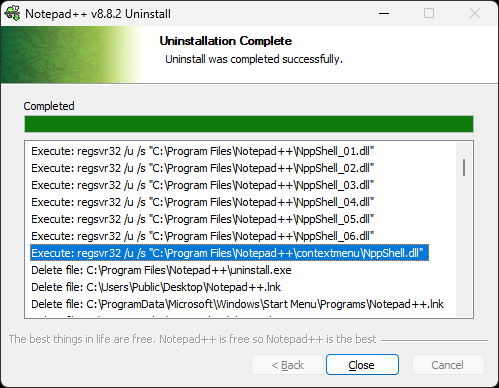

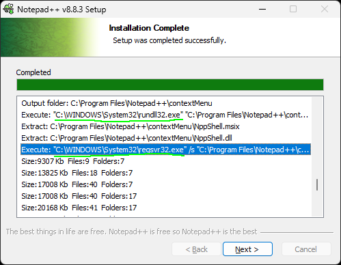

            xomx @mpheath
            @mpheath said in Installation Bug?:
            I can confirm:
            • v8.8.2 ok (but vulnerable to the reported regsvr32/rundll32 hijacking CVE):
            • v8.8.3 regression:
            If you can, please create a GitHub regression issue for it and link there the culprit.
            OTOH, the v8.8.3 installer is ok (and not sensitive to that hijacking by using fullpaths):
            mpheathM 1 Reply Last reply Reply Quote 2
