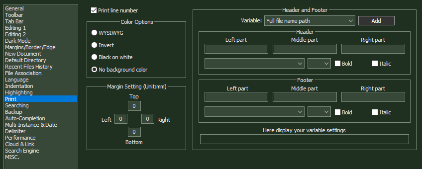

      My print settings are these:
      Alt text: Print Line Number is checkmarked but isn’t working, No background color, 0 margin, no header, no footer.
      Black and white was causing same issue a few days ago so I switched to no bg color and it happens with this too. The chance of this happening if I try to print multiple times in quick succession is very high. (e.g., tab1, print, tab2, print, tab3, print- freeze). I’m not sure if this is a Windows 10 22H2 problem or possibly a notepad++ problem. or a problem with the classic print dialog being used. or a problem with the way xerox interacts with the dialog interacts with notepad++

        Obviously it will require more testing to determine the real issue. What I did note was that you said the “print line number” didn’t work.

          1. PDF print works, but line numbers were missing. FIXED: It’s because I had disabled Line #s in Margins/Border/Edge. Personally, those should be separate and not have this interaction., maybe I’ll try making a change request over the weekend.
