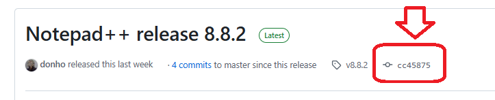

      1. Go to https://github.com/notepad-plus-plus/notepad-plus-plus/releases/latest
      2. where it has the little -o- icon and 7-9 hex digits, click on that hex number

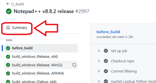

      5. Click on the Summary button

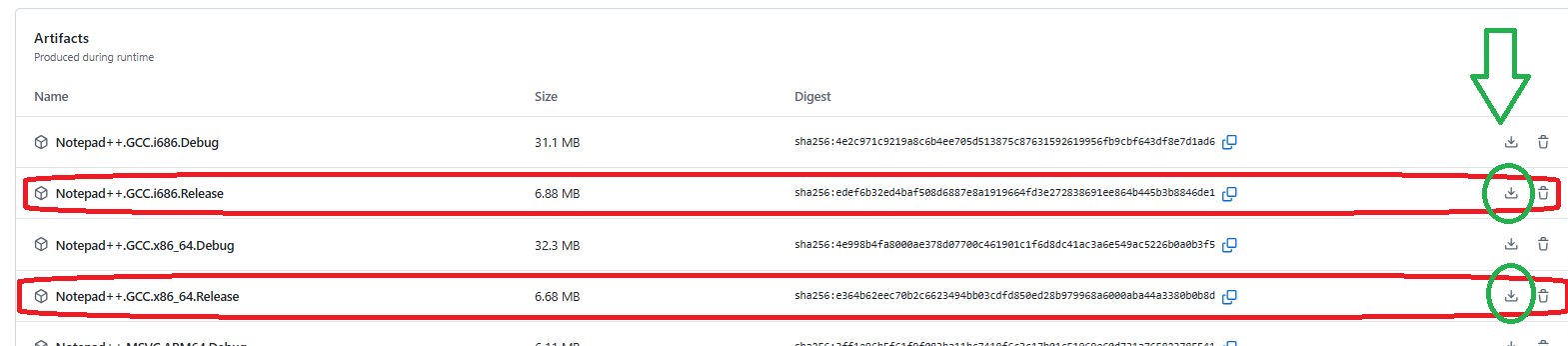

      6. Scroll down to the Artifacts at the bottom of that Summary page, and pick the …GCC.i686.Release if you want 32-bit Notepad++, or …GCC.x86_64.Release if you want the 64-bit Notepad++
        • That downloaded artifact will be a zipfile containing a single (unsigned) notepad++.exe
      Once you have unzipped the artifact, you can continue with step 4 in the Main Steps
