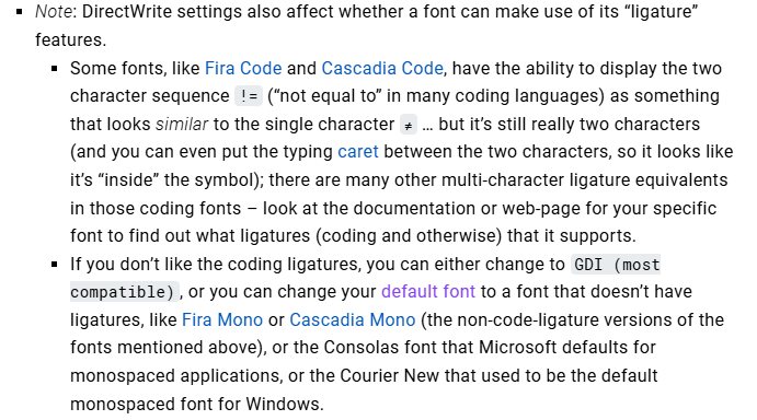

            I have updated the User Manual’s description of the DirectWrite settings to show:
            With this phrasing, if someone goes to the preferences page in the User Manual and uses their browser’s Find in Page feature (Ctrl+F) to search for != , they should be able to find this information, even if they don’t know to look for the term ligature. (No, I cannot add every possible coding ligature; != seems to be the most common one people choose to ask about, so that’s the one I put in the manual to make it easy to Find in Page.)
